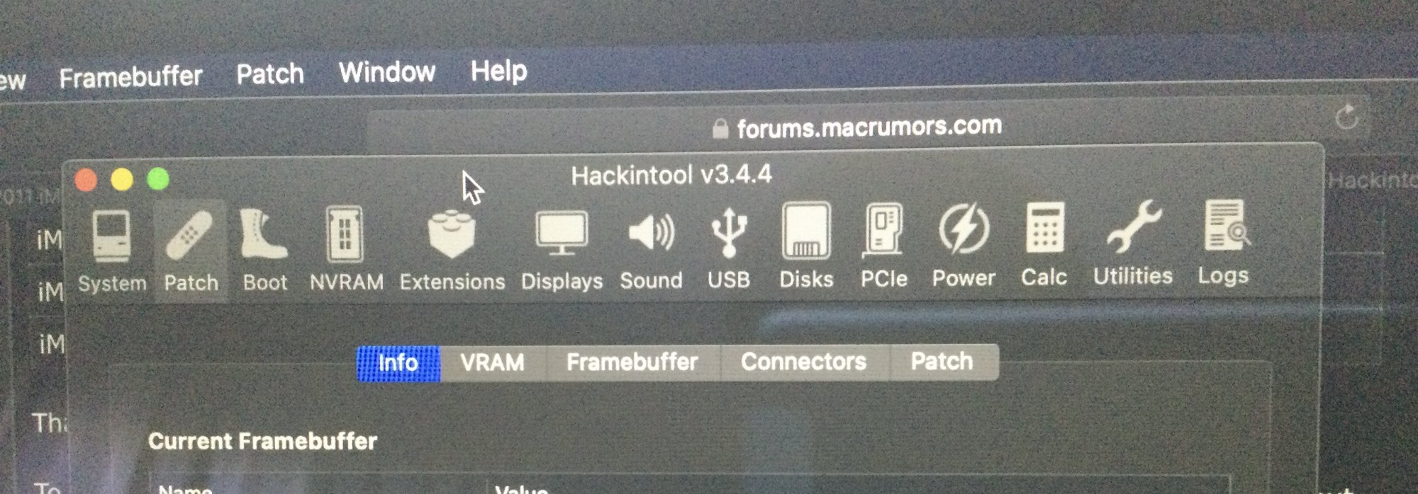

Thank you again for helping, but I dont know how to use hackintool. Can you tell me where I drop the AGC file on?
