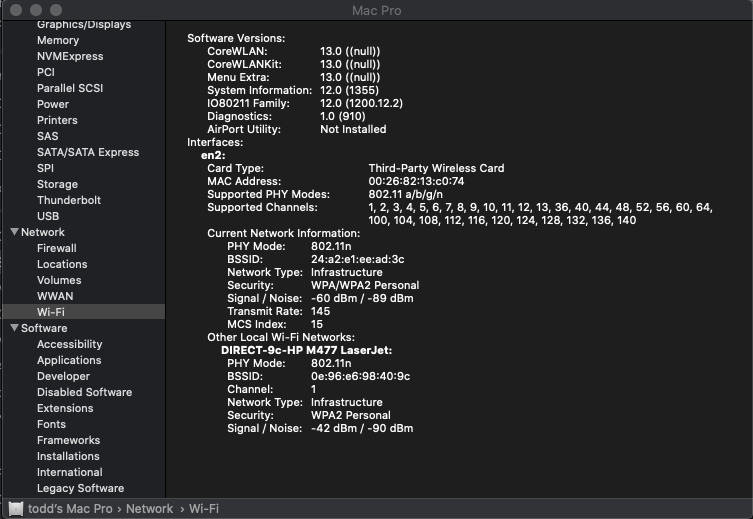

I finally got around to installing an iMac BCM94360CD wifi card on a Mini PCI-E Adapter for BCM94360CD/BCM94331CD Upgrade to Version 3.0 adapter card. This permutation finally worked on my MacPro 3,1. Testing on Catalina, I found that using the stock Catalina IO80211Family.kext and
corecapture.kext didn't allow the wifi card to be recognized. Dropping down to the Mojave versions of both work in a fashion but when you option clicked on the wifi menu bar icon, the TX Rate could be seen to be really unstable and jump around a lot. Dropping back IO80211FamilyV2.kext to the Mojave version eliminated that problem and seems to work quite well. So for folks on BCM94360CD cards, using the Mojave copies of IO80211Family.kext, IO80211FamilyV2.kext and corecapture.kext might be the best option.
That's odd because my patch uses the IO80211Family and core capture are from Mojave. It leaves the FamilyV2 alone since it didn't load for me. It sounds like V2 from Mojave is loading for you. That is interesting. I can add V2 in to help other users.
My Broadcom WiFi card is from some no name Chineses manufacture and it is just listed as a Third-Party Wireless Card in System report. The card was picked out from one that Dosdude1 recommended on his site. It's a pretty cheap card. Cost like $20 dollars a year ago.
CoreWLAN: 13.0 ((null))
CoreWLANKit: 13.0 ((null))
Menu Extra: 13.0 ((null))
System Information: 12.0 (1355)
IO80211 Family: 12.0 (1200.12.2)
Diagnostics: 1.0 (910)
Can you list this information out? It will help me make sure the V2 family is being used and what version.
My Broadcom WiFi card is from some no name Chineses manufacture and it is just listed as a Third-Party Wireless Card in System report. I don't remember number of the card I picked out. It just works. The card was picked out from one that Dosdude1 recommended on his site. It's a pretty cheap card. Cost like $20 dollars a year ago.
I also see...
Software Versions:
Actually, looking at the extensions section in system profiler, I don't see V2 loaded under either Catalina or Mojave. Perhaps I am seeing some weirdness in how the kernel cache gets rebuilt. Normally, I patch before the first reboot after a clean install. I am starting to wonder if copying the kext beyond the first reboot does the same exact thing.
