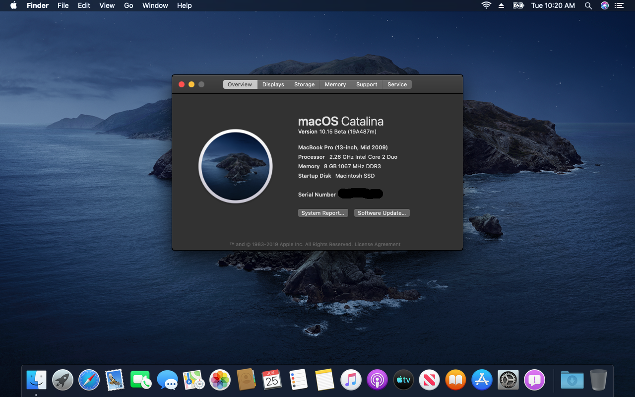

I wish to thank all the great people here who have made this possible. Mac Pro 3,1 running 19A487l with original (non-APFS) firmware, non-EFI metal graphics card.
Hi! It is really a great accomplishment that Mac Pro 3,1 can get up and running with Catalina ! I have the same machine with a Quadro k5000 I recently acquired and I was thinking of making the jump from Sierra 10.12.6 to Catalina when it gets released in September. Just a few questions, Did you do a clean install of Catalina ? Also, Did you use APFS when you formated your SSD (I have the impression that on this machine we need a patch to allow APFS native booting on SSD ?) Did you change any settings in the Dosdude Catalina patcher ? Thanks in advanced !
My MacBookPro 4,1 (17-inch, Early 2008) is currently running macOS Mojave Version 10.14.3 thanks to Dosdude and forum colleagues.
Processor = 2.5 GHz Intel Core 2 Duo
Memory = 6 GB 667 MHz DDR2 SDRAM
Graphics NVIDIA GeForce 8600M GT 512 MB
I am willing to test install macOS Catalina Version 10.15 on this MBP 4,1 when installers/files are available.

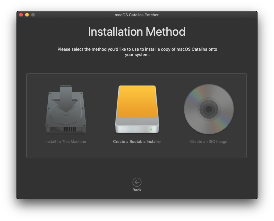

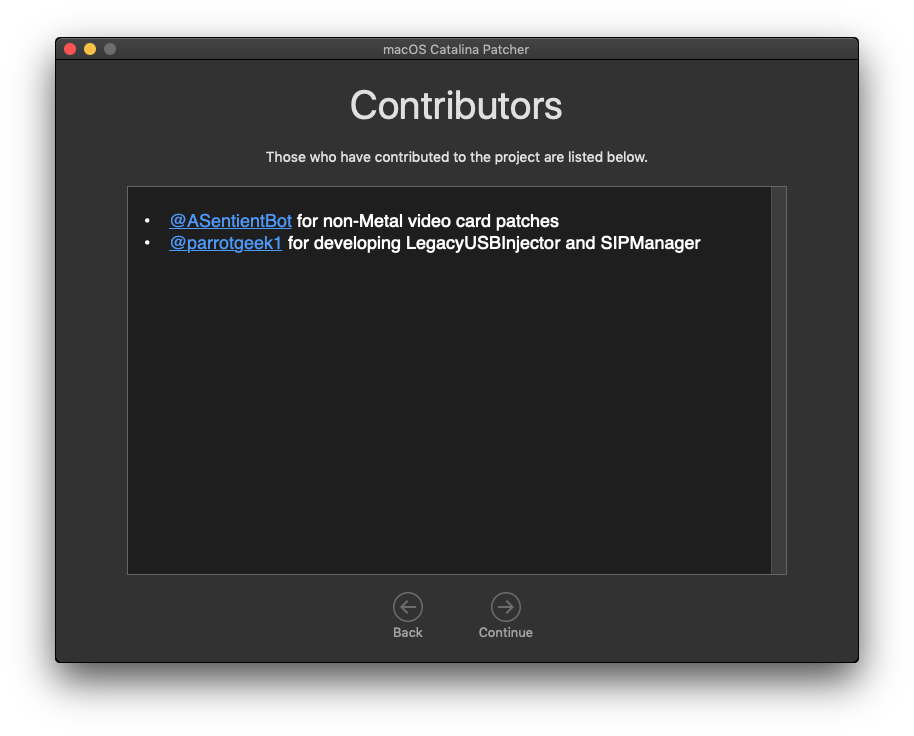

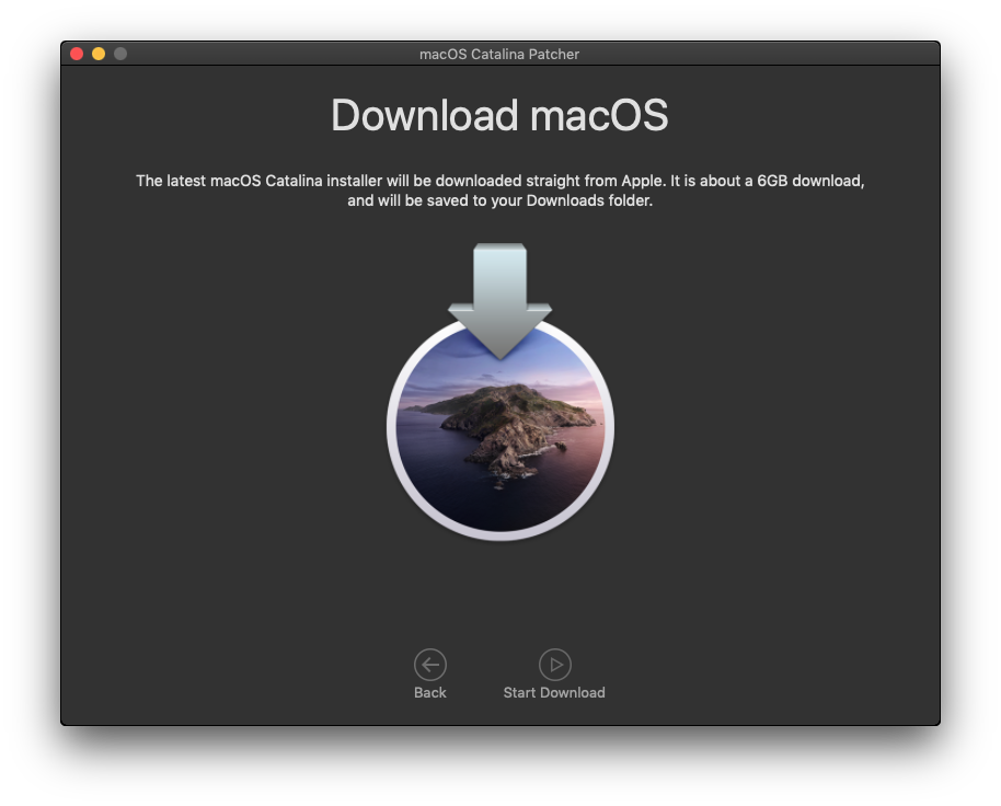

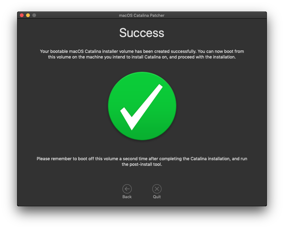

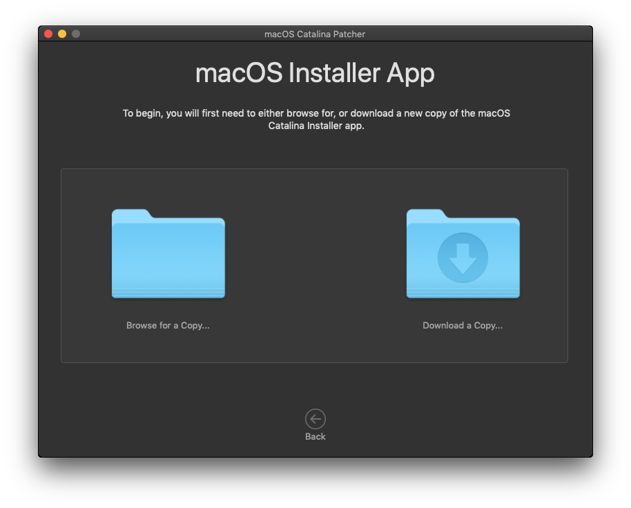

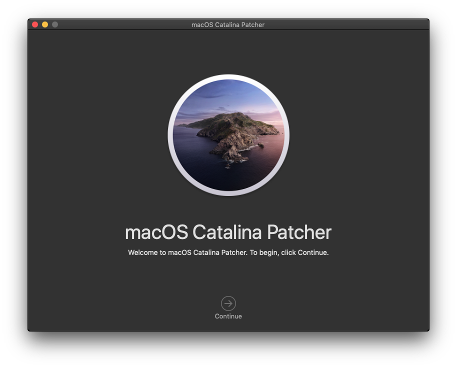

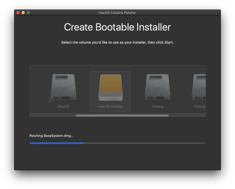

At last, the first preliminary release of the FULL macOS Catalina Patcher is now done! This is definitely one of the best macOS patcher implementations I've ever created, and it works amazingly well! I have not yet implemented all the features I intend to, but they will be coming very soon. As of now, the tool works perfectly with its new user interface, and will allow you to install a fully-patched copy of macOS Catalina on your unsupported system!
The tool is able to run under as old as Mac OS X version 10.6 (Snow Leopard), ensuring maximum compatibility (doesn't use any of that awful Swift rubbish).
As of now, the same prequisites apply as with macOS Catalina PartialPatcher:
  • The system must support booting from APFS volumes natively, or have had native APFS support added to its BootROM via my APFS ROM Patcher tool
  • -no_compat_check must be set in NVRAM to install, as detailed on the webpage.
Let me know how you all like it, and of course, please report any bugs!
View attachment 844891 View attachment 844892 View attachment 844893 View attachment 844894 View attachment 844895 View attachment 844896 View attachment 844897
The Patcher tool Crashes on Mojave and also on my supported mac on 10.15. Should i send u the crash reports?
See my message on page 76. Same problem; crashed on unsupported and supported iMacs. Try another USB stick.
Success on MacBookPro5,5 🙂
