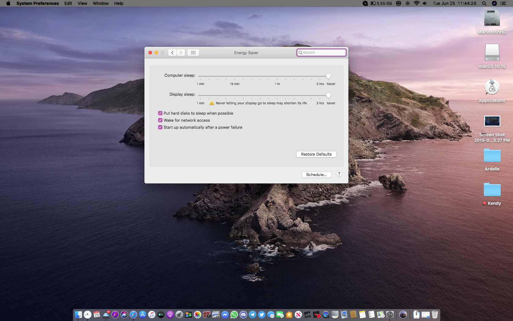

or you can adjust your energy saver options like this

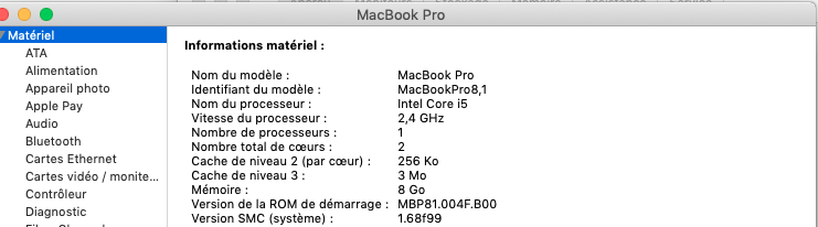

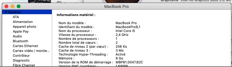

Hi my friend, please download FirmwareUpdate.pkg

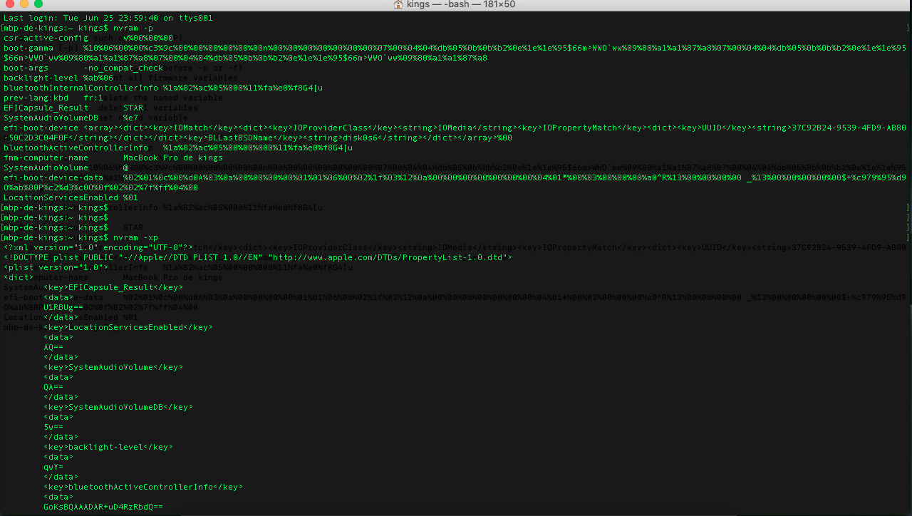

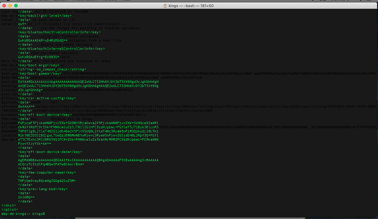

the time I install ctaline by usb on my mac rin afiche or subject i cherhe on tirminale or subject of nvram boot-args = "- no_compat_check" and active or no?
jail to you my page of tirminale and tell me and all good or no
and thank you
the time I download Firmware Update.pkg
and installs on my Mac look see pic 1
the version that and on my mac and on the pic 2

Reactions: TimothyR734
