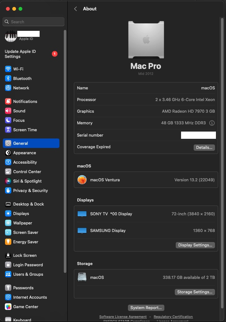

Long story short, I upgraded my MacBookPro 9,1 and MacPro 5,1 and all went well on MBP, but cMP 5,1 I can only SSH, no video, so stupid me read on _________ that AMD RX 6600 worked natively with OCLP and Ventiura so I rushed and ordered 2 for my MacPro 4,1 and MacPro 5,1 machines. I then found a post that you have to update VBIOS? Or will OCLP take care of all of that? If not, what are good recommendations to get it working? Also, I've read that there are BT issues? What about USB per-se? I upgraded my Wi-Fi with a BCM94360CD which upgraded my stock BT to the built-in on the Wi-Fi adapter. Will my BCM94360CD's BT work out of the box? Any other issues I should be aware of?
Thanks!
Any ideas? With RX580 it upgraded but no video. I could still SSH but didn't have any xcode tools after upgrade so I couldn't try the post-install/patches. I am going to try to install 0.6.0 TUI to see if I can run it after upgrade.
I ordered the AMD RX 6600 (non-XT) to try next.
WiFi / BT upgraded to BCM94360CD - I did see where BT is being wired to another USB controller?

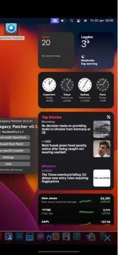

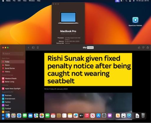

May have missed this but for some people on the mid 2014 the news widget works? Yet completely stalls on my other one I know it was a bug in the non - functional list. Confused why one has no problems with it all.

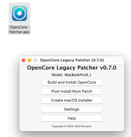

As i read, and asking me in private about some way to become beta tester.
Try to check this out, in béta test 0.7.0, surely a rumor in macrumors or probably a joke.
