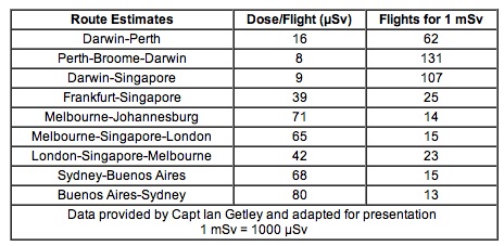

"One sievert per hour near the reactor"? This is less than the cosmic radiation you are exposed to while flying in an airplane.
I think you have your units confused.... (1 mSv = 0,001 Sv)

You are correct, sir.
However, I'd really like to see a source on this, because it completely contradicts everything I've read on the disaster. In fact, all the sources I've seen indicates that the big radiation spike this morning was measured in microsieverts. Example source: http://www.nytimes.com/cwire/2011/0...levels-spike-forcing-temporary-ret-87245.html

not really: the nyt article says the spike was >1000mS/hours which is 1 Sievert/hour.
No, the NYT article says 1000 micro sieverts, not mSv (which would be millisieverts).
1000 microsieverts is a millisievert.
A sievert is 1,000,000 microsieverts.
yep, you're right. i had misread it as milli but the correction wasn't quick enough apparently :)
Hehe, my bad, you ninja'd me with the edit while I was making my post.
But yeah, from everything I've seen excepting this article, the largest spike was around 1 millisieverts/hour within the complex (about five times what you get from an airplane flight, which is 200 microsieverts or 0.2 millisieverts), which, a mile away, should be negligible.
This article's suddenly claiming 1 Sievert seems out of the left field to me; I haven't heard of anything like that.

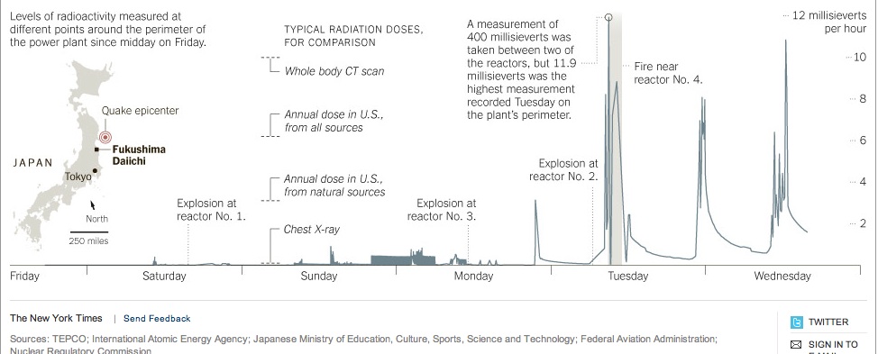

This graph seems to have been compiled from fairly reliable data/sources:
interesting, thanks.
so it seems that outside the situation is ok, but spikes in the order of 1 Sieverts are probably likely within the reactor buildings.
