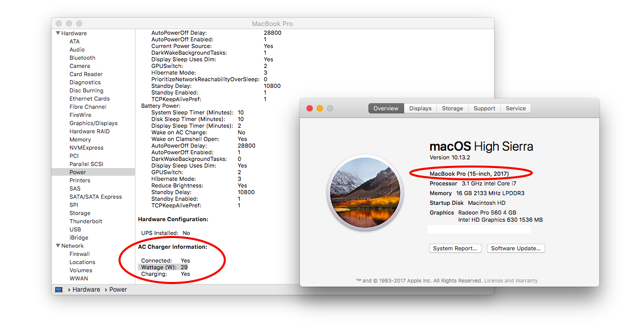

I noticed something odd ...
So when the 15" MBP-T is connected to the USB-C of the H277HU the system information tool of MAC (Mac Symbol - About this Mac -> System Report -> Power) shows a louse 29W .. which is a bit odd ..
I mean 29W is even less than what the 13" MBP would need, no wonder it would take 10hrs to charge.
So back to square 1 - either indeed, you can't run your 15" MBP .. I kinda doubt that - or maybe the cable does not allow full power? but then again, at least it should have thrown 60W as the cable manufacturer says
