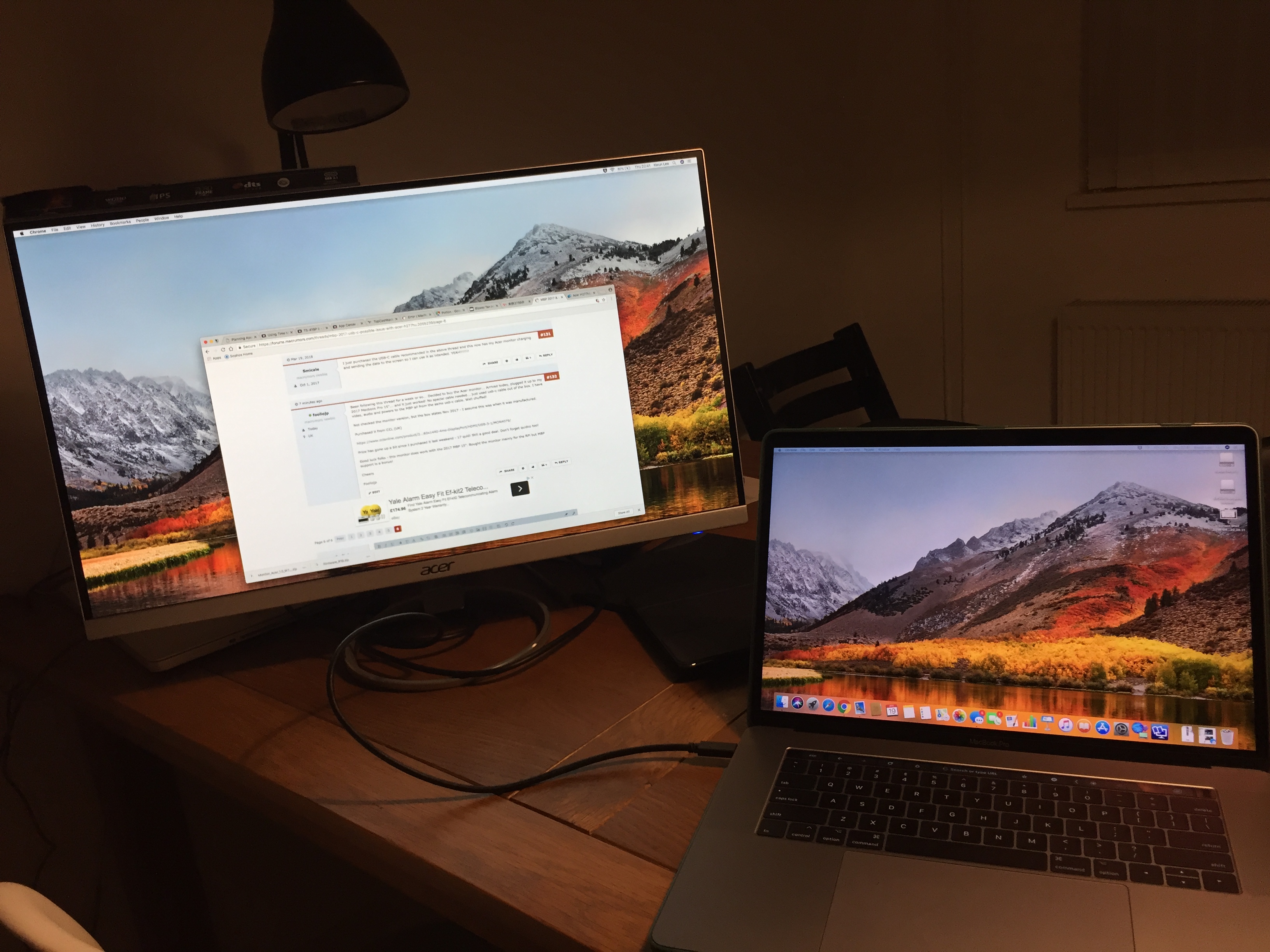

Been following this thread for a week or so... Decided to buy the Acer monitor... Arrived today, plugged it up to my 2017 Macbook Pro 15"... and it just worked! No special cable needed... just used usb-c cable out of the box. I have video, audio and powers to the MBP all from the same usb-c cable. Well chuffed!
Not checked the monitor version, but the box states Nov 2017 - I assume this was when it was manufactured.
Purchased it from CCL (UK)
https://www.cclonline.com/product/2...60x1440-4ms-DisplayPort/HDMI/USB-3-1/MON4079/
Price has gone up a bit since I purchased it last weekend - 17 quid! Still a good deal. Don't forget quidco too!
Good luck folks - this monitor does work with the 2017 MBP 15". Bought the monitor mainly for the RPi but MBP support is a bonus!

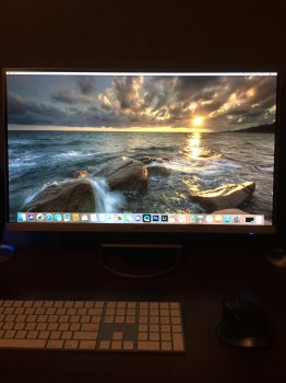

I got mine just before Christmas I’m using a 2017 mbp and I had to update the drivers for the monitor to work, after doin this have had no problems, it’s a beautiful monitor
[doublepost=1528249516][/doublepost]This is my monitor, working perfectly the colors are beautiful and has a very clear panel, through one cable you get charging, audio, data transfer and picture, it works great
