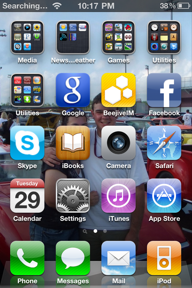

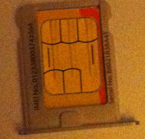

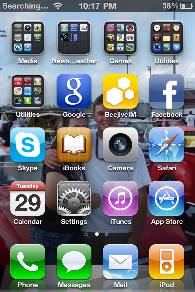

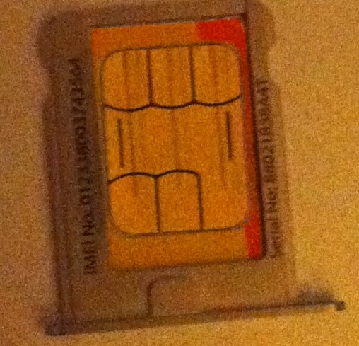

Ugh... things certainly took a turn for the worse for me.
Careful putting that SIM back in. I don't know what is going on but now I just get this:
Guess I'm going to visit the AT&T store tomorrow.

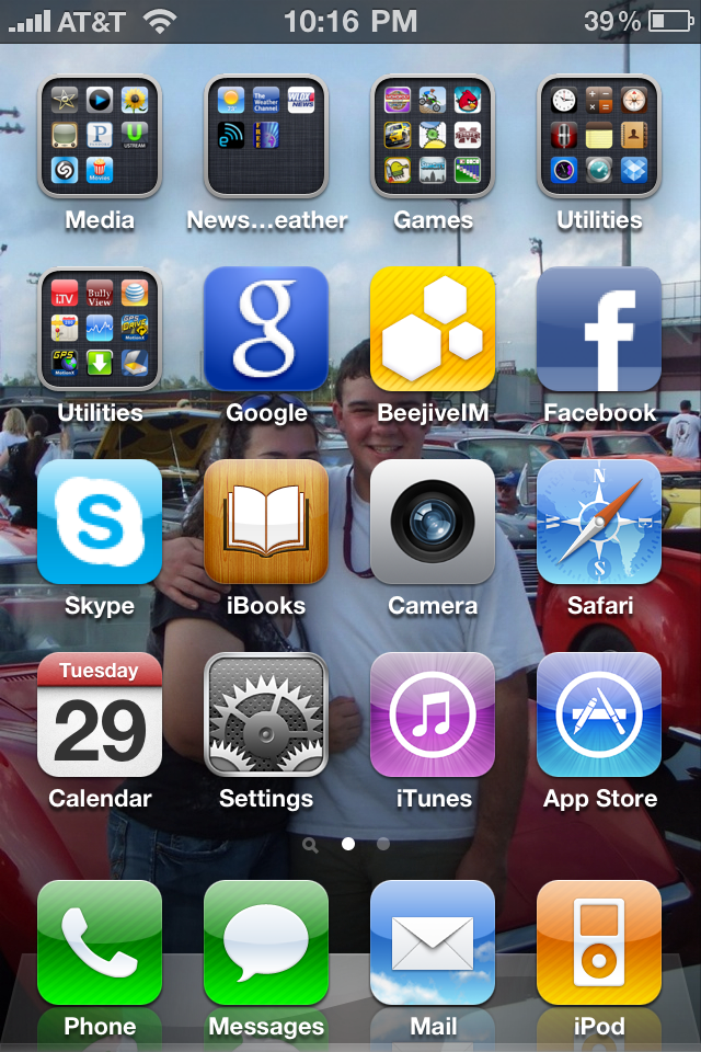

Before deathgrip:
After deathgrip:
