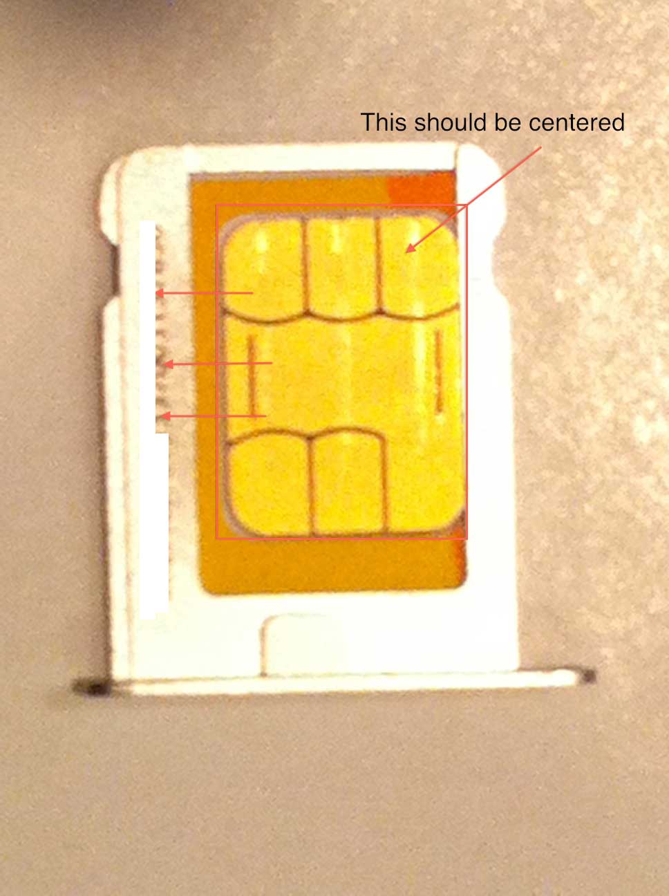

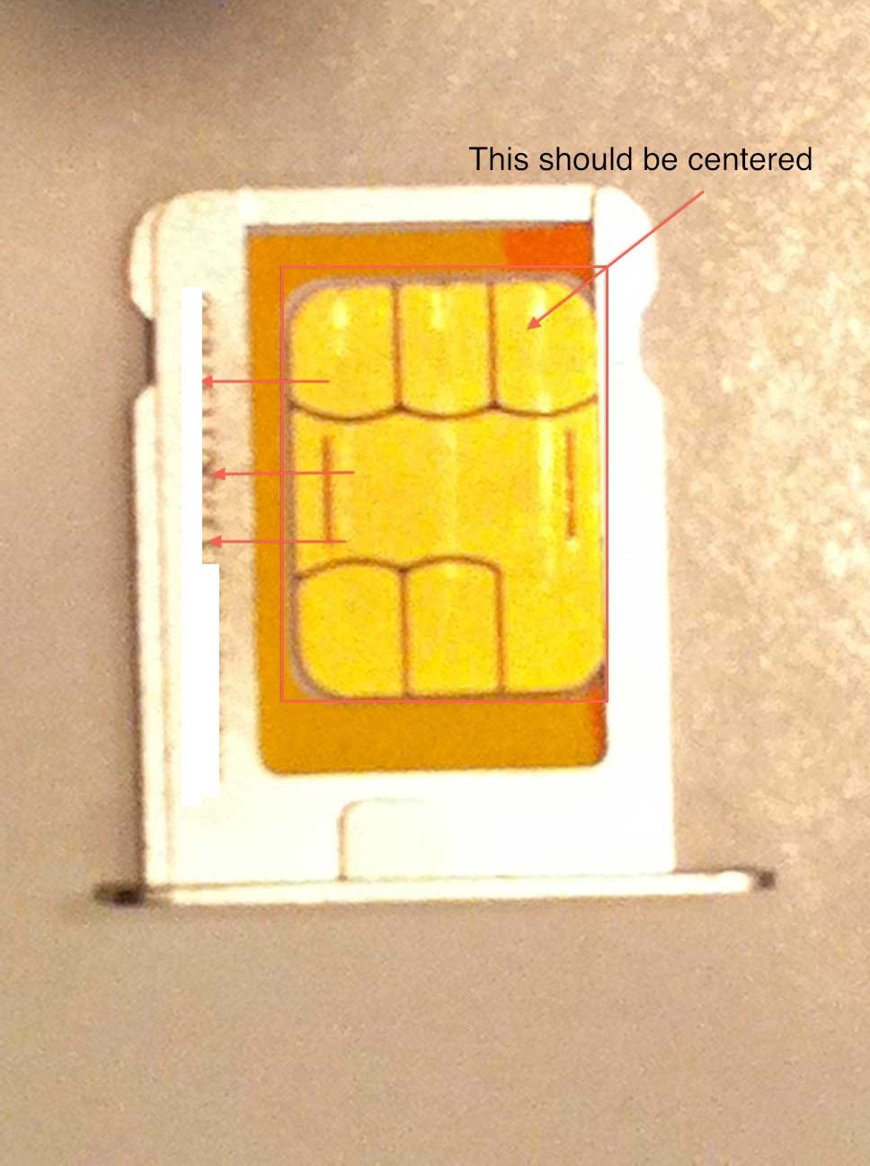

The real question is, why is A) either the microSIM spec set with the contacts not right in the center or B) AT&T QC letting through so many wrongly-cut SIMs?
Is it possible that the sim card needs to be centered properly or am I wrong ?
If you look at your microSIM card in that image, you can plainly see the "scrape marks" or contact wear of exactly where that card is being touched by the gold plated tension-loaded contact points inside the microSIM socket.
It's very visible in your picture, the tiny stripes of a sort where it appears to be a brighter shade of yellowish-gold. Based on that, yours seems to be getting contact that's right where it should be, almost dead center of each contact pad on the microSIM itself.

Try to make sure no part of the gold circuit on the SIM is touching the tray. Optimally, we think it should be centered in the middle and not touching the edges. However, the way the sims are cut make this difficult to accomplish.
That's not my card. I just took arn's pic and annotated it 🙂
The wear marks seem like the contacts are centered on the corresponding sections. If there's an issue with contact on the SIM, I would think electrical tape would solve that. I placed a piece right up to were the wear mark was on the "short" end and trimmed the excess so it would fit back in. Booted, reset network setting, etc. It didn't help.
I tried pushing the sim to both sides and inserting and no change. Not even sure adjusting the SIM stays put once its back in there.
