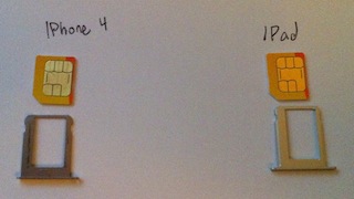

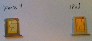

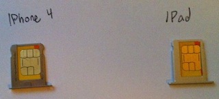

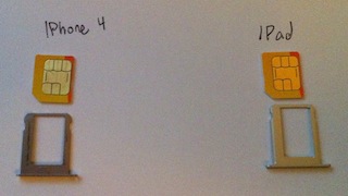

Does anyone have a sim from a 3G iPad to compare how it is positioned when laying in the iPhone's sim tray? I am curious if it touches also.
Images of the iPhone 4 and iPad SIMs together.
The iPad is not steel. The iPhone 4 is.
Its hard to compare apples to oranges.
Either way for all we know the female inner workings of the sim slots on the iPhone 4 has the problem.
All i know is the sim is the area id be looking at heavily if i was Apple right now.
