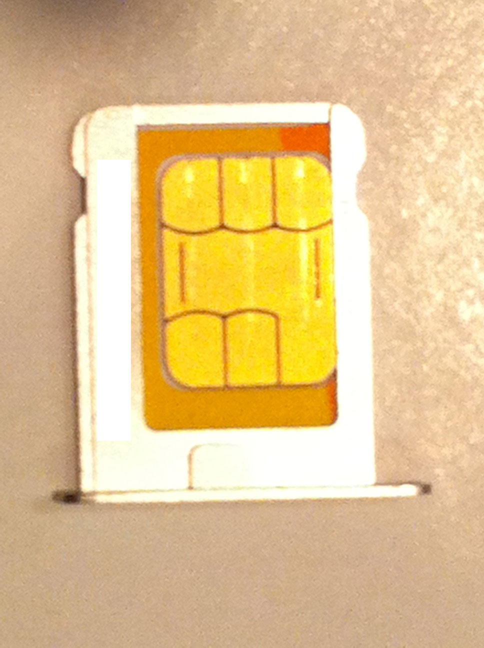

Here's what I've got so far, bear with me using rmwhite's picture as the demo (thanks for the pic):
What seems to be the evidence so far that this could potentially (that's my disclaimer word, you know) is the issue and the fix is that it seems like many people, when looking at their microSIM cards and the trays they're mounted in, have noted that in some instances the actual contacts of the microSIM itself could be coming into contact with the microSIM tray itself, which is made of metal as well, and causing a short. Here's a picture of what I mean:
The circled area, which appears as the vertical grayish-line, is the 'gap' between the side of the microSIM tray and the microSIM contacts - if there's nothing in there and the contacts are touching the microSIM tray or even so close that some electrical bridging is happening, that could be the reason why the problems are happening, and also why when some people "grip" the phone tighter they are literally closing that gap or causing it to decrease in width.

here's my sim which does appear to contact the metal frame. I did scotch tape on the affected side which didn't work. don't think I have electrical tape handy though

My Guess! If incorrectly inserted, the SIM card tray causes a short INSIDE the phone. When you touch the bottom left of the phone (i.e. the case), this links up with the antenna resulting in interference due to that shorting.
