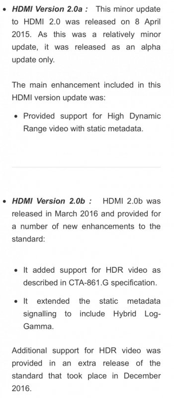

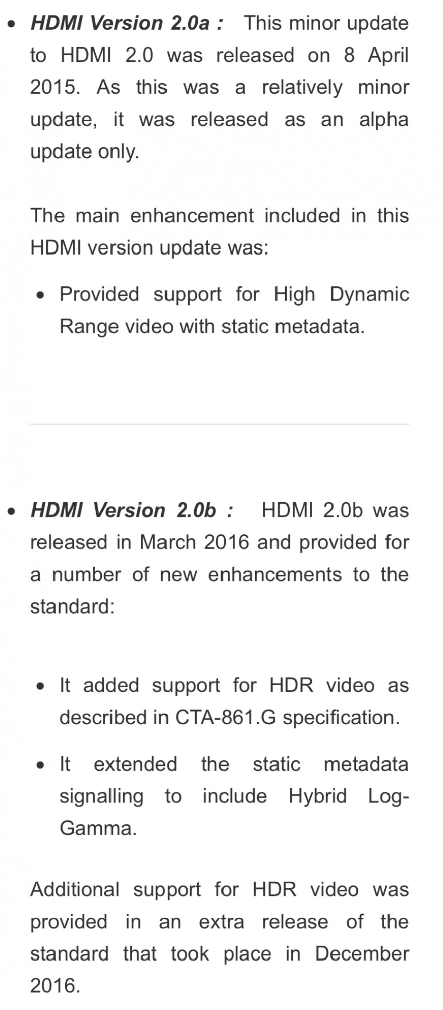

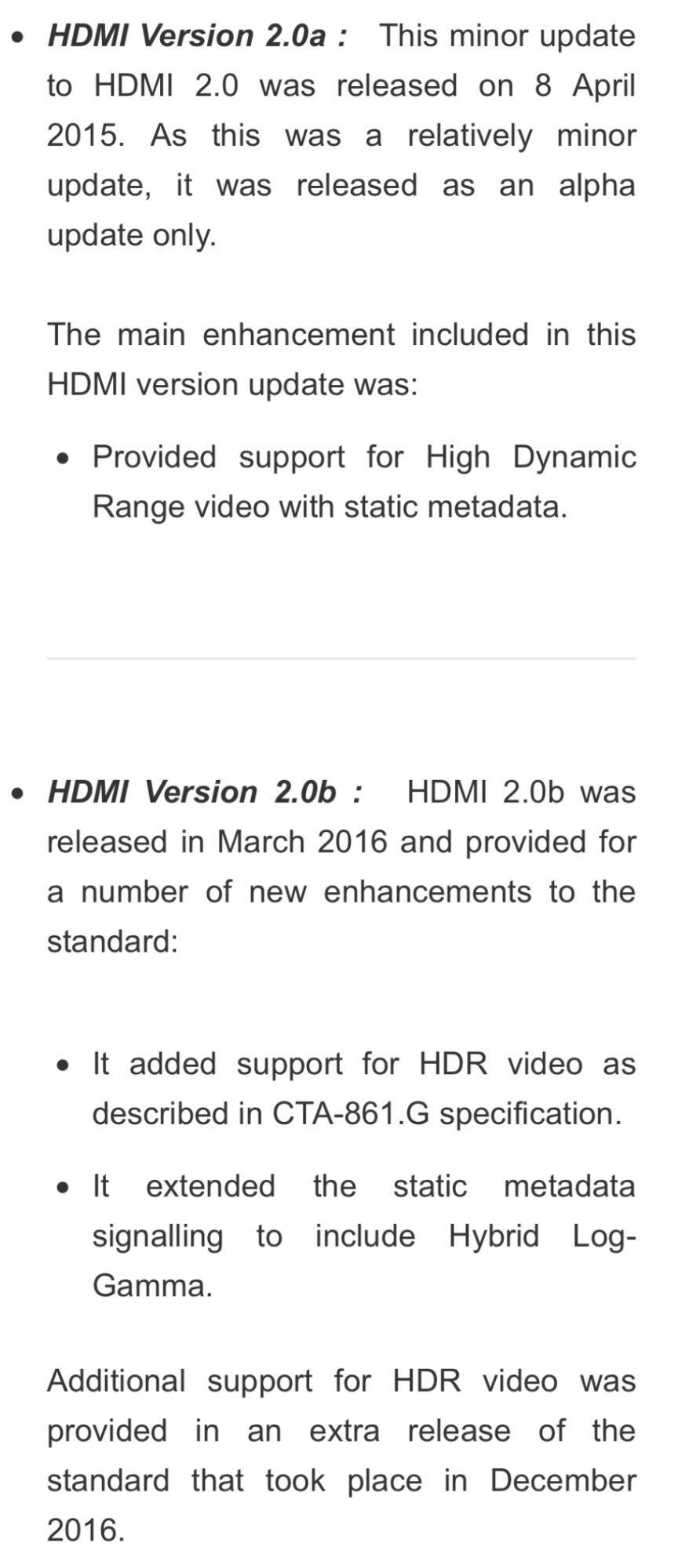

      There is likely a  DP to HDMI conversion chip that provisions the HDMI port directly.  ( absolutely zero need to roundabout through Thunderbolt complex at all. ).   Just doing DP is way simpler and far more cost effective to buy a standard HDMI 2.0b converter.   The other way would be for Apple to build their own converter on die and pump the HDMI straight out.  If on-die convert then once again  simpler and saved die space just to do HDMI 2.0b
