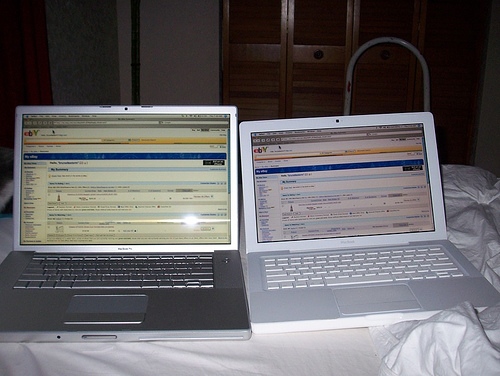

I am retracting my previous post. I can see a subtle yellow tint towards the bottom half of the screen. Hardly noticeable when viewing strait on but when viewing at an angle the entire screen has a yellow tint. This is disappointing because I went to the Apple store to specifically avoid this problem!
Running the little test on page one reveals the yellowish tint. So how long do you guys suppose I will go without my notebook? Trying to decide whether it's worth waiting a week or two while sacrificing productivity.

KingYaba, I'm sorry, but every single MBP i have ever seen (displays, friend's machine) have a very yellow cast when viewing from an angle. the screen is only designed to be viewed straight on. the issue is only when the bottom of the screen has the yellow cast when viewed straight on. It is incredibly annoying and even makes text on a white background hard to read. if you don't have that, then you don't have the issue at all.
basically, if you are reading this forum, and the bottom of the screen looks like piss, then you have the issue. however, it is normal for the screen to be slightly darker on the bottom than on top. that is also not the issue.

Then maybe this is a screen-calibration issue? I sort of feared I may be overreacting a little bit but I do have the Samsung panel, correct? It doesn't look like "piss" as a dark yellow but it exhibits a yellow hue. You have to look for it for it to be noticeable. When doing the picture test from the 1st page of the thread it is noticeable. When I was emptying the trash and moving that window from the top of the screen to the bottom I noticed a big difference in the clarity of the white color to where it changed a few shades yellow.

Say what? If that's correct why post a jpg with two pure white boxes? The floor models I looked at didn't have the problem. Are you saying it is as yellow as this: :), no way. Maybe a very diluted urine color but I would rather say it reminds me of a light nicotine stain. Another thing I saw was an almost pure white line running across the top of the screen. (Best seen on boot up.) The menu bar tends to obsure it.
My advice is to call the store and ask them about a replacement. Also tell them that you want it calibrated by someone at the store. If you can walk out with a system that looks "normal" meaning what every other manufacturers screens look like then great. I do not consider "normal" to be "slightly darker on the bottom than on top" that's bargain bin material.

I had a week 22 2.2 ghz 15" matte SR MBP with a Samsung display. I sent it off for repair (rather than replacement as everything else about it was great). At first I was told they could not see anything wrong with it, but I argued and got it repaired.
The replaced my bad (yellowing/poor gradients/bad backlighting) samsung with an LG and it looks great. The forum finally looks white again. No dead pixels either!
My only complaints: Now the lid doesn't close fully on the left side. Also The aluminum bezel at the bottom part of the visible screen seems scratched/minorly chipped at two places, which is kind of annoying and allows for a bleed through. Still, the screen is much better so I'm willing to live with these things.

Yes, in some cases it can be extremely subtle. Mine was subtle enough that nobody but me could see it, even when directly asked, until I pulled out a last-generation MBP to show them for comparison. Then they immediately saw the difference and said "yeah, it looks like the bottom got pissed on."
