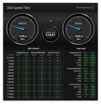

Can confirm on my 6,1, the 970 Pro runs cool enough and the coating beneath label serves as a good enough heatsink that you won't have to worry about that.
It fits better in the machine than the 960 with a heatsink did. Worthwhile upgrade in my book.
Reads are about the same, but writes are a bit better

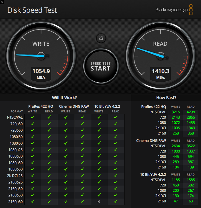

Hmm, with my Apple SSD SM0512G (this is the 512GB SSUBX Apple SSD) I am getting:
Write is faster, but read not.

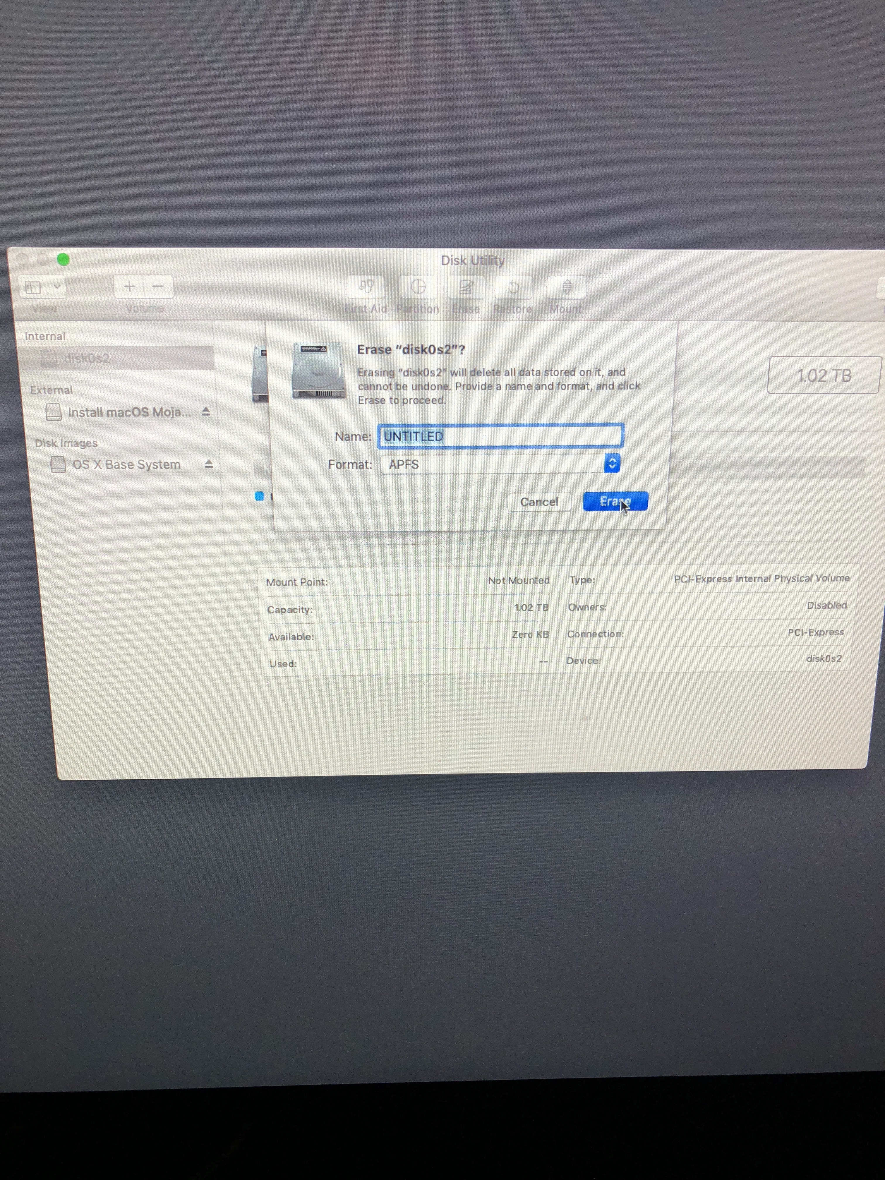

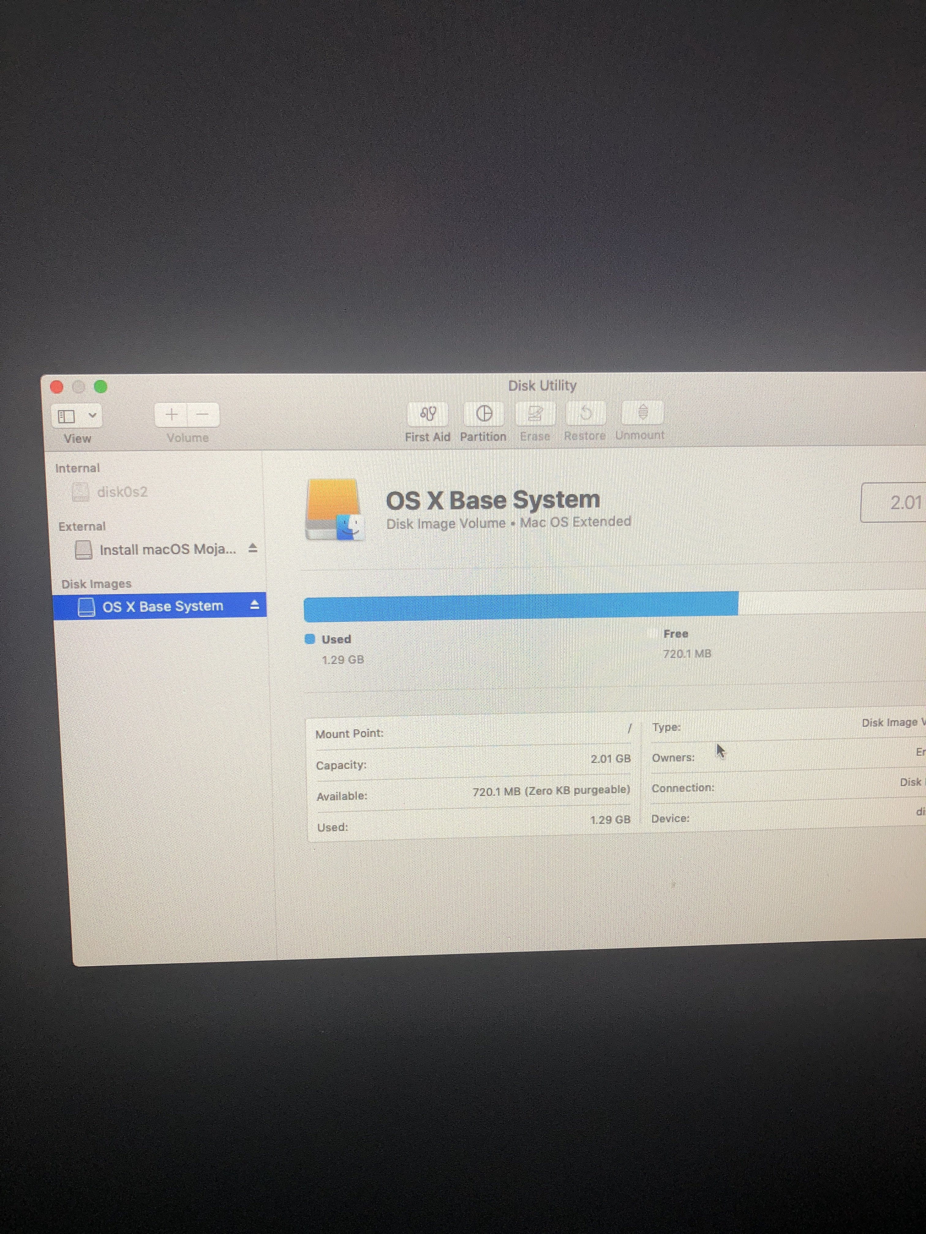

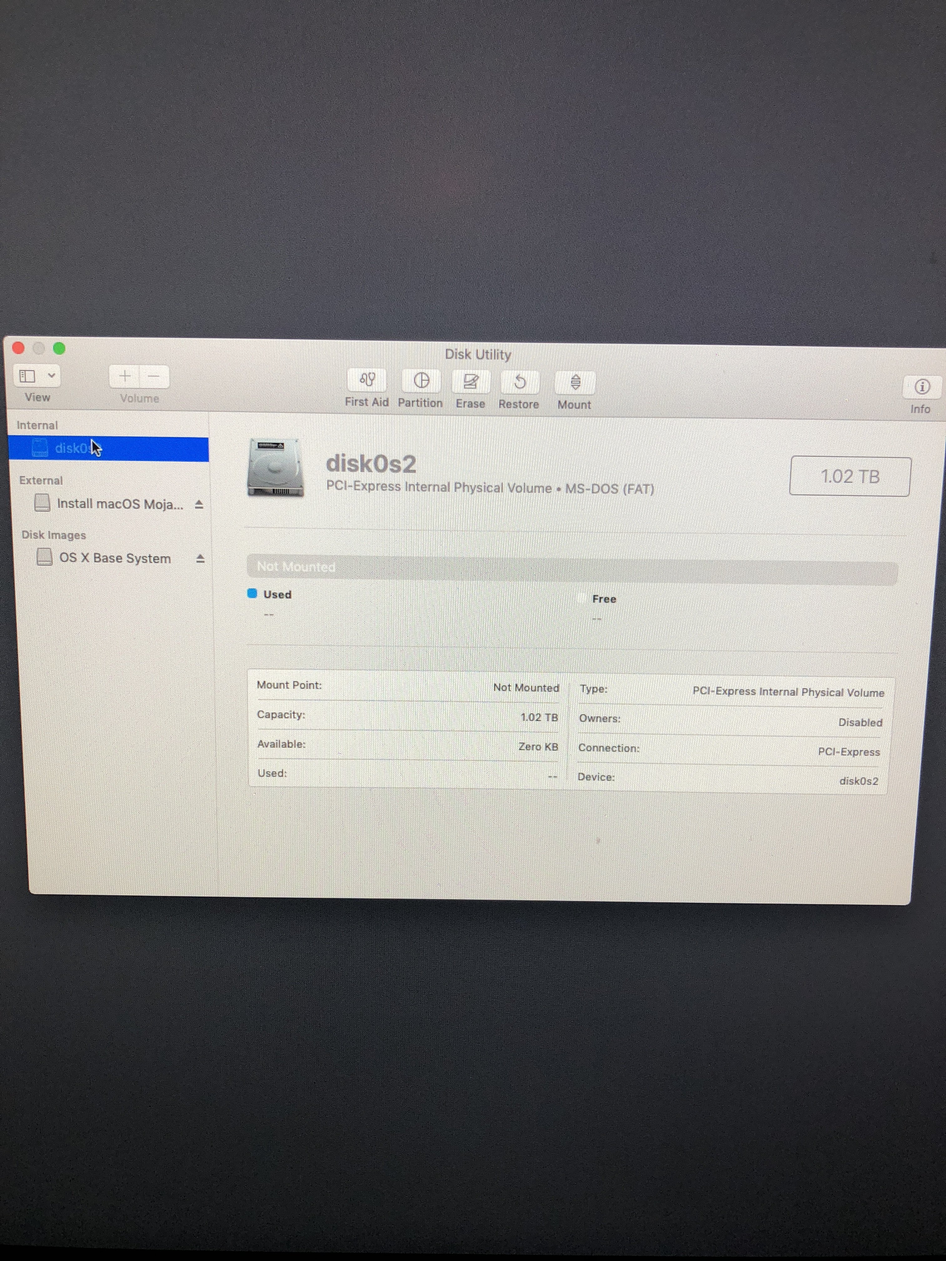

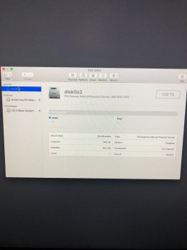

hey there, so I got the 970pro and the adapter, made the bootable drive and when I start up it won't mount, when I try to erase using AFPS, then try to start the instal it won't show up as an option. any ideas?
UPDATE:
I had the container selected not the physical drive

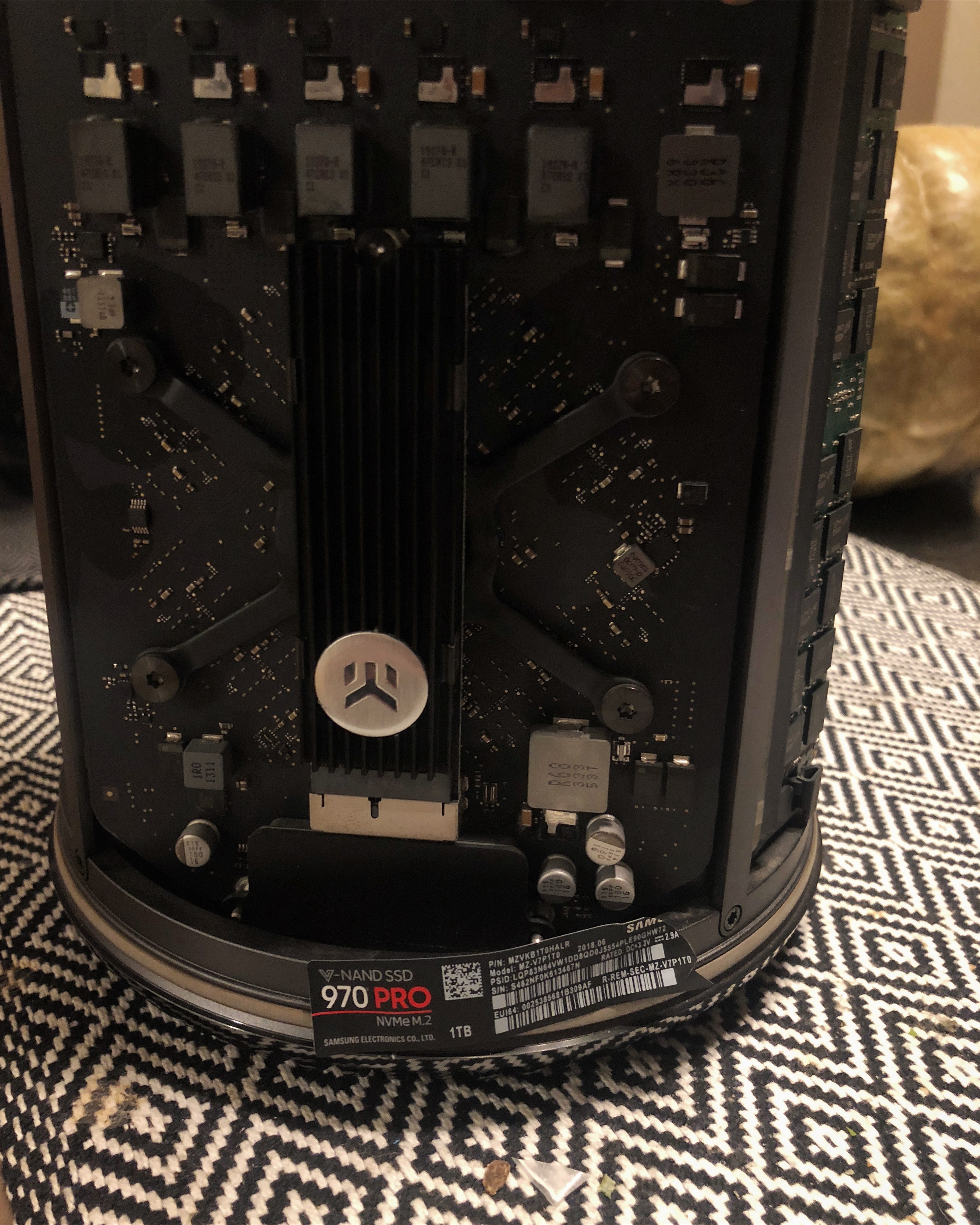

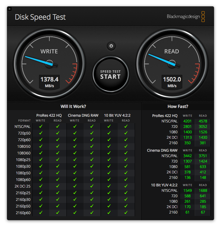

got her up and running! I put that heat sync on it just for peace of mind. thanks so much for the input from everyone! it takes a village to keep a older Mac running her best!

Is it just me or does the EBKW logo look like a sad face when installed upright? 🙂
