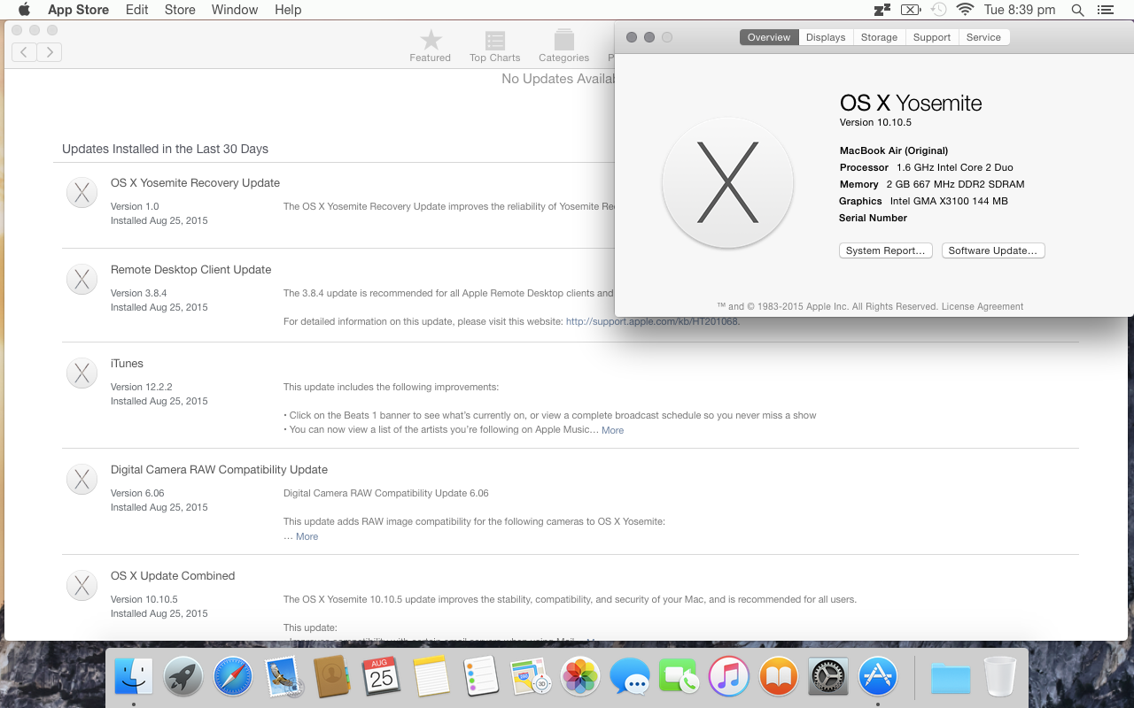

14. After reboot, all worked fine and now I have the oldest in the history of Human kind Macbook Air Original, with the latest OS X from Apple creators🙂

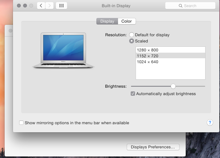

Pros: After the Update I have three different Video resolutions available. Thing I didn't had with the original install. Of course, the lowest ones are a bit blurry, but performance is much better. I'm kind of got used to it.

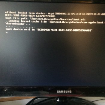

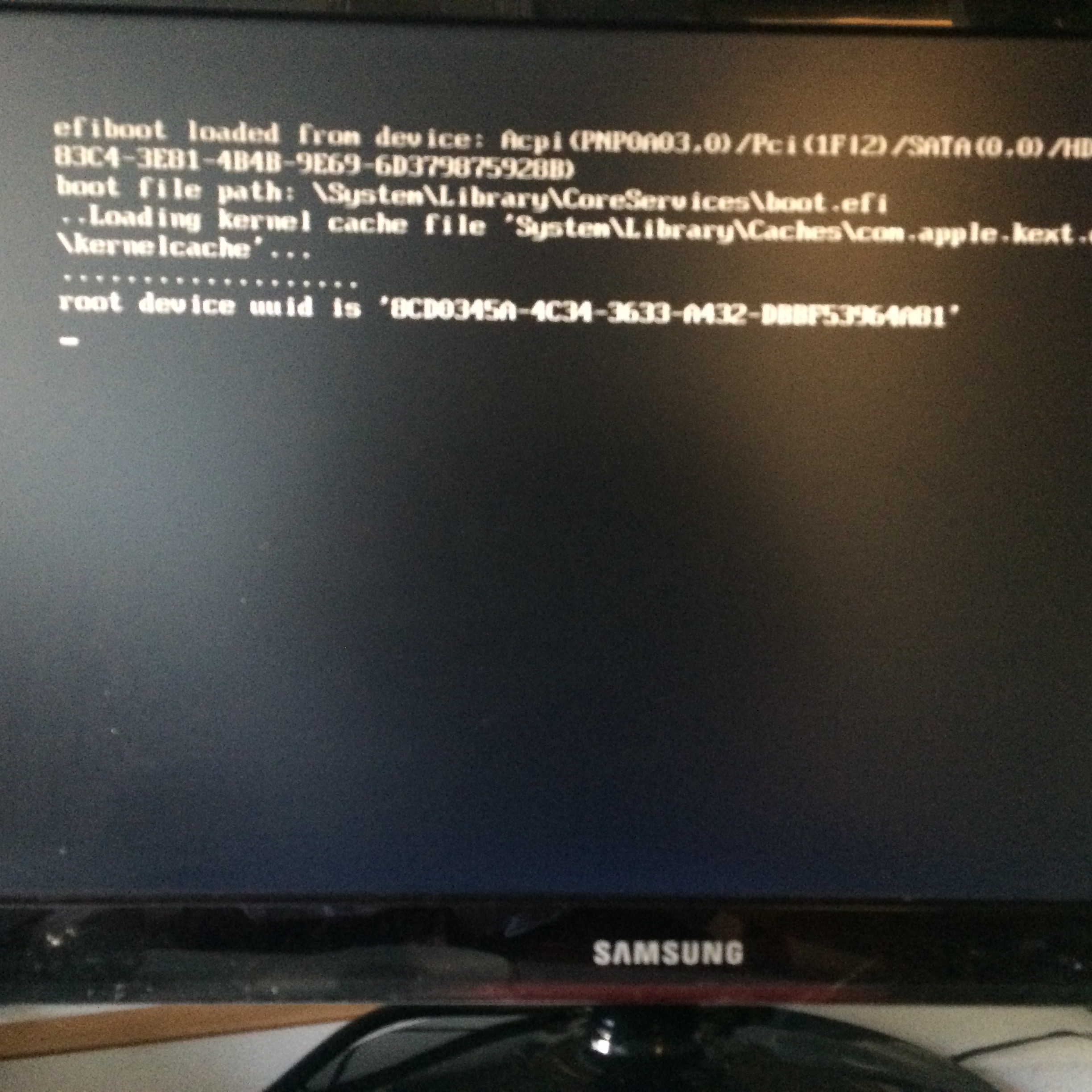

I am attempting to get Yosemite to run on my old Mac Pro 1,1. I've already upgraded the video card to an ATI Radeon HD5770 1GB Video Card and have a copy of 10.10.5 on an external firewire drive installed using the reinstall option from the recovery drive on a MacBook Pro. The MacBook Pro booted successfully from this installation. After using the Pike's boot.efi and the script installer and I get the screen below. After much fiddling around I have not gotten much further. P
Is this an issue with having installed 10.10.5 from a MacBook Pro or are there other things I need to be trying.
