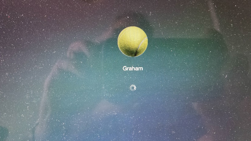

Hi folks. Hope this is the right place to post. Trying to get Yosemite up and running on an old 2.1 macbook pro A1211. I used MacPostFactor from Lion. The first boot seemed okay just had to fix the sound with the AppleHDA.kext, but on a restart I get as far as entering my password and it just sits there with a spinning cog (. I have a lot to learn when it comes to os x so bear with me, hence the reason for trying to get this old mac working. Any ideas would be welcome.
Yeah, I've had that spinning cursor at login too with iMac 5,1 and 6,1. What I did was various combos of pressing Esc, option, apple, control keys and/or clicking the mouse button or moving mouse wheel... eventually I got to the desktop... You just have to play with these key and mouse combos... if you can get to desktop, then change your Login preferences to "automatically login" instead of requiring password.
