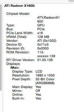

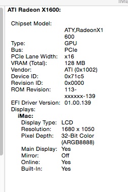

post a screenshot of Graphics/Displays from System Report in About This Mac
Here you go... fyi, I already had 128MB VRAM showing before this change...

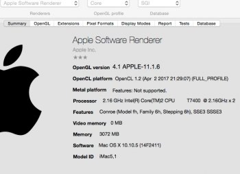

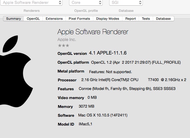

hmm, now try to open launchpad and see if it is fast at opening
Well, Launchpad does open up within 1-2 seconds, no screen redraw... but still not sure if it was this fast before today's change as well.. is there something more definitive to test this OpenGL feature??
it should show something about AMD Radeon
so it didn't work
