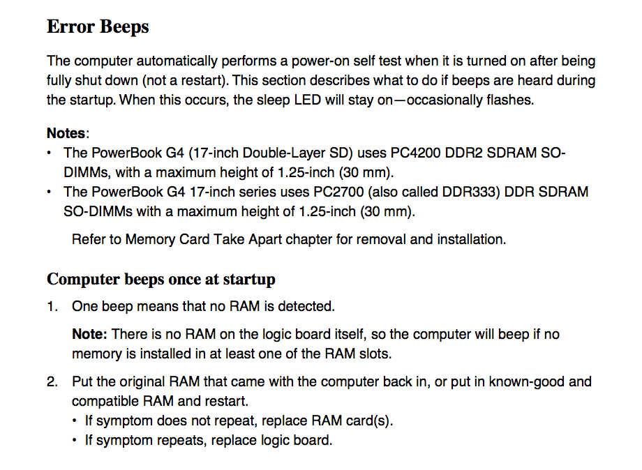

Here's an excerpt from the Service Manual for the PowerBook G4 DLSD series
( http://www.tim.id.au/laptops/apple/powerbook/pbg4_17_dl_167_15_133ghz.pdf )
It sounds like it could also be RAM failure. This might be resolved by simply re-seating the SO-DIMMs. Try taking the RAM out and give the connectors on the modules a clean with some rubbing alcohol (IPA) on a cotton bud, or you could even just rub the connectors lightly with a pencil eraser. There may be some light build up / oxidization from long term storage.
