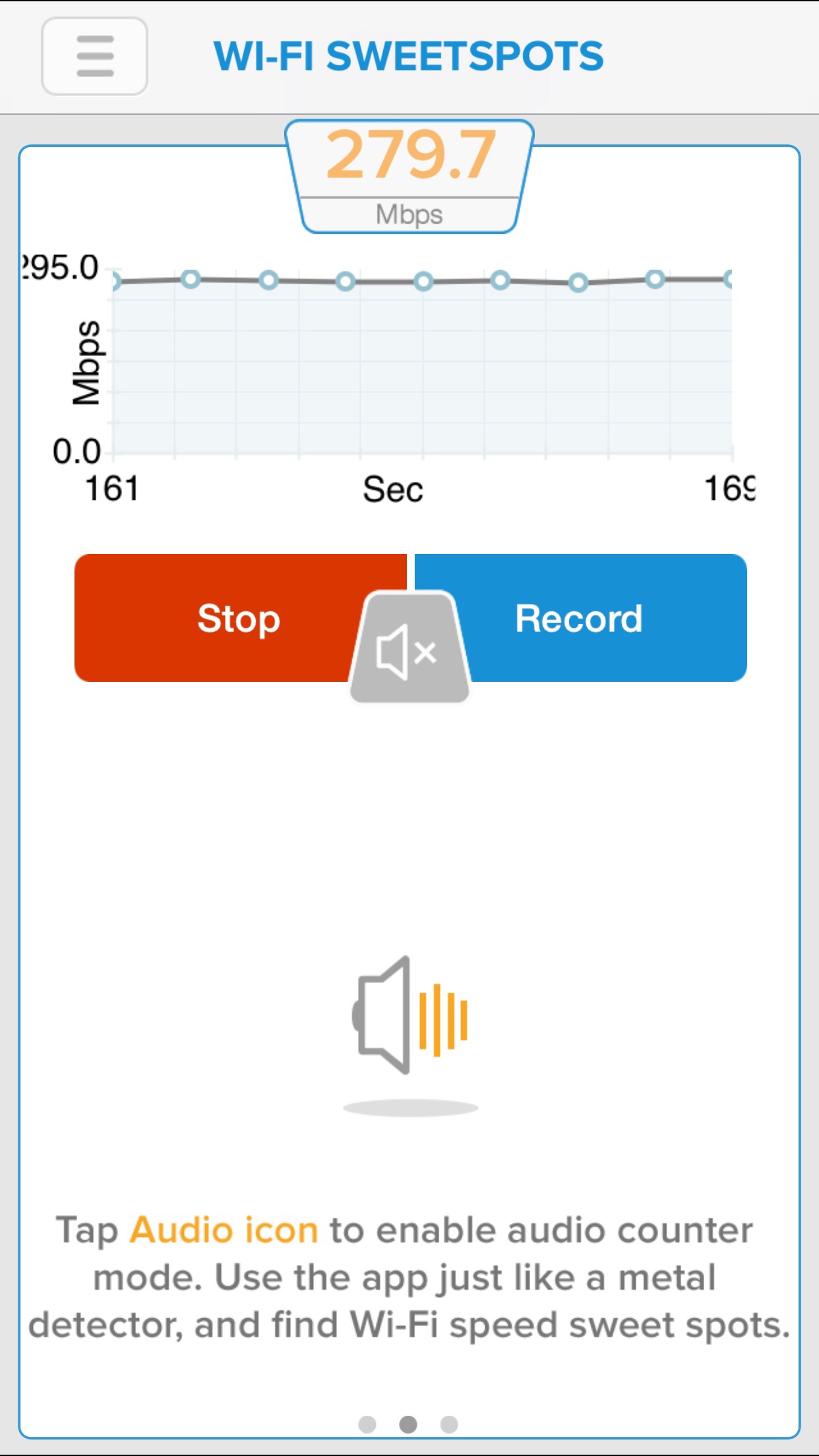

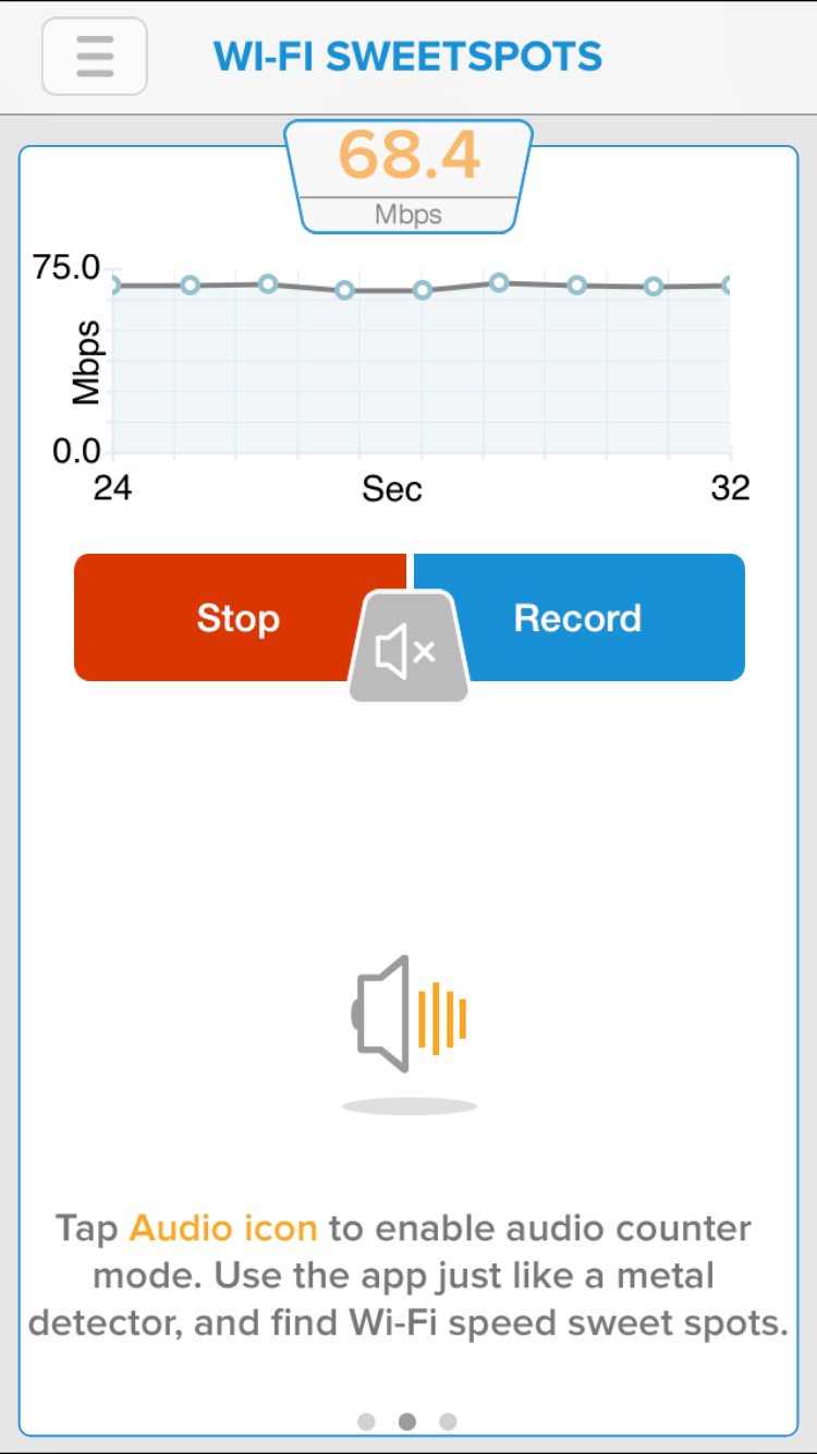

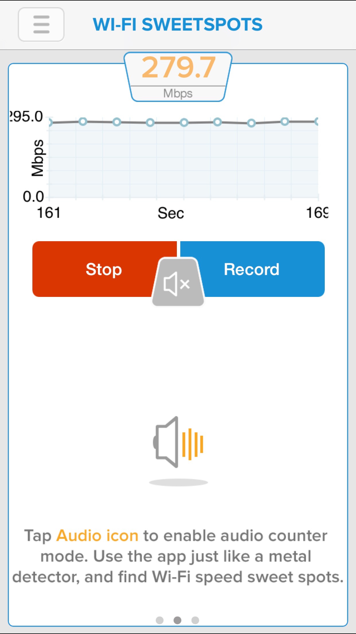

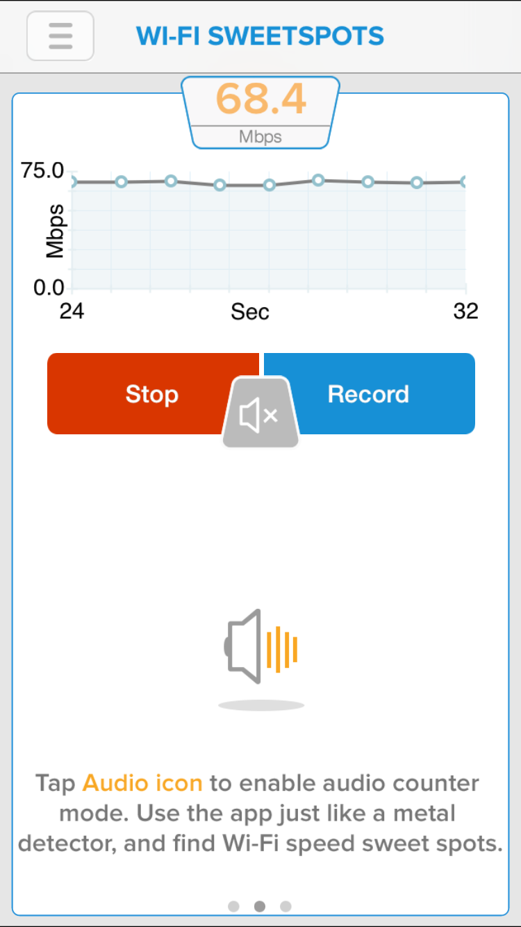

Was reading this thread while updating iPhone 6 Plus to 8.0.2 and used WiFi Sweetspots the App to check things out afterwards. Wi-Fi router is AirPort Extreme with ac band. Besides the iP6+ also have iPad Air WiFi only. Have the AirPort Extreme running both 5ghz and 2.4ghz on discreet channels to avoid neighbor's router interference.
The iPad Air 7.1.2 getting 160 mbps. I believe the Air only has n.
The iP6+ 8.0.2 getting 279 mbps. Understand it has ac band.

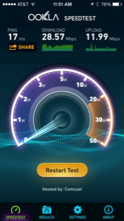

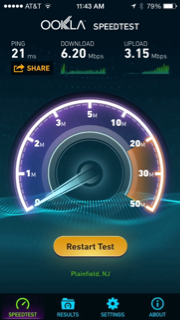

Just ran a side by side test, an iPhone 5 running iOS 7.1.2 and an iPhone 5S running a clean install of iOS 8. The difference is a serious issue...
Any website, any link, especially just browsing macrumors, or searching Amazon, and even searching the App Store (!!!) the iPhone 5 was always faster by 2-5 seconds. You have to see it yourself. Very disappointing. Disabling cellular data did absolutely nothing to improve performance.
iPad air on 7.1.2 side by side with that iPhone 5 had the same performance, did not lag like the iphone 5S.

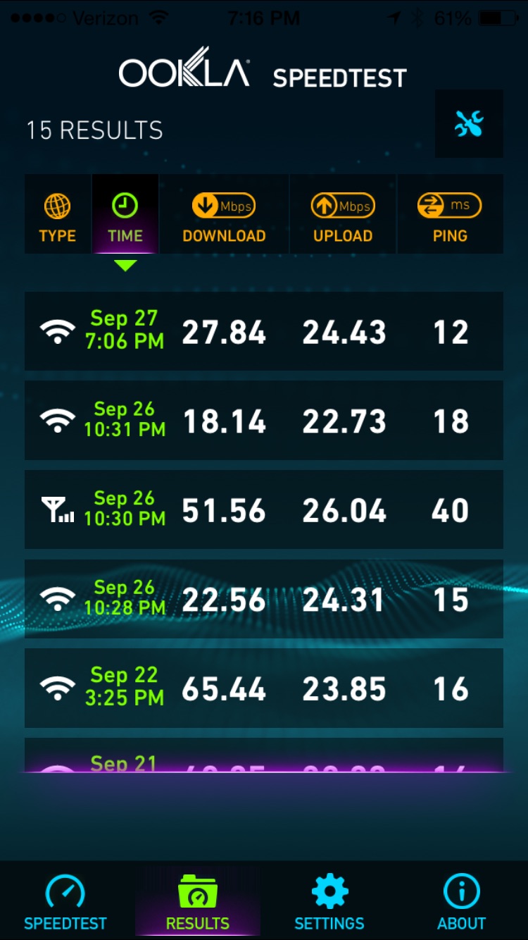

Wifi speed test

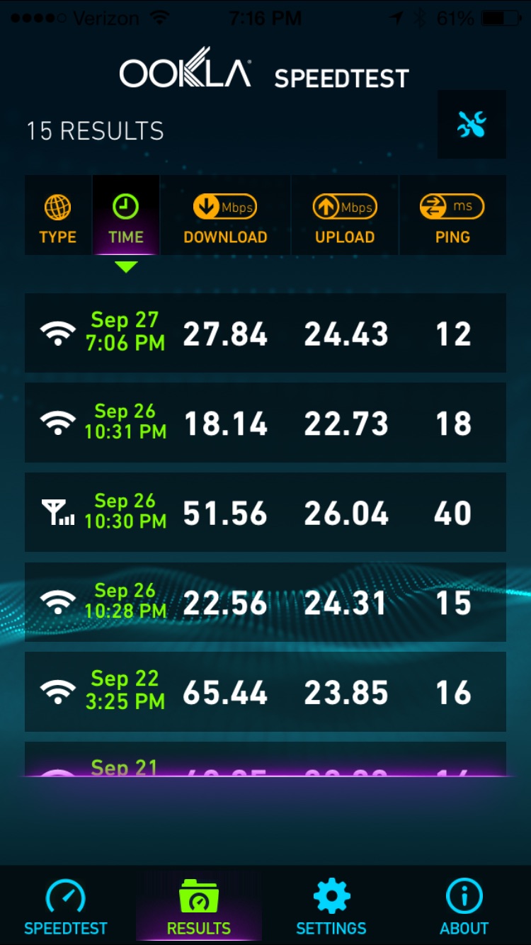

So in my retina iPad running 8.0 I'm getting 80.51 mbs download but only 20-27 on an iPhone 6 running 8.0.2. And I'm getting 43 on a 5C running 8.0.2. I was considering dropping some cash on an AirPort Extreme to take advantage of the faster wifi in the 6 but not if the software can't handle it... Especially considering in seeing peeks in the 50s on LTE
The same as 7, 8, 8.0.2... 25dl/15ul
See that's the problem - the speed tests are showing the same exact speed. But try it side by side with an iOS 7 device, the difference is tremendous. I didn't believe it either, my speeds have been unaffected by iOS 8 or 8.0.2, but I was shocked by the side by side performance.

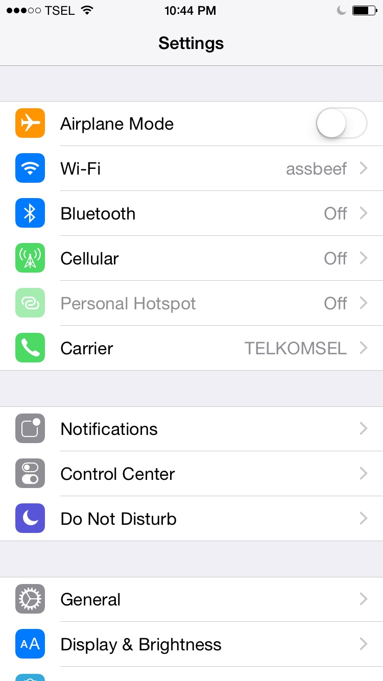

find solution for slow wifi on iPhone 5s for now
hi, i think i find a solution for fixed the slow/dropping wifi on iOS 8.0.2 on iPhone 5s..for now
i noticed when i deleted my iCloud account that upgrade to iCloud drive that I'm using on both my iPhone 5s and my iPad mini retina and created new iCloud account on my iPhone 5s without upgrade to drive and not sign in the same iCloud acc on my iPad..and restore again my iPhone 5s after erase and reset all settings>>change my DNS to 8.8.8.8>>turn off my cellular data..its been about 20 hours my wifi connections working just fine..
so think maybe it because of the iCloud, because i tried so many way before nothing worked 🙁
(sorry my english not very good? 🙂 thx..
i hope it will worked for anyone who tried it thx🙂🙂
