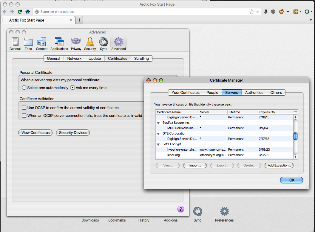

I'll have to boot that machine again to look for noscript. As for the certs, it should have popped up a browser window asking to import it and trust it. If it didn't you can manually install it. Save the cert to desktop, then in AF...
Preferences -> Advanced -> Certificates -> View Certificates
Servers -> Import and select your downloaded cert.
Close the browser and restart. It should help a little until i get around to updating the built in certs for AF.
There are many other certs you can download and import to the browser if you want as well. A quick web search should yield a few more results.

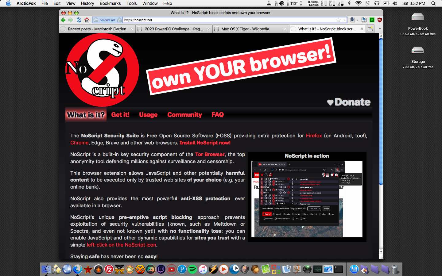

I've installed YesScript, uBlock Origin and following your instructions, I was eventually able to import the certificate (it took several attempts before the file could be selected) but the NoScript site requires that I add an exemption before I can access it.
This isn't the end of world - I'll use InterWebPPC in the meantime whilst the certificate issue is resolved. Two working browsers for PPC macOS: 2023 is shaping up to be a great year. 😀

So i decided to pull a bunch of certs from InterWebPPC and put them in an archive. You can download it and manually install them. This will update most of AF's certs and allow a pretty painless browsing experience. After installing them i didn't have to add an exception for noscript.net, it just loaded. 🙂
Sorry for the work-a-rounds, but i'm having a hard time updating NSS and the certs in the source code at the moment.
