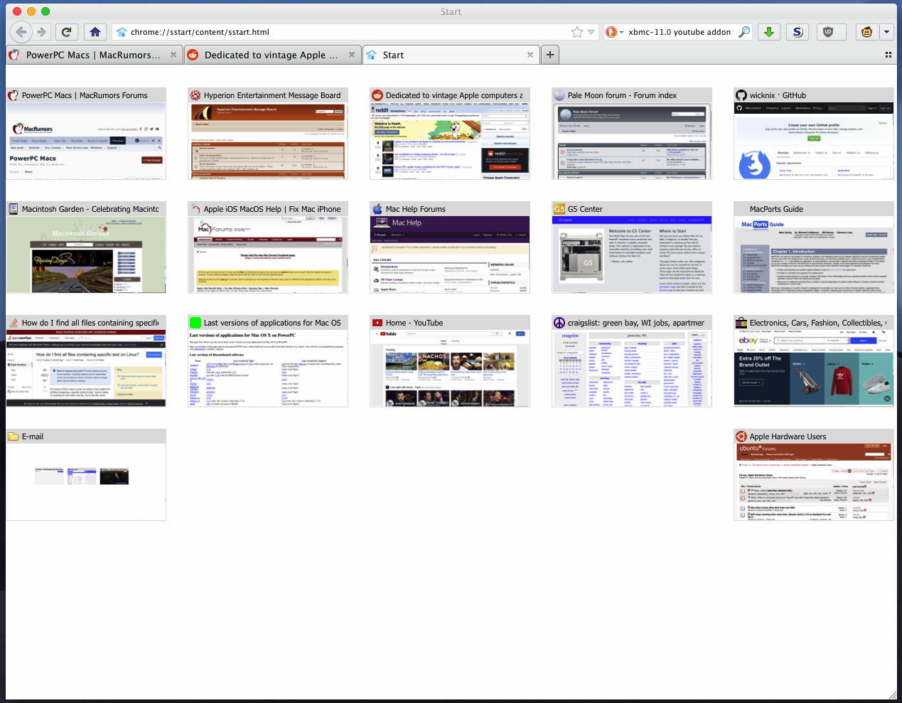

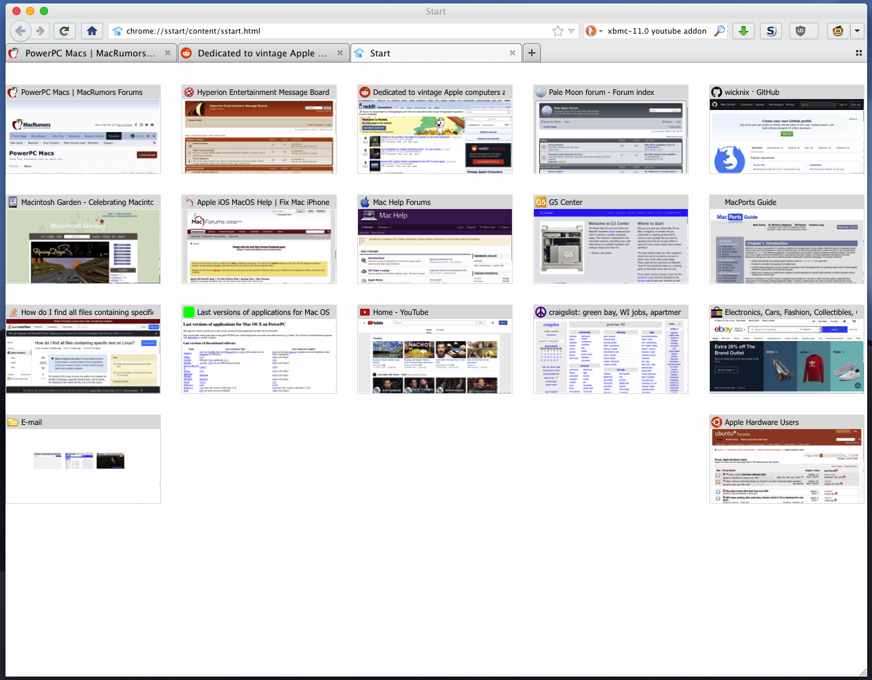

@vddrnnr Thanks for the tip about Speed Start. I've attached a copy to this post for anyone who wants to use it. Works way better than my original TFF export bookmarks trick. Just copy a url, then open a new tab, right click and paste link. Easy peasy. 😉
To install: extract the .zip, move the .xpi to ~/Library/Application Support/ArcticFox/profiles/powerpc.default/extensions/
Start AF, open a new tab, right click to show menu. Various options to mess with.
Sample bookmarks photo
Cheers
Cheers

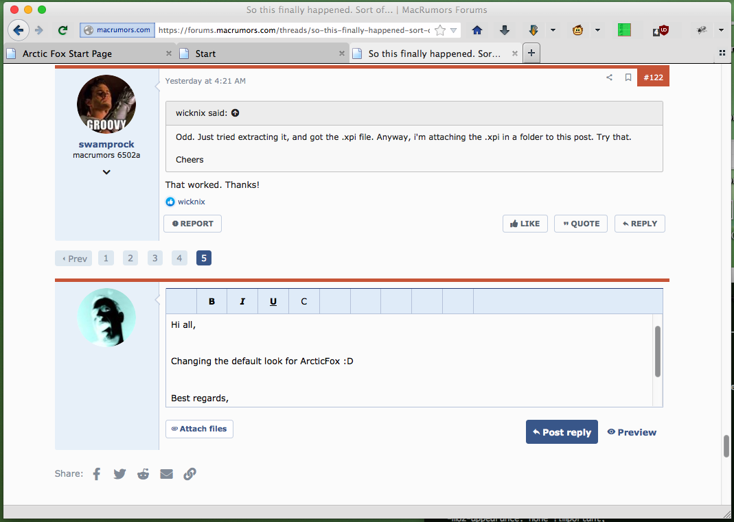

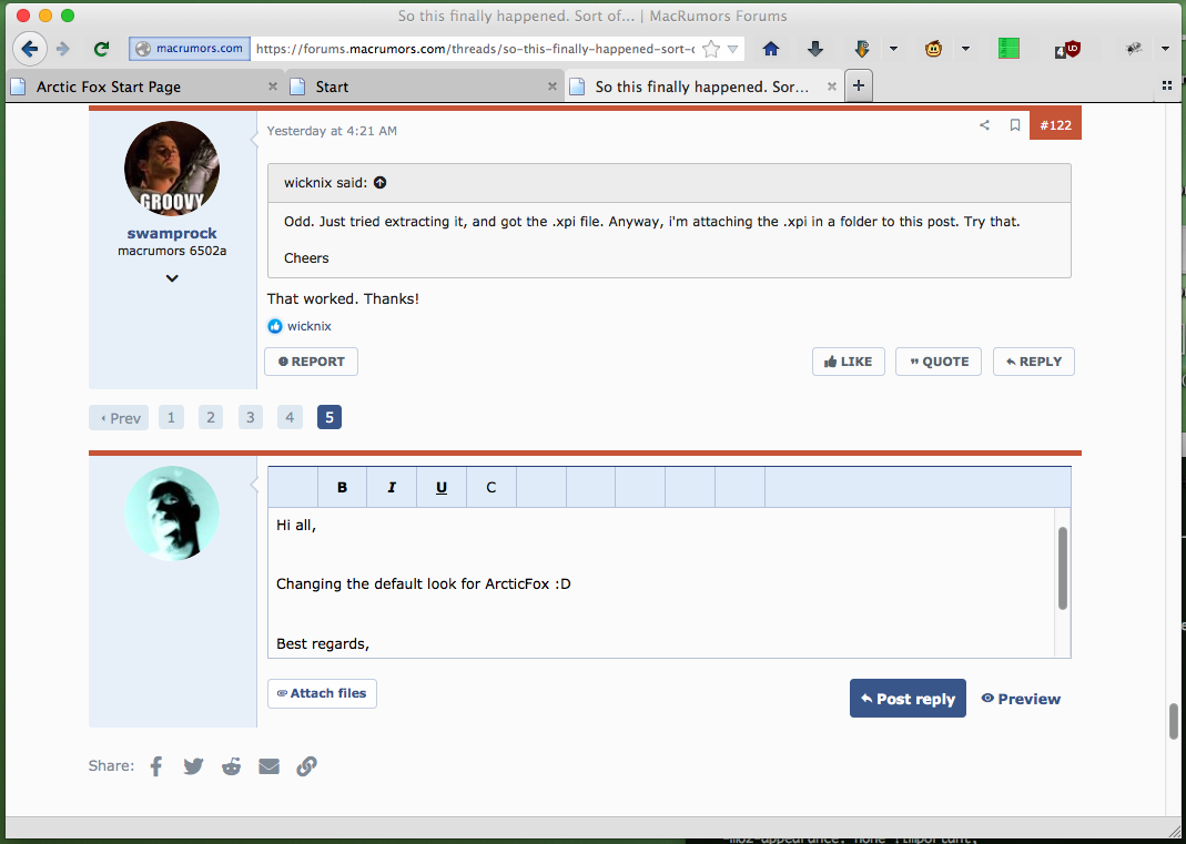

Seems that you can't extract the xpi from the zip, as both Apple's Archive Manager and The Unarchiver extract BOTH the zip and the xpi. Compressing and renaming the resulting zip to xpi, then moving it into the directory and running AF makes the xpi disappear from the /extensions folder.
Odd. Just tried extracting it, and got the .xpi file. Anyway, i'm attaching the .xpi in a folder to this post. Try that.
Cheers
Reactions: swamprock

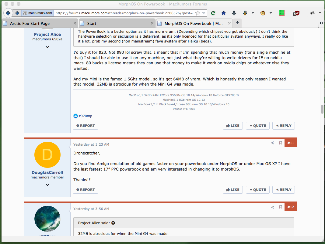

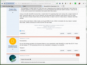

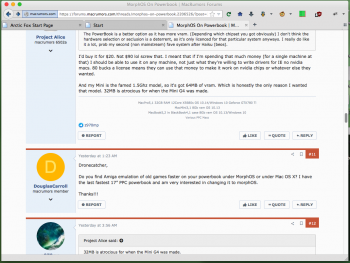

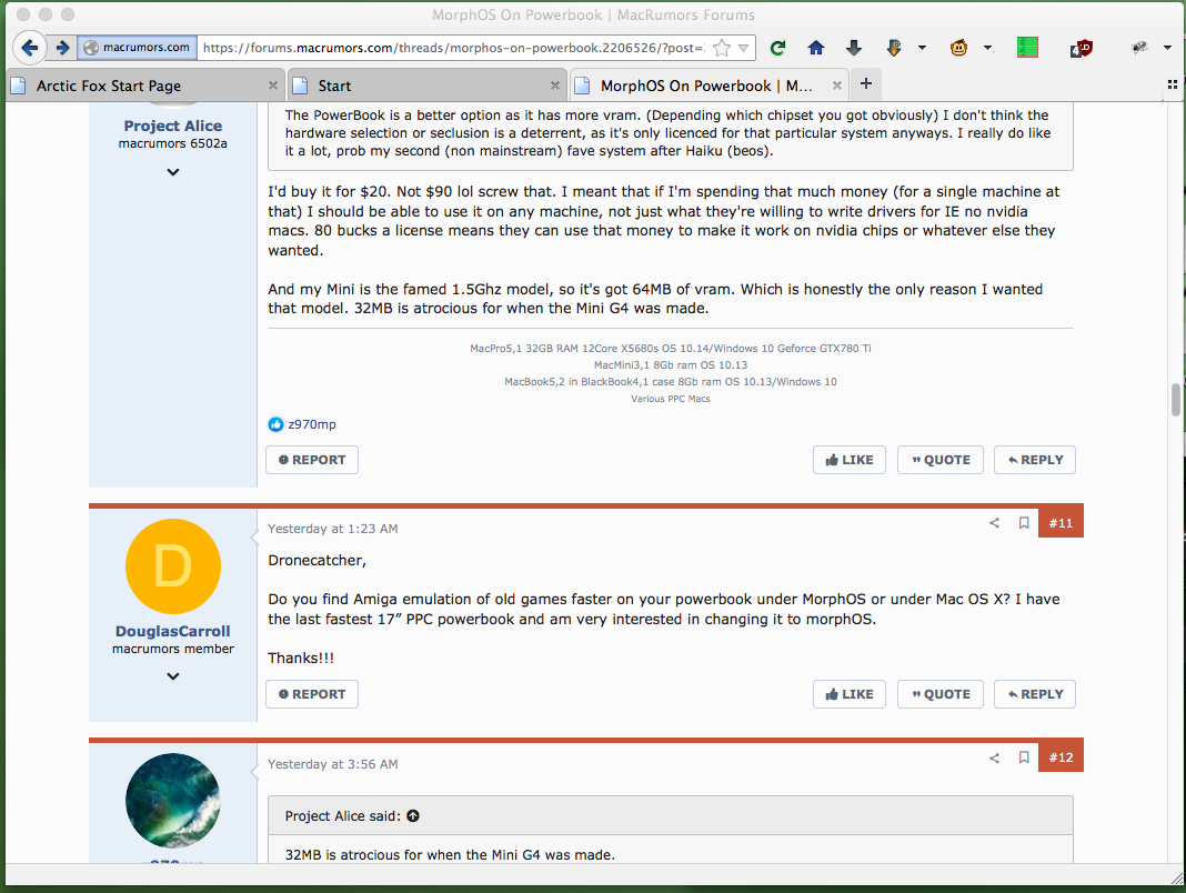

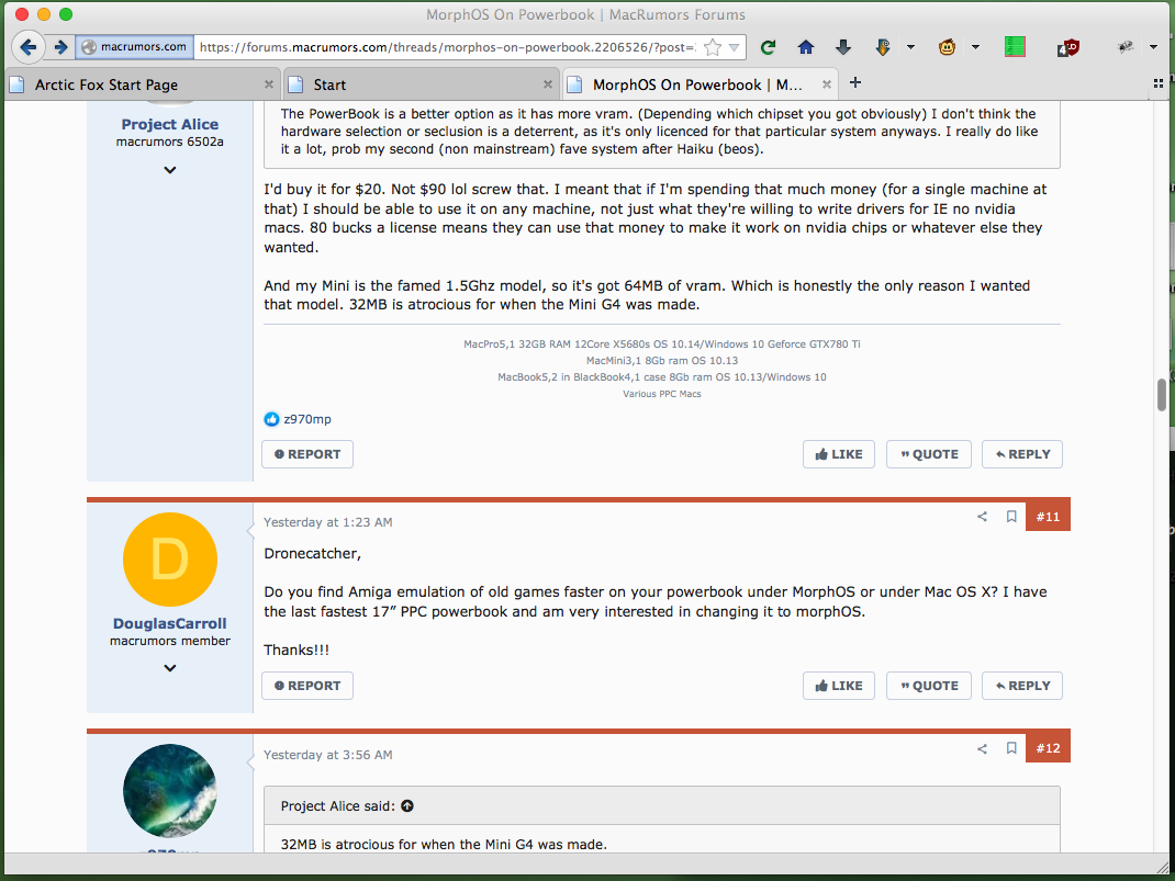

Hi all,
Changing the default look for ArcticFox 😀 ( optimized for leopard rebirth )
Not finished yet 🙁
Best regards,
voidRunner
