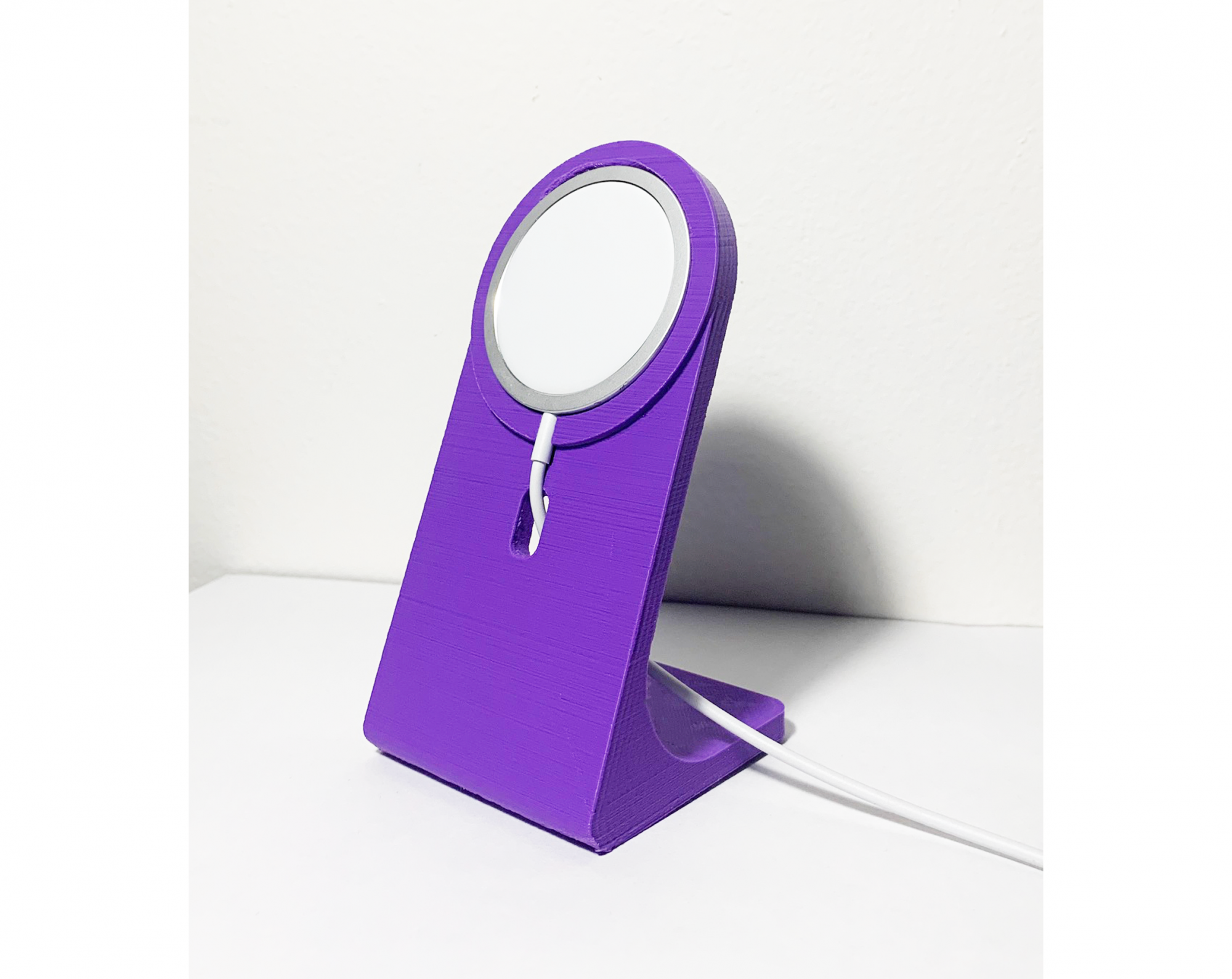

My iHome Qi alarm clock charger works, BUT the charge position is a lot more sensitive. It was sensitive before, but with the 12 Pro if it isn't in the exact middle then she ain't charging. Slightly annoying at first, but it's whatever now.
So my life is pretty much complete because my Reddit post made the front page of MacRumors.
In order to celebrate and aid the community through these dark political times, I am offering a 15% discount to MacRumors users on the MagSafe desk stand I designed to replace my non-working Qi chargers.
https://www.etsy.com/shop/SavvySimulations?coupon=MACRUMORS15
God speed. May every vote be counted.
-Savvy Skylake
