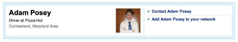

Again.. without saying how I've come by this information I can tell you this software will fix the way the phone is reporting signal.
Thank you for the assurance, Adam.
Just one more thing...
Are you the Adam Posey who works as a driver at Pizza Hut or are you the one who works for Apple Inc and we don't know about?
Well, son, with 27 Adam Posey's on FB, why would you select the one you did?
