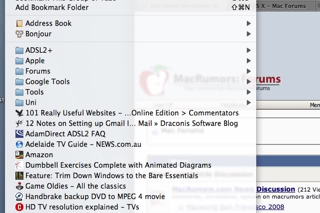

OK, having a bit of a problem here. The other night I decided to format/reinstall my system. Since I had recently switched to Mac, I was trying out various program and whatnot and just wanted a fresh start now that I know basically what I want installed. The install went fine, but now I'm back to enabling the translucent menus. This is what I'm seeing:
I followed the exact same directions (posted by richthomas on page 8) that I used last time. Last time it worked perfectly. This time as you can see, I'm left with a partial translucency.
Any ideas of what might have went wrong?
siorai your translucency looks fine to me. it definitely doesnt look like the 10.5.2 menus which are almost opaque. heres a screenshot of my menus which ive tried to make as similar as possible as your screenshot.
Maybe I just never noticed it before, but now it seems like it's only partially translucent? Most text seems to get cut if half. I'll have to check again after work. I'm probably just being too critical.
edit: That's what I get for adjusting my monitor's settings.. 😱 The contrast was a bit too high and caused the translucency to render weirdly. I put it back to what it was and it looks great again.
