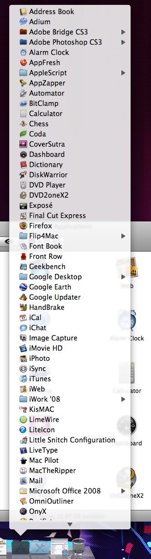

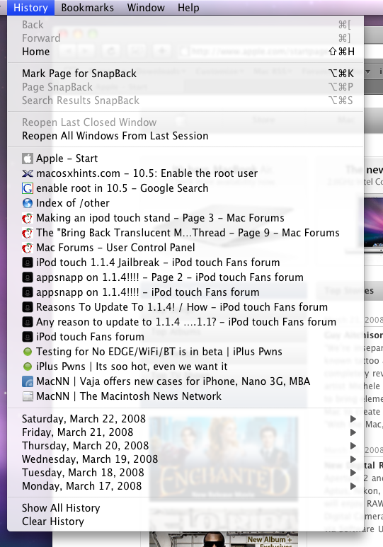

IT WORKED!!!!!
I'm going to make a tutorial on exactly what I did.
1. I downloaded the files that Stratus Fear posted (thanks dude!)
2. I enabled the root user by opening /Applications/Utilities/Directory Utility and clicking Edit>Enable Root User
3. I logged out of my normal user and logged into root
4. I went to /System/Library/Frameworks/Carbon.framework/Versions/A/Frameworks/HIToolbox.framework/Versions/A/HIToolbox and backed up the existing HIToolbox and dragged the new one into it's place.
5. I launched /Applications/Utilities/Terminal
6. Type this command in the Terminal:
Code:
chmod 755 /System/Library/Frameworks/Carbon.framework/Versions/A/Frameworks/HIToolbox.framework/Versions/A/HIToolbox
7. I went to /System/Library/PrivateFrameworks/CoreUI.framework/Versions/A/CoreUI once again making sure I backed up and copied the new CoreUI file and set permissions in the Terminal to 755 using the same method as step 6.
8. I went to /System/Library/PrivateFrameworks/CoreUI.framework/Versions/A/Resources/SArtFile.bin and replaced it with the new one... only this time setting the permissions to 644 instead.
9. Logged out and logged back in. My System is now nice and transparent again!!! Woohoo!
I hope this all works for you! It worked for me and I can confirm 100% that Stratus Fear was not lying.

i too can confirm that this is 100% working. lets just hope that Apple doesn't replace these files in a software update.

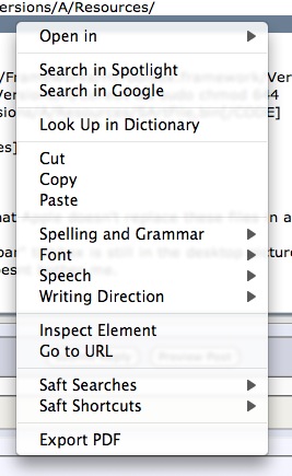

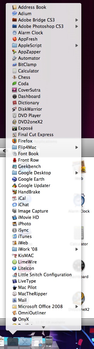

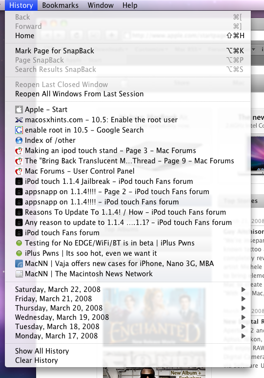

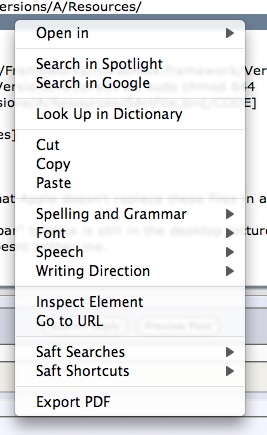

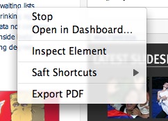

one thing to note though is although the "Translucent menu bar" tickbox is still in the desktop picture preferences it doesnt work so you cant have an opaque menu bar which doesnt bother me.
Screencapture 1.jpg Screencapture 2.jpg Screencapture 5.jpg Screencapture 4.jpg

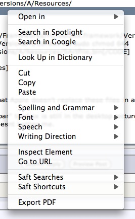

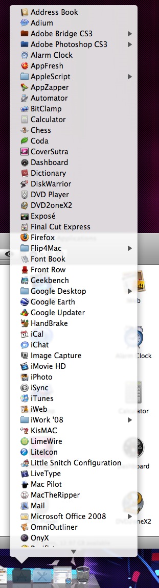

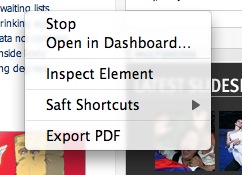

View attachment 109130 View attachment 109131 View attachment 109134 View attachment 109133

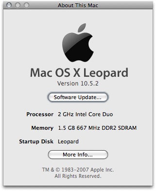

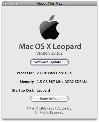

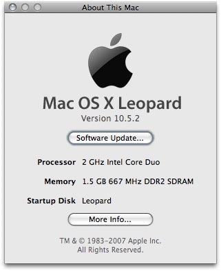

Interesting, I wish I had the courage to do this. How does the "About This Mac" dialog box say, "Mac OS X Leopard" with a black apple? It usually just says Mac OS X with the silver apple. Is this a haxie as well?
it's big paradox and it's stupid for Apple just removing the translucent things instead of make it optional to us ..😛
i prefer translucent menu bar, it's cool!!
yeh i made that myself... the apple icon was looking a bit dated... its cool huh? i cant remember where i got the black apple but the "Mac OS X Leopard" writing i got from Mitthrawnuruodo. i can post the files and install instructions if you would like? you will have to replace some more system files so i wouldnt do it unless you feel comfortable doing the instructions above... system folder madness!
I done that kind of stuff all the time with my iBook G3... Loved it! I changed my "About this Mac" window a lot and made it say I had a 900GHz CPU and 384GB RAM 😀 lots of other stuff, too!
