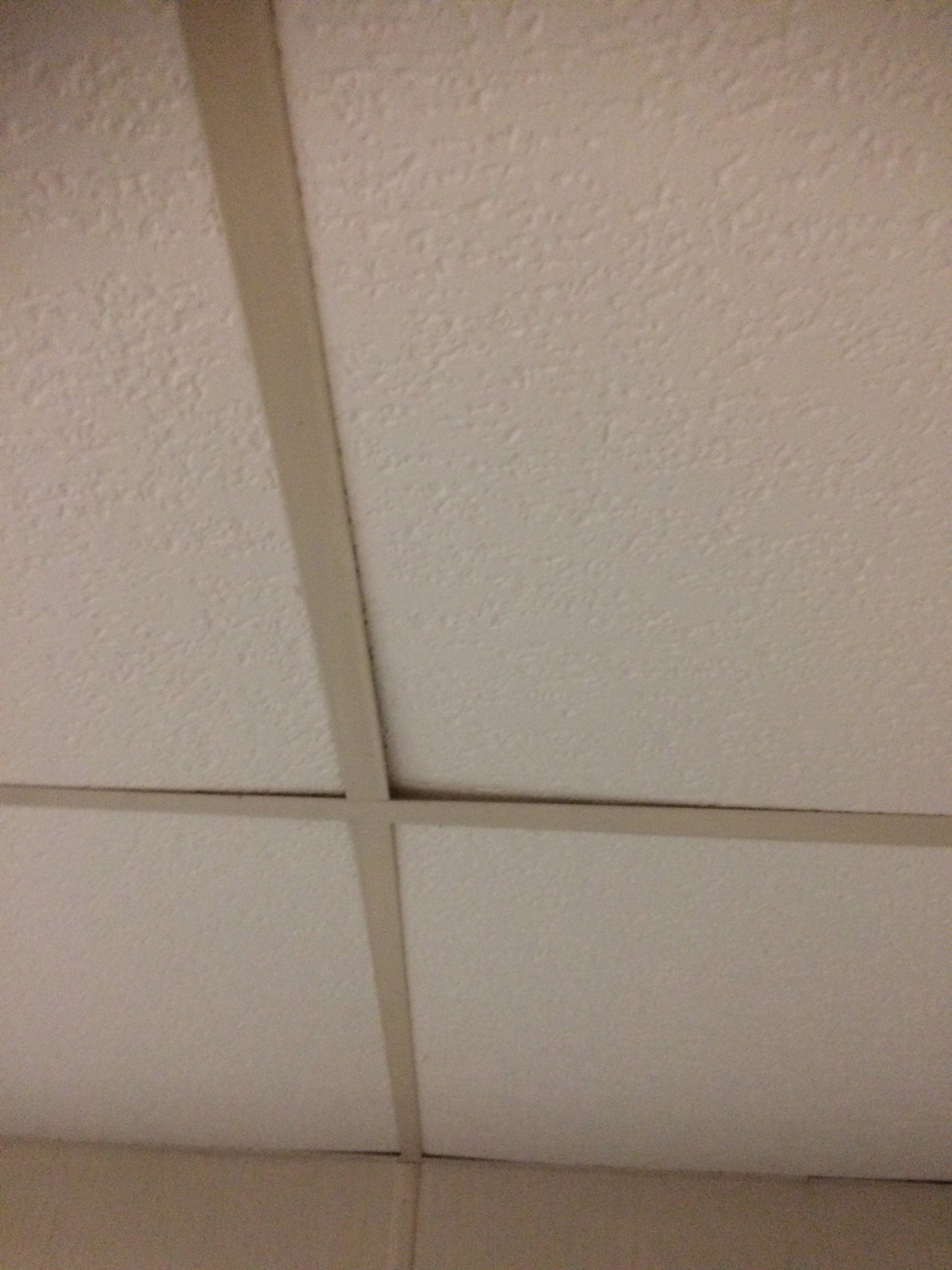

View attachment 771110 Anyone try MDF in drop panel ceilings?
Most of the panels in my office ceiling are curling. I was going to go with new panels until I saw how much they cost. I figured out it will cost me less than half using 1/2" MDF sheets. Cut them down to size and paint them. I've got about 20 gallons of leftover paint from various projects so that adds no cost.
My chief concerns are weight and will they curl too? MDF is much heavier per square foot than whatever type of fiberboard is up there now. To avoid curling I plan on using 1/2" rather than 1/4" MDF.
Weight would be an issue. The drop ceilings rails are pretty light weight and (in my experience) not always anchored the best way. And keep in mind that the panels do occasionally fall out... MDF will also warp if exposed to any moisture, especially the thin stuff.
I'll also be replacing the fluorescent light with can lights. I already know what I'll be doing for that. Just an FYI.
Do they make MDF panels designed for this purpose? My impression is too heavy.

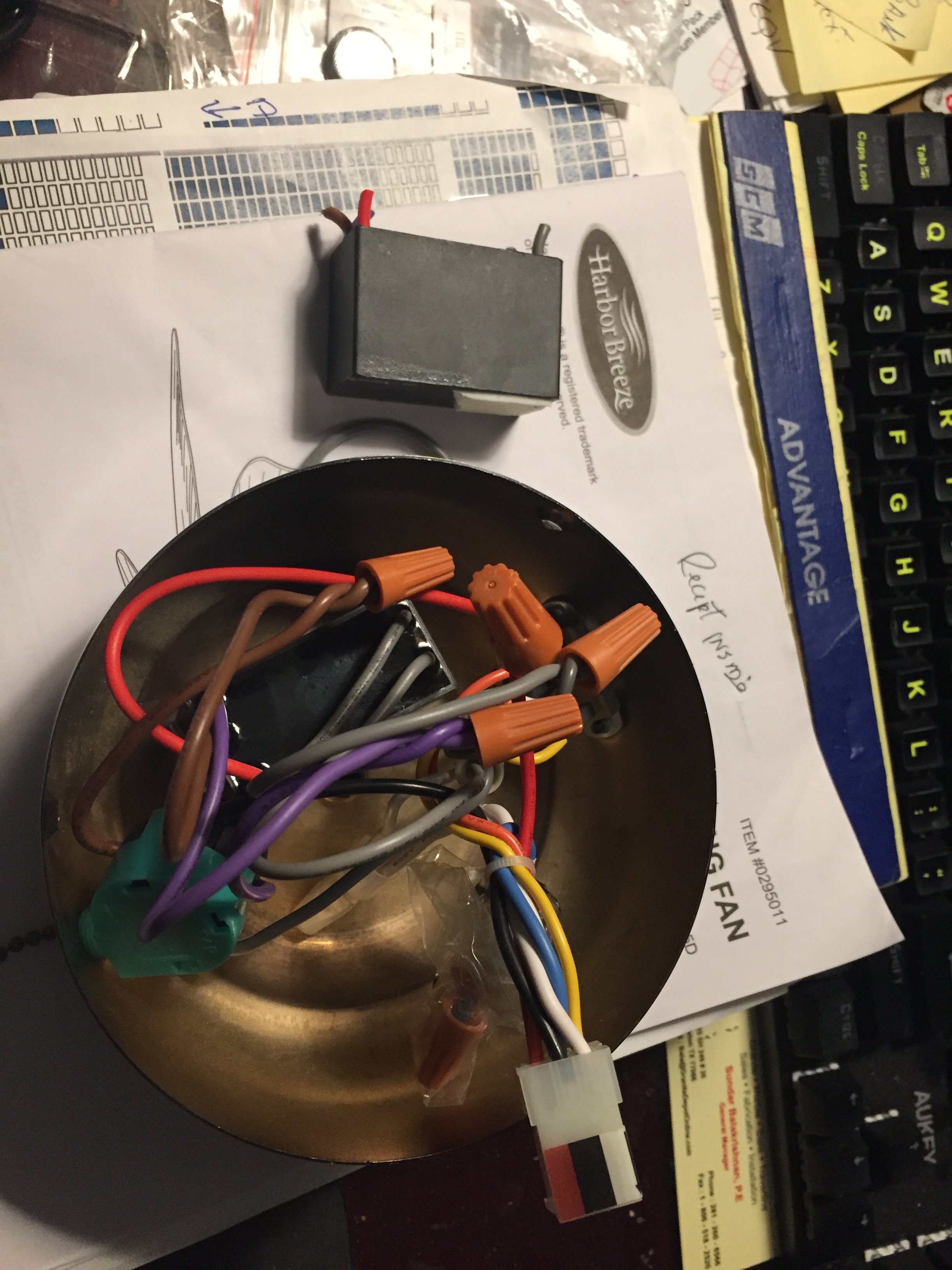

Ceiling fans-
I am reminded of the saying, you get what you pay for. We have two beautiful ceiling fans purchased at a big box store about 3 months apart, 6 years ago. The price was good, about $100 each. Recently one of them got slower, then refused to start turning without a helpful push, and now it seems to be done.
Ceiling fans have always struck me as something that go for a long time like 20 years. We have fans in our house that were here when we purchased the house in 2011 that maybe are 20 years old, and are still going strong. So for this fan, I’m wondering if this was a fluke of if the other fan is right behind it?
I assume the motor brushes have worn out, and wonder if these things are capable of being repaired? Anyone with experience regarding this? Thanks!
may or may not solve the problem. Fans have one or two capacitors in them. If the fan not working fan is worth the effort; remove the caps and a well stocked homeDepot might have them. A skilled associate may be able to find them on homedepot.com for you. Call around different area lamp shops. There are a few youtubes on this.
Many times it is cheaper to buy new, particularly with lower end fans. Wile I will put them in office/small bedrooms, for master bedroom and living areas, I insist on Hunter. It is worth the little extra.
I have the fan manual, hence manufacturing contact number, so I’ll ask and see if it’s repairable.
Good news, the fan is a Harbor Breeze brand name, Baja Ceiling Fan which has a life time warranty on the motor. I called the company today, described the issue, and they are sending me a condenser for free. Hopefully, this does the trick! 🙂

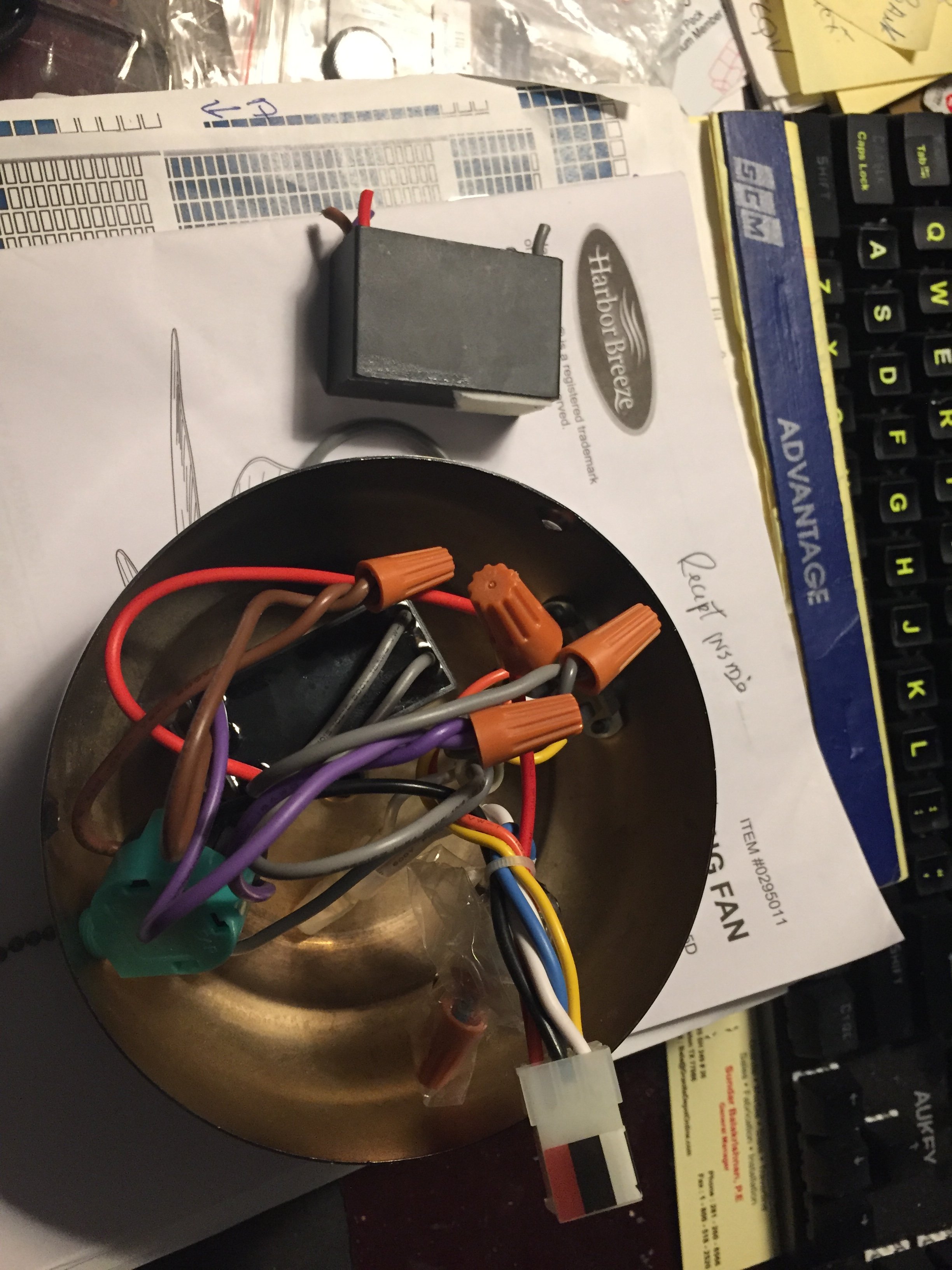

The capacitor came today, swapped it out, and I have my fan back. 🙂
Old capacitor with the wires cut off it.​

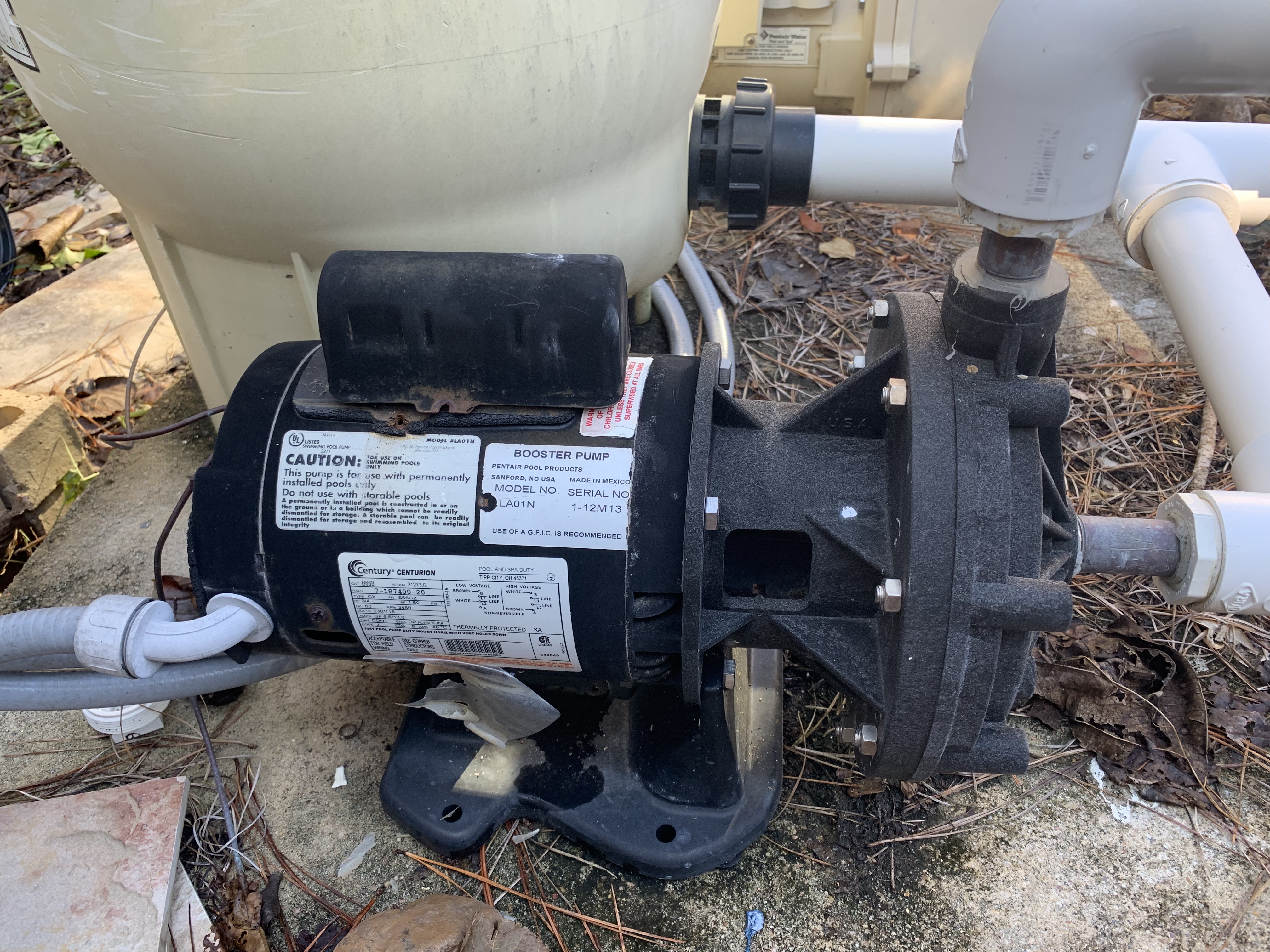

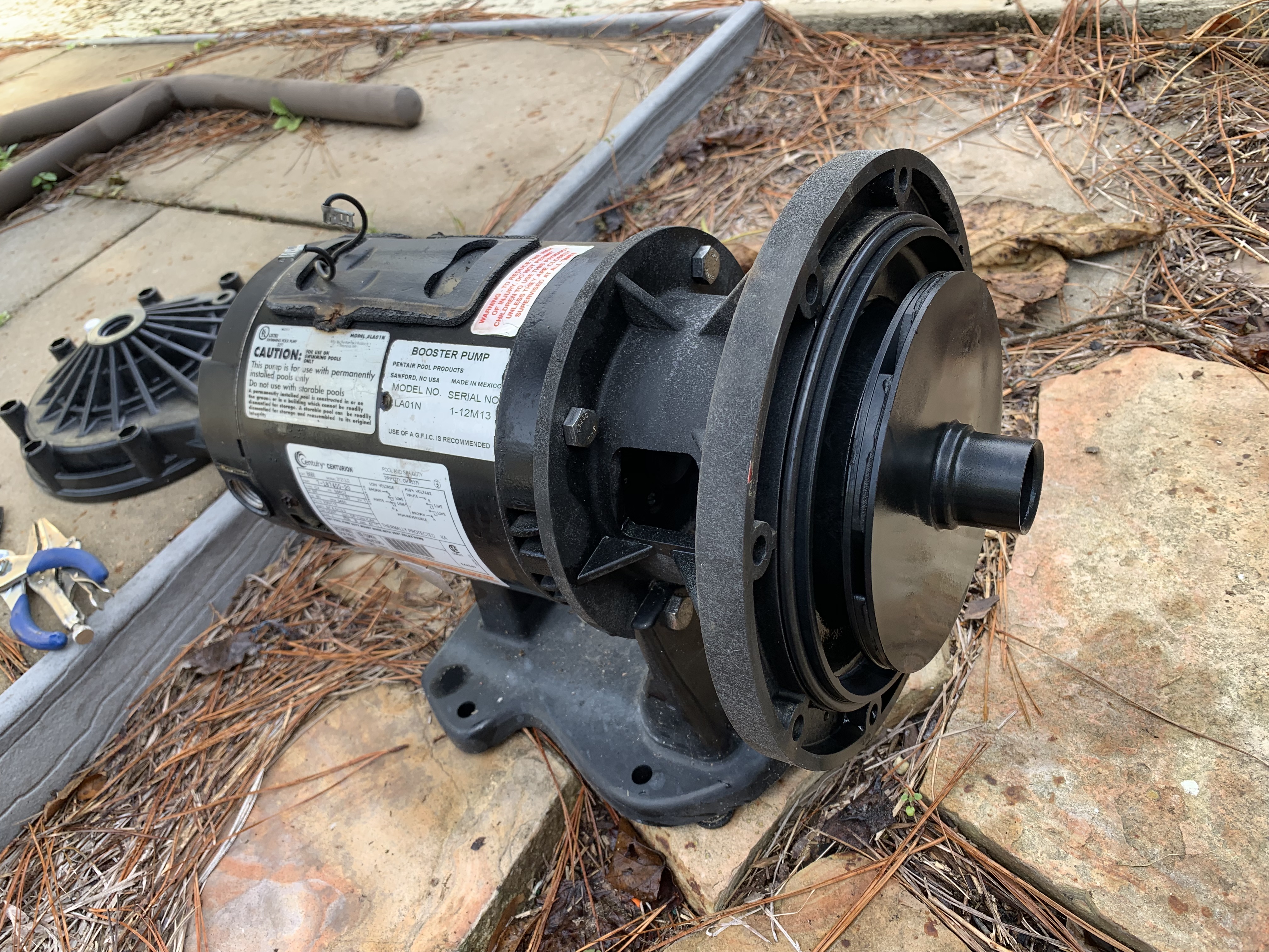

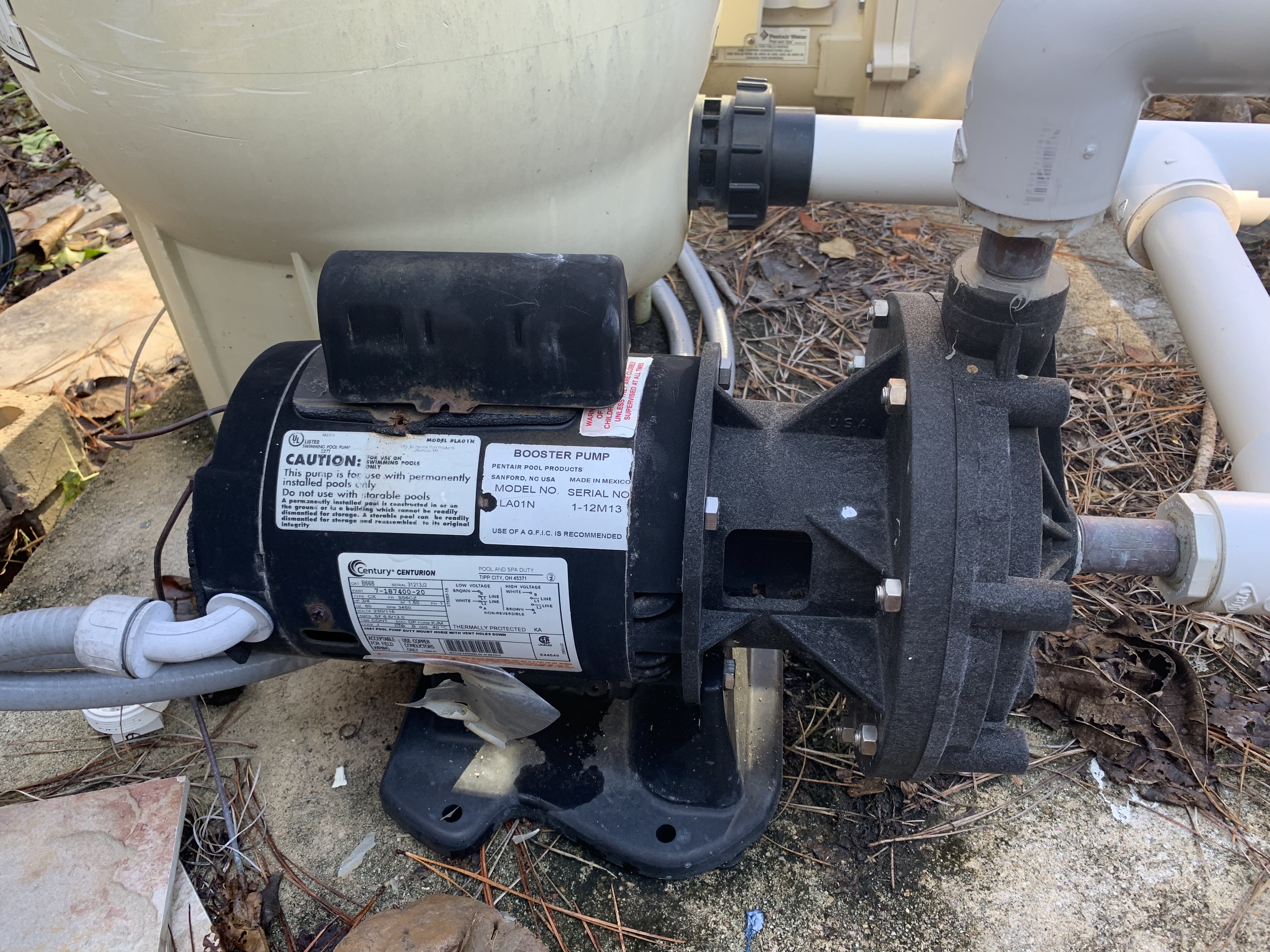

Replacing a pool pump
Had the pleasure of replacing a pool pump today. Fortunately this pump was replaced once under warranty so I got to watch the pool people do it previously, so I realized the impeller housing does not have to be removed.
This is a Pentair LA01N pump, used to run the automatic pool cleaner (Pentair Kreeoy Krauler Legend). I purchased it on Amazon for $250. The pool company would have charged $350 for the pump, and $125 to install, with a 2 year warranty. I purchased a 4 year warranty through Amazon for $15.
However before purchasing a new pump, troubleshoot the original pump and realize this is a 220v pump with a double pole 20amp circuit breaker. If you are unfamiliar with working with electrical components, hire the pool people to do it. 😛
Check the electrical connection with a volt meter and make sure both phases are powered and/or the CB has not failed. Secondly, replace the capacitor (https://en.m.wikipedia.org/wiki/Capacitor) which is a small cylinder that has two terminals and simply unplugs. It is found in the black protrusion on top of the pump. Two screws hold the cover on. These fail often and cause the pump to stop working. I’ve restored two pumps and a ceiling fan to working order by replacing the capacitor.

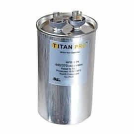

Capacitor

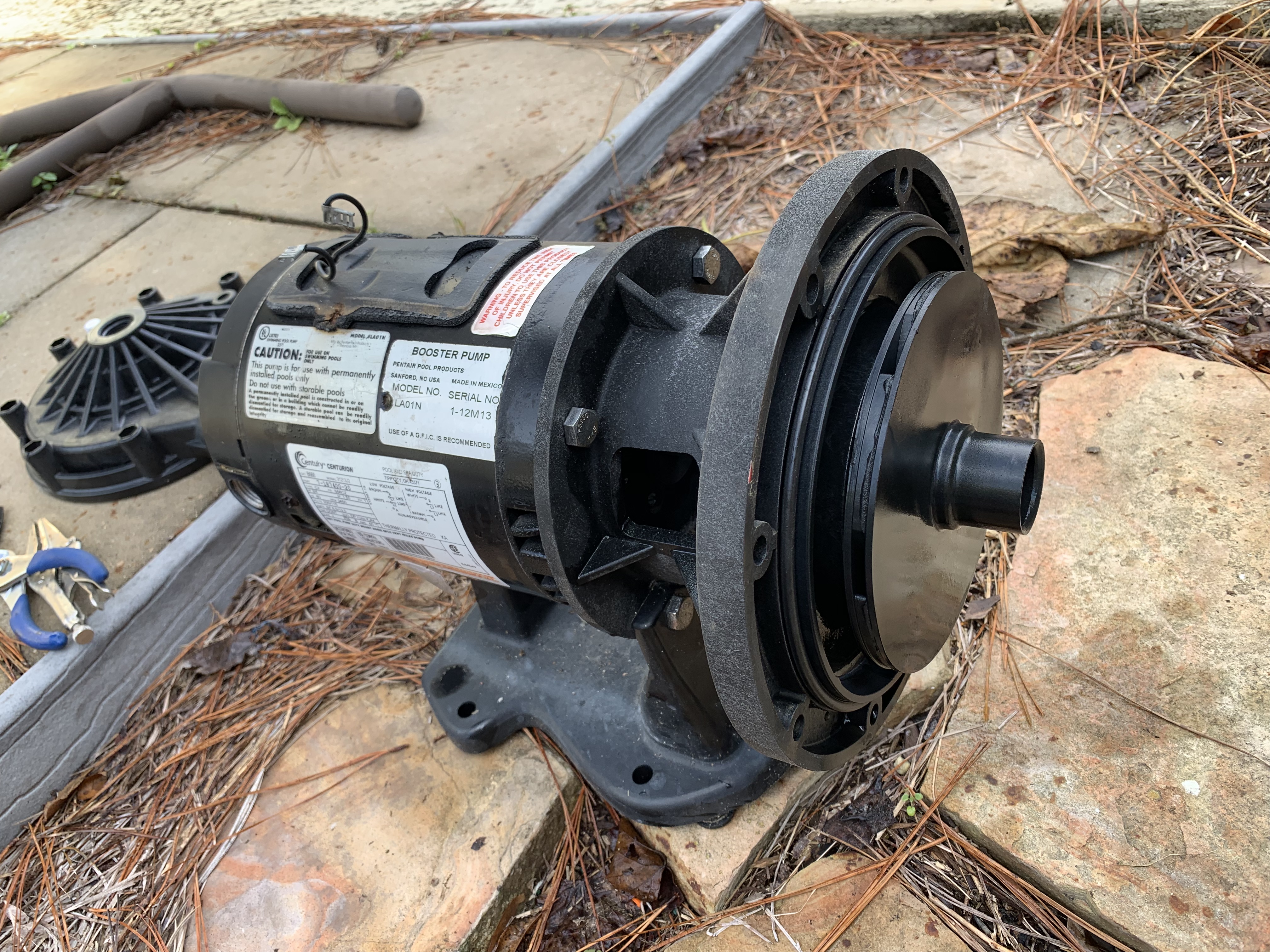

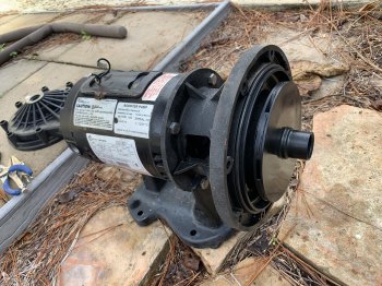

Disconnect the electrical connection (top image) at the back of the pump.
The pump impeller casing is tied into the pool piping (top image) and to replace that would be a real pain. However if the stainless nuts and bolts around the housing are removed (top image) the pump and it’s impeller can be easily removed (image below), leaving the impeller housing in place connected to the piping.
When the original pump is removed water from the pool filter will start to flow out slowly, so have the new pump ready to slide into place and reconnect the impeller housing nuts and bolts. Make sure the gasket on the pump half of the housing does not become dislodged when it is bolted to the impeller housing. Reconnect the electrical wires, and the exterior ground wire if there is one and hopefully you will have a pump that runs! 🙂

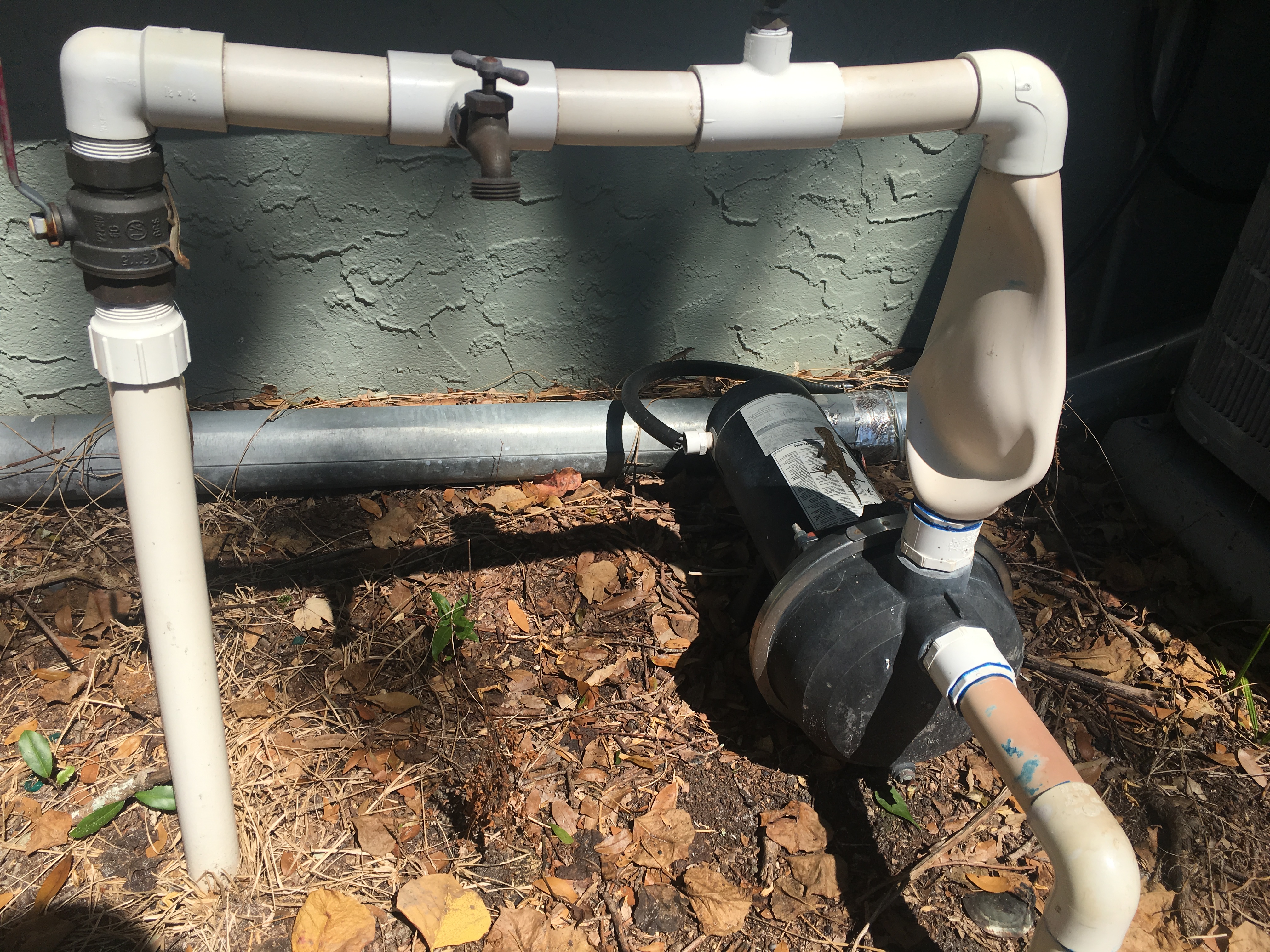

I got lucky and thankfully didn't need to replace the pump. While this is a shallow well pump for sprinklers, #4 zone valve quit working and the pump was dry pumping creating the heat that distorted the PVC as well as the burnt color on the intake. Problem was low volt electrical wires from controller/timer to valves and when installing the new AC unit workers cut the wire. I had patched it but after a year or so, it stopped working. Valves are in two boxes (3 and 3) and the impacted wire was not the one next to the pump where easy to dig to, but the other side of the house and buried in the original trenching. Ran new wires for zones 4, 5 and 6 but up the house, through the attic and back down.
The good news is, while I knew the pump ran, when I replace the damaged intake line and re-primed it, it pumped a geyser out the open outtake. Then just had to rebuild the outtake line.
