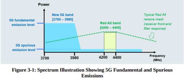

Here's a diagram that shows the relationship between the two bands. This is taken from the RTCA doc I linked in a prior post.
So this whole issue dates from October 2020 when the RTCA, an FAA advisory group, published a paper which showed that there could be interference between 5G base stations and phones and aircraft radio altimeters. This was based on experiments conducted in a lab.

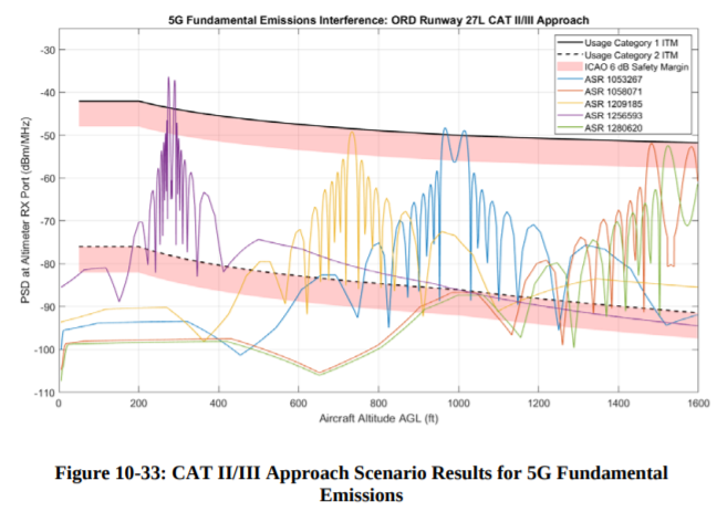

From the RTCA report:
Note: Usage Category 1 aircraft refers to commercial airliners. Usage Category 2 aircraft refers to pretty much anything else that's not a helicopter. Usage Category 3 aircraft are pretty much helicopters. All of these aircraft would have redundant radio altimeters which is why the possible outcomes discussed below reference 2 altimeters.
Consistent with the parametric analysis results, the Usage Category 2 ITM is exceeded
throughout nearly the entire approach until the aircraft gets below 200 feet altitude. Even
for Usage Category 1, however, the results show significant impacts throughout the
approach with the potential for Catastrophic effects. All five base stations produce
interference above the safety margin relative to the Usage Category 1 ITM, and two of the
five base stations even breach the ITM itself. It should also be noted that the computed
interference levels from all five base stations significantly exceed the Rec. ITU-R M.2059
Receiver Overload protection criterion of -73 dBm/MHz (based on the -53 dBm limit given
in Table 6-1 and an assumed signal bandwidth of 100 MHz).
The interference seen throughout the CAT II/III approach scenario is likely to cause many
of the operational impacts noted in Table 5-1 which are applicable to approach and landing
(or to all phases of flight). However, the most concerning result shown in Figure 10-33 is
the large interference spike (more than 7 dB above the Usage Category 1 ITM) seen at an
altitude of about 275 feet. Since the radar altimeter antennas in a multiplex installation are
typically adjacent to each other, it is anticipated that such an interference spike would result
in a common-mode failure of all radar altimeters on the aircraft. Considering a dual radar
altimeter installation, which is the most common on Usage Category 1 aircraft, the
following outcomes are possible:
1. Both radar altimeters become inoperative (either reporting NCD or indicating a
hardware failure);
2. One radar altimeter becomes inoperative, while the other radar altimeter provides
erroneous altitude readings;
3. Both radar altimeters provide erroneous altitude readings which do not agree; or
4. Both radar altimeters provide erroneous altitude readings which are in agreement.
In the first case, it is expected that the autoland function will disengage, and the flight crew
will need to intervene to determine whether the aircraft can be landed safely or if they must
execute a missed approach or go-around. Such a determination must be made very quickly,
and using limited information. For a typical Usage Category 1 aircraft, the interference
event at 275 feet AGL leaves as little as 20 seconds before touchdown if the approach is
continued. Further, in a CAT II/III approach the pilots will have little or no visibility along
the runway to identify visual cues to assist in their determination of the actual height above
ground. Even if the pilots are able to react in time and execute a missed approach, this
maneuver poses a significant safety risk to both the landing aircraft and other air traffic in
the immediate area, particularly in low-visibility conditions. This places additional burden
on air traffic controllers to safely manage the airspace. In addition, if multiple landing
aircraft are impacted by RF interference and must execute missed approaches in low
visibility conditions with high volume air traffic, controllers may need to stop issuing
approach clearances to the specific runway or airport that is affected.
In the second case, the availability of only one radar altimeter means that the erroneous
readings from the second altimeter cannot be identified as such by either the autopilot
system or the flight crew. On some Usage Category 1 aircraft, this situation may not result
in the pilots being alerted to abort the landing, and they must make their own determination
on whether the approach can be safely continued. As in the first case, this determination
must be made very quickly, and with limited information. If the approach is continued in
this scenario, the erroneous altitude readings will likely cause the flight crew to conduct
the landing flare and throttle retard either too early or too late. At best, this would lead to
a hard landing, and at worst, a Catastrophic impact with the ground would occur.
In the third case, it is expected that the autopilot system will be able to identify the
mis-comparison of the radar altimeter readings and conclude that the data is erroneous. This
scenario will then typically lead to the same result as the first case. However, on some
aircraft types the erroneous readings from one altimeter may be continued to be used by
the autopilot system unless there is flight crew intervention in response to the
mis-comparison. In this instance, if the pilots do not respond in time, the result may be a
Catastrophic impact with the ground due to improper timing of the automated flare
maneuver and auto-throttle retard. Such was the case for the Turkish Airlines flight 1951
crash near Schiphol Airport in Amsterdam on February 25, 2009 [43].
The fourth case presents the greatest danger. If both radar altimeters are erroneous but in
agreement, then neither the autopilot system nor the flight crew will be able to identify this
situation, and the approach will proceed with incorrect altitude readings. This will lead to
the autoland system executing the flare maneuver and autothrottle retard at the incorrect
time, causing either direct Catastrophic impact with the ground, or causing the aircraft to
stall and subsequently have a Catastrophic impact with the ground. In this instance, the
pilots will be unaware of the erroneous data and unable to intervene.
In all cases, possibility of harmful interference in this instrument approach scenario is
particularly dangerous given that up to the present time, radar altimeter failures during this
phase of flight have been extremely uncommon, especially on Usage Category 1 aircraft.
Based on a typical descent rate of 600 to 800 feet per minute.
Thus, the occurrence of such failures is certain to cause confusion among the flight crew
which could further complicate and delay their response.
