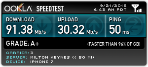

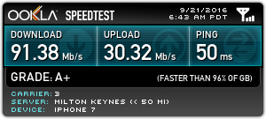

Nope. All good here.

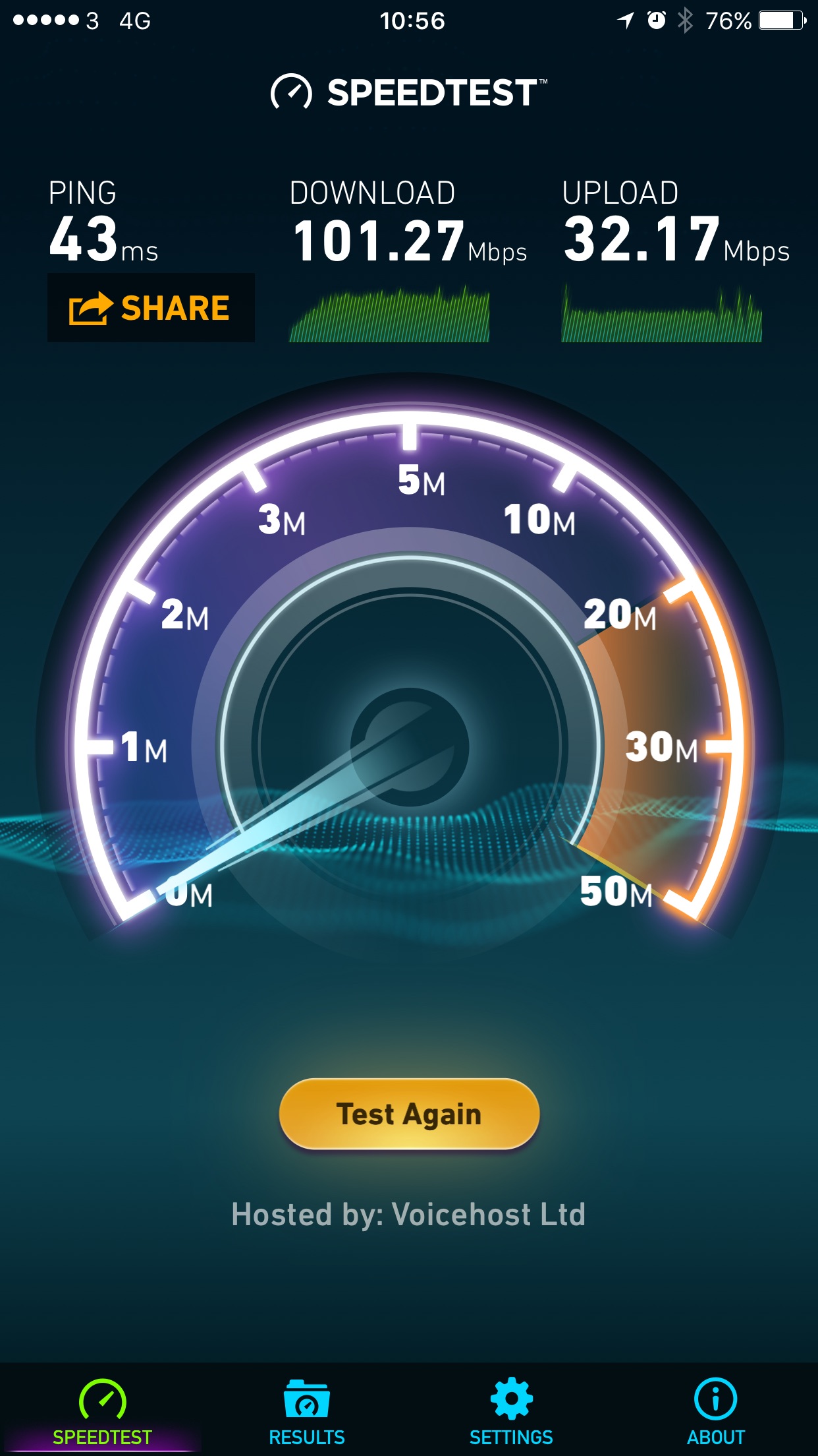

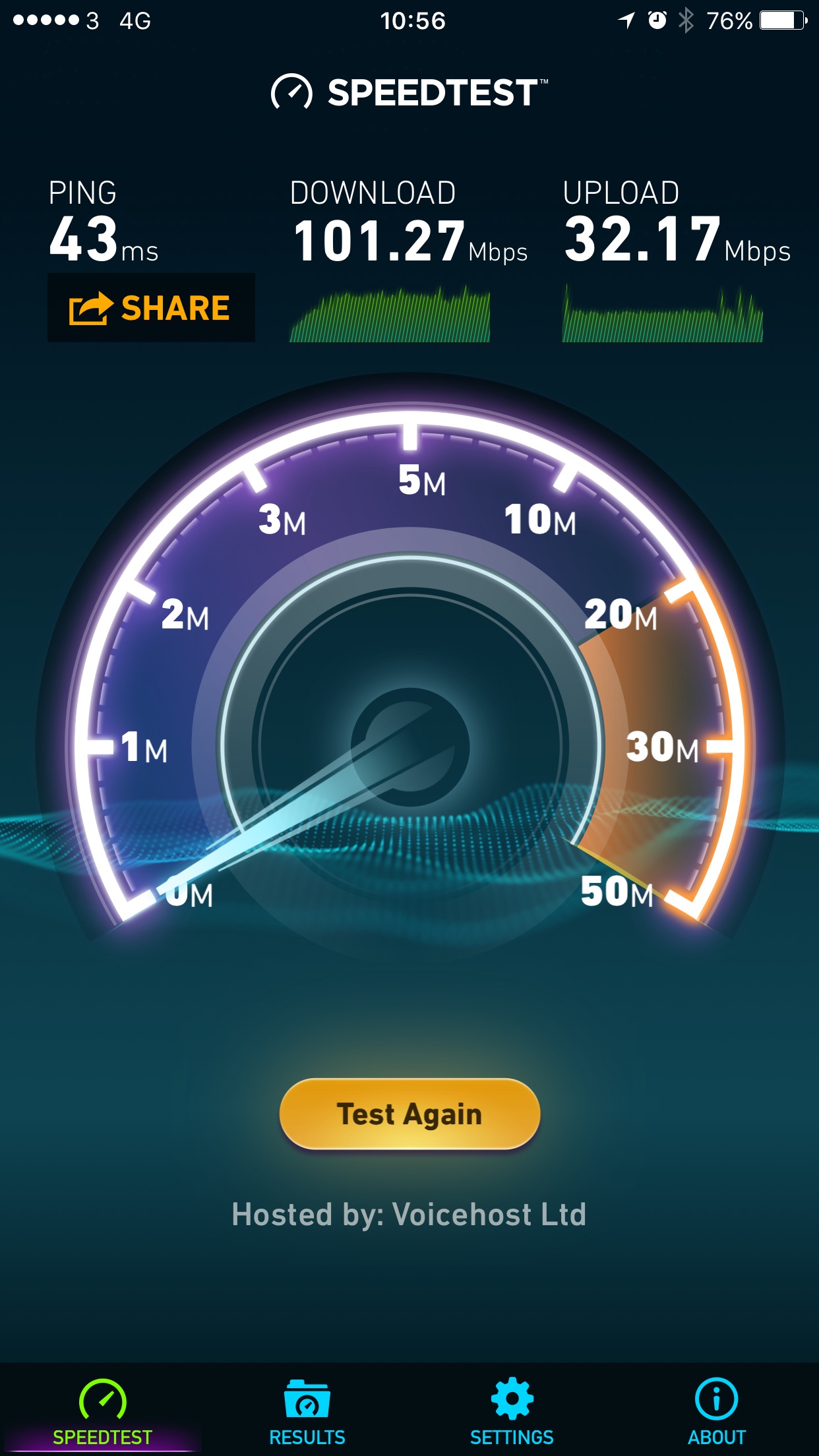

When connected it's good, the problem is staying connected.
How come some of you are getting such incredible speeds on 4g? I get about 40mbps at my home and work.
Speed totally depends on signal strength. How congested your area is. How good the actual tower is. One moment I can can get 100 and the next it will drop to 10.
