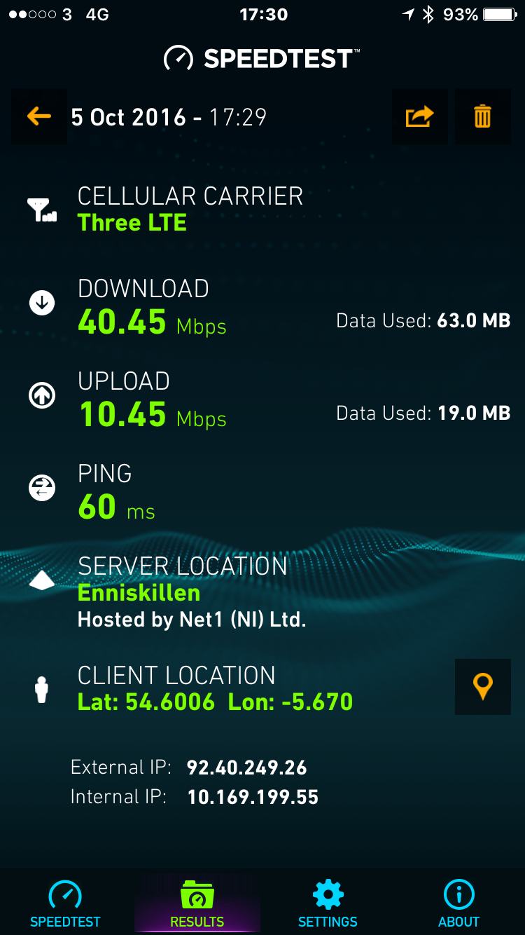

Can ask how you can tell what wavelength it's on ? 800 ?
[doublepost=1475685070][/doublepost] IMG_0626.PNG

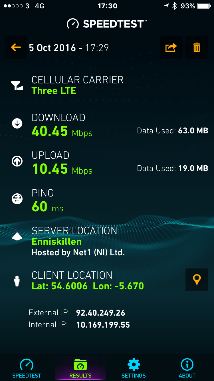

[doublepost=1475685114][/doublepost]This is the speed I'm getting indoors now on my iPhone 7. Very happy
[doublepost=1475685070][/doublepost]View attachment 663138
You should be. Suspect that's a cell site with plenty of spare bandwidth.

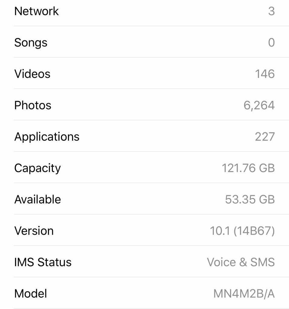

[doublepost=1475686731][/doublepost]
Click on carrier and it will flip if volte is active
You actually just need to open settings - general - about and a carrier profile check will be done.
[doublepost=1475686762][/doublepost]
Misunderstood your message. Sorry!

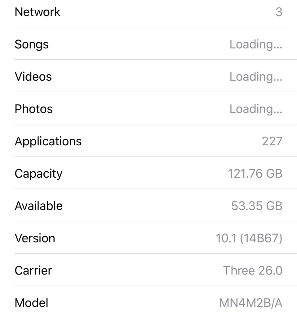

Three 26.0 is only available with iOS 10.1 developer beta 2 (out Tuesday) and iOS 10.1 public beta 2 (out tonight).
iOS 10.0.2 uses Three 25.1 and iOS 10.1 developer and public beta 1 use Three 25.5.
From my own experience it would seem only Three 26.0 offers a fix.
Well I can say with a fair amount of confidence after a couple of days worth of testing
It's fixed in Carrier Update 26.0 🙂
