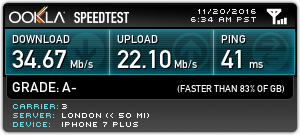

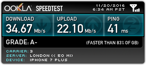

Called 3 this morning after noticing that I couldn't get over 2MB download speed yesterday in various locations in London on 4G - iOS 10.1.1 || Three 26.0, Enable Data is set to 'Data Only'.
Customer service rep tells me that for about 15 days customers have been reporting that they can't access 4G from iPhone 7/7+ devices and have informed Apple and are currently waiting on them for software update.
Don't know how much this helps, but just wanted to add to the convo.
Edit: I've since turned off 4G, and I'm getting download speeds of 20+MB so it's not all bad.
That's on 3LTE with 3-4 bars of service strength.
