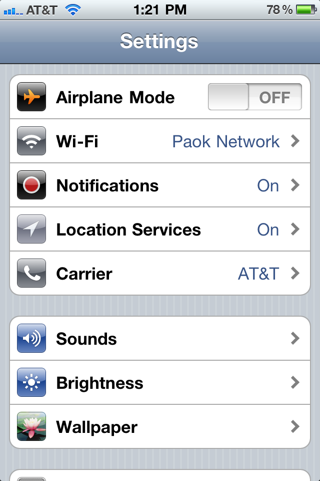

So just an update I ended up getting the carrier setting again yesterday on my phone.
But even though its there my VV and MMS still work fine.
So even if you see that carrier option when you're on AT&T with ultrasnow installed your stuff might still work fine. Figured it might help some.
Here's what it looks like below.
That happened to me, too, last night. I had restarted my phone after data appeared to have stopped working. But my VVM wasn't working. Reset network settings a few times, but no luck. This morning, I uninstalled US, rebooted, reinstalled US. Still no VVM. Reset network settings, and now VVM is back. Not sure what happened last night
Weird. Any idea what caused the carrier option to come back? Mine hasn't come back.
