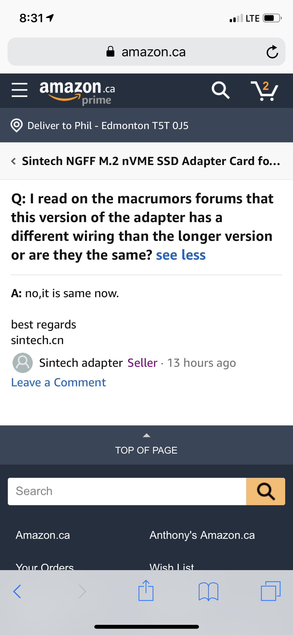

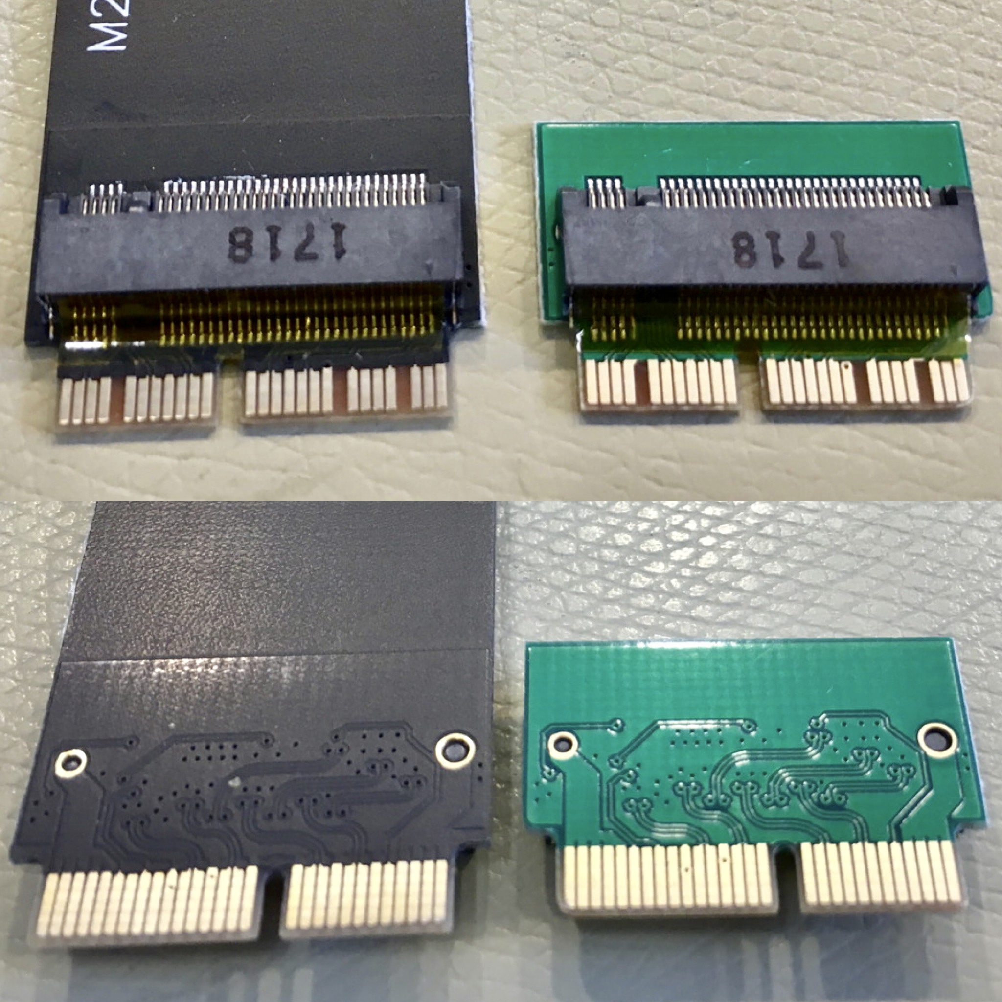

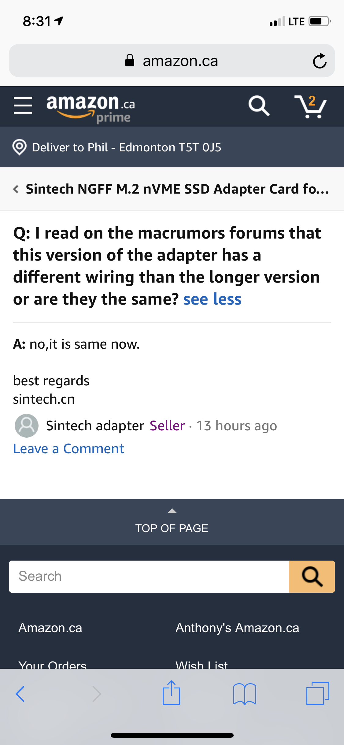

I asked the amazon.ca sintech seller regarding the different wiring in the short black adapter as compared to the long one and they said both adapters are the same now. So I’ll order a short one now and compare lol.
Apparently, the short black and short green are different.

Yes but that information is based on previous feedback within this thread. I believe the green one isn’t being manufactured anymore and has now officially been replaced by the short black that I think is just the long version without the extra pcb board materials. If you check the sintech site it shows the “B” version having only 149 units left in stock however the long and short black adapters show around 8000+ units in stock which tells me that those units are obviously the current in production models. If you check both amazon.com and .ca sintech only lists those two version to purchase.
I understand your reasoning and I'm not saying you are incorrect.
The person that pointed out the wiring issue is a person with lots of experience and knowledge with respect to the use of different adapters and drives in several different Mac Pros and MacBook Pros.
I have the short green and it's been perfect for me in a few MacBooks. I ordered the short black directly from Sintech because I don't need the screwdrivers.

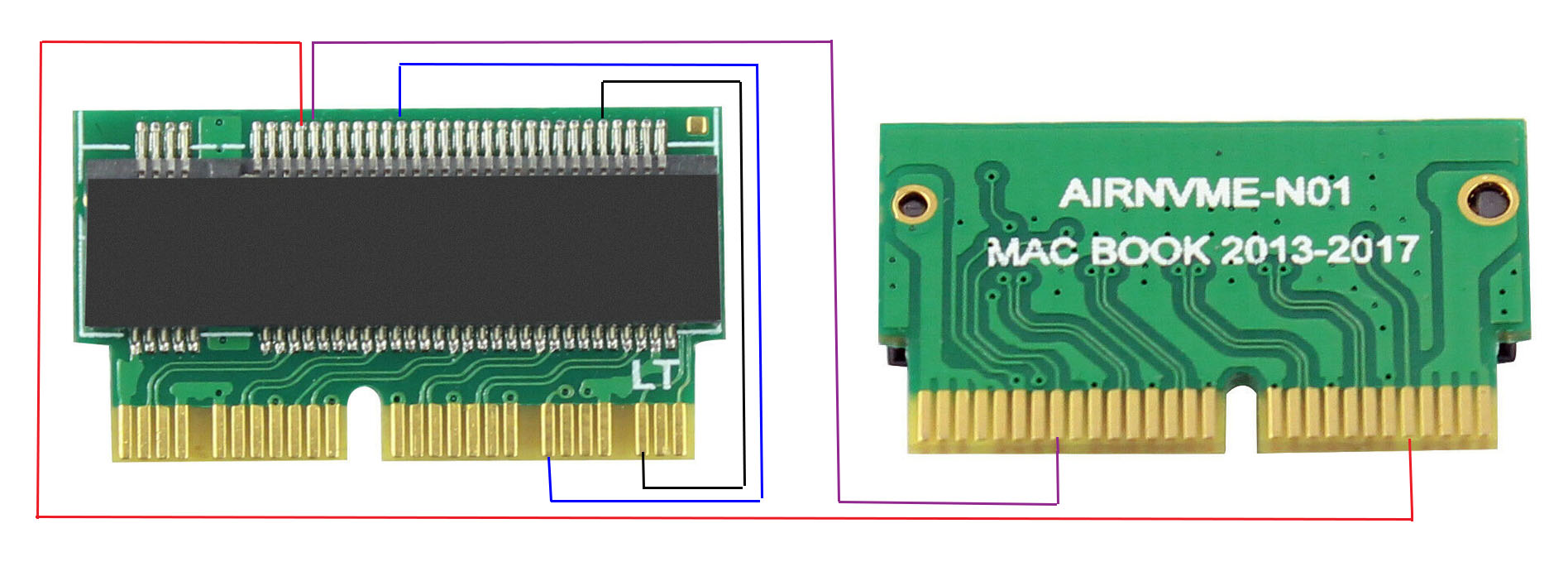

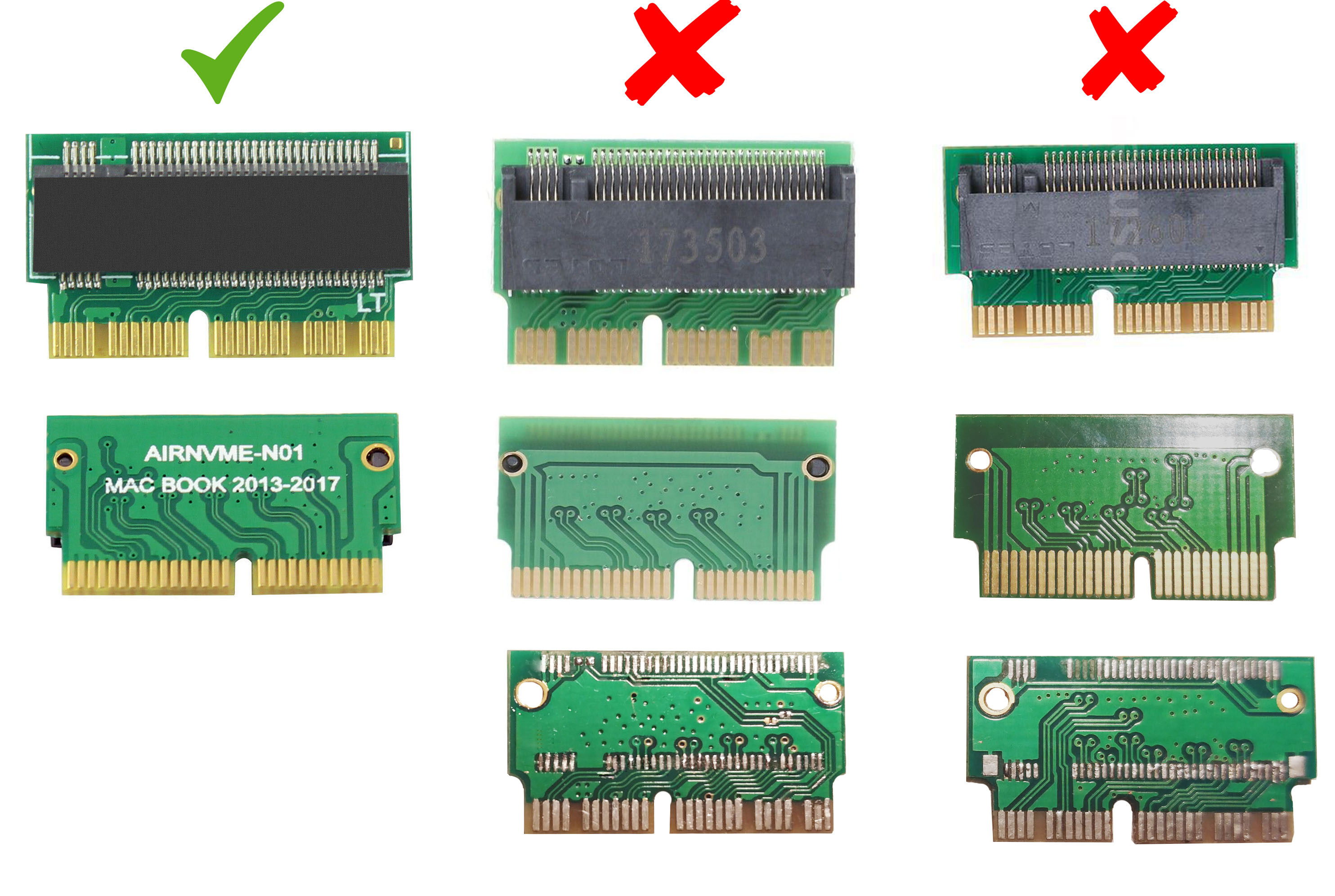

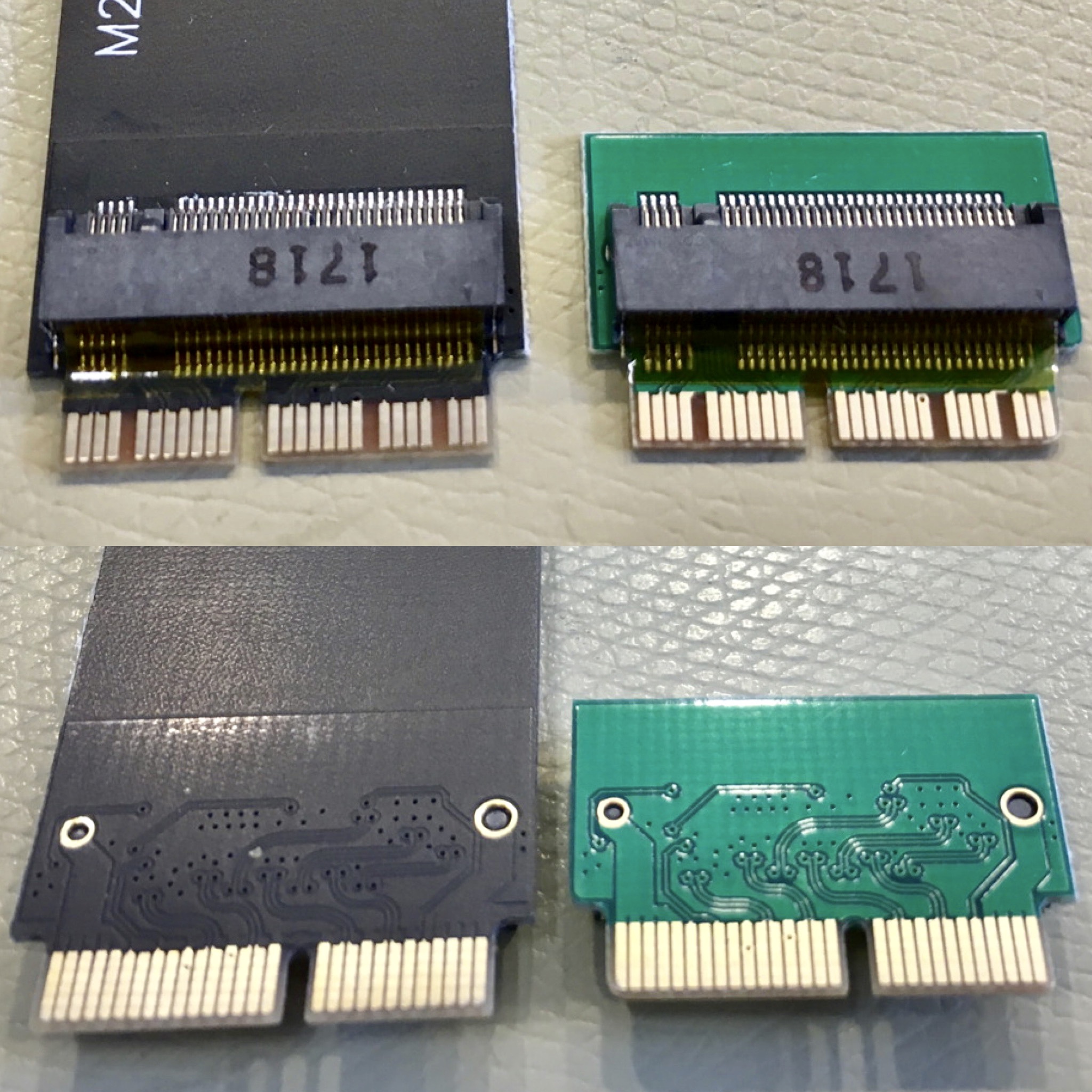

Alright, so today I have finally received a noname adapter that works, and therefore decided to make visual comparison of all three noname adapters present on eBay (Sintech excluded) side by side. The one that works I got here: https://www.ebay.com/itm/254072680721
Key difference can be seen on the back side - there are two additional traces with vias going from pin 8 on the the left side and pin 5 on the right hand side (no idea how these should be numbered correctly).
On the second picture I've drawn what key pins go where. All four are either not connected/grounded/shorted to 3.3V line in the non-working adapters. Essentially AIRNVME-N01 adapter is a copy of green sintech, but with a slightly different design.
Hope that helps.

Don't worry just yet - it is possible Sintech changed design/wiring without changing color of PCB they are using. If you have multimeter what you can do is to check continuity between pins I mentioned in my previous message.

That’s exactly what I’m saying and thinking. I’m also going to take a look at my long black boards when they arrive and see if there is any wiring or anything on the rest of the length of pcb board material. If there isn’t I’m sure I could just cut it down to the length I need. But before I do that I’ll wait til I get the other sintech boards in so I can compare all 3.
Check out this attached image I’ve found showing the underside of the long black one next to the green adapter. You can clearly see a line where the main pcb ends. I’d be confident you could just cut off that part and convert a long black adapter to be a short one.
