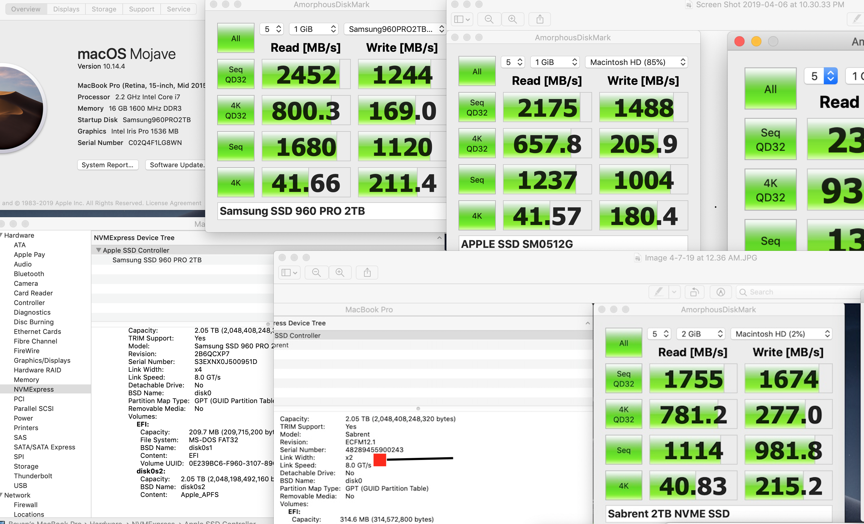

OK, I just did a new install on a Mid 2015 15 inch MBP
Replaced a 256gb SSUBX that came with the machine
with a 2TB Sabrent (Phison E12 controller, from the recent Amazon sale).

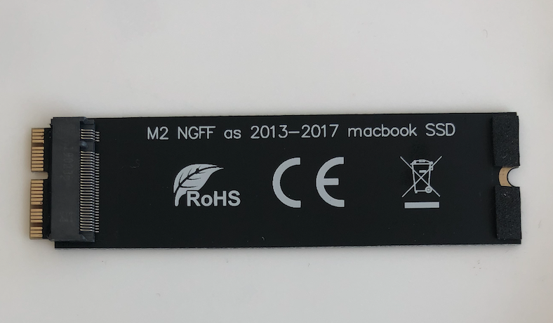

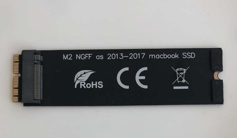

I used the "long black" Sintech adapter from Amazon (see picture below)
I did a Time Machine backup, took out old ssd, and rebooted into disk utility; formatted new SSD as APFS and then did a restore from time machine backup.
The original SSD had Mojave 10.14.4 installed, which was backed up on the time machine

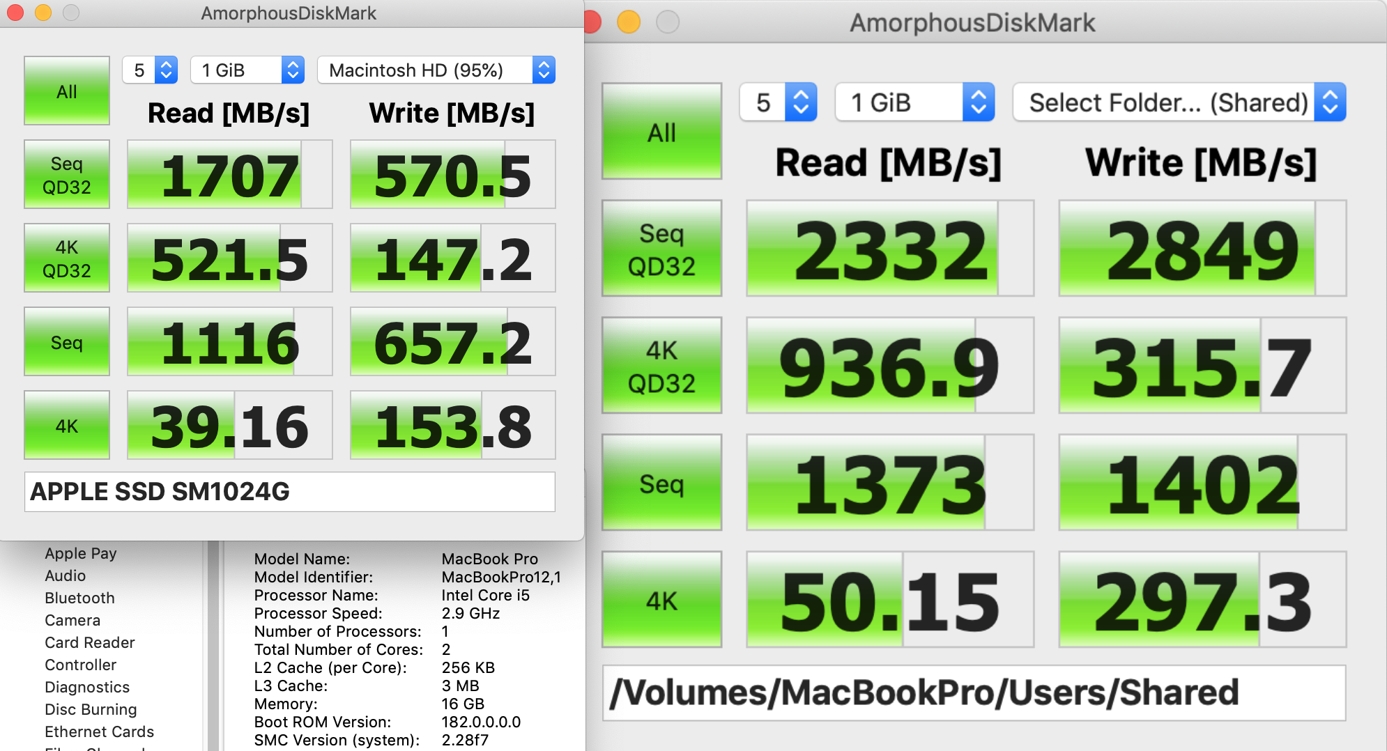

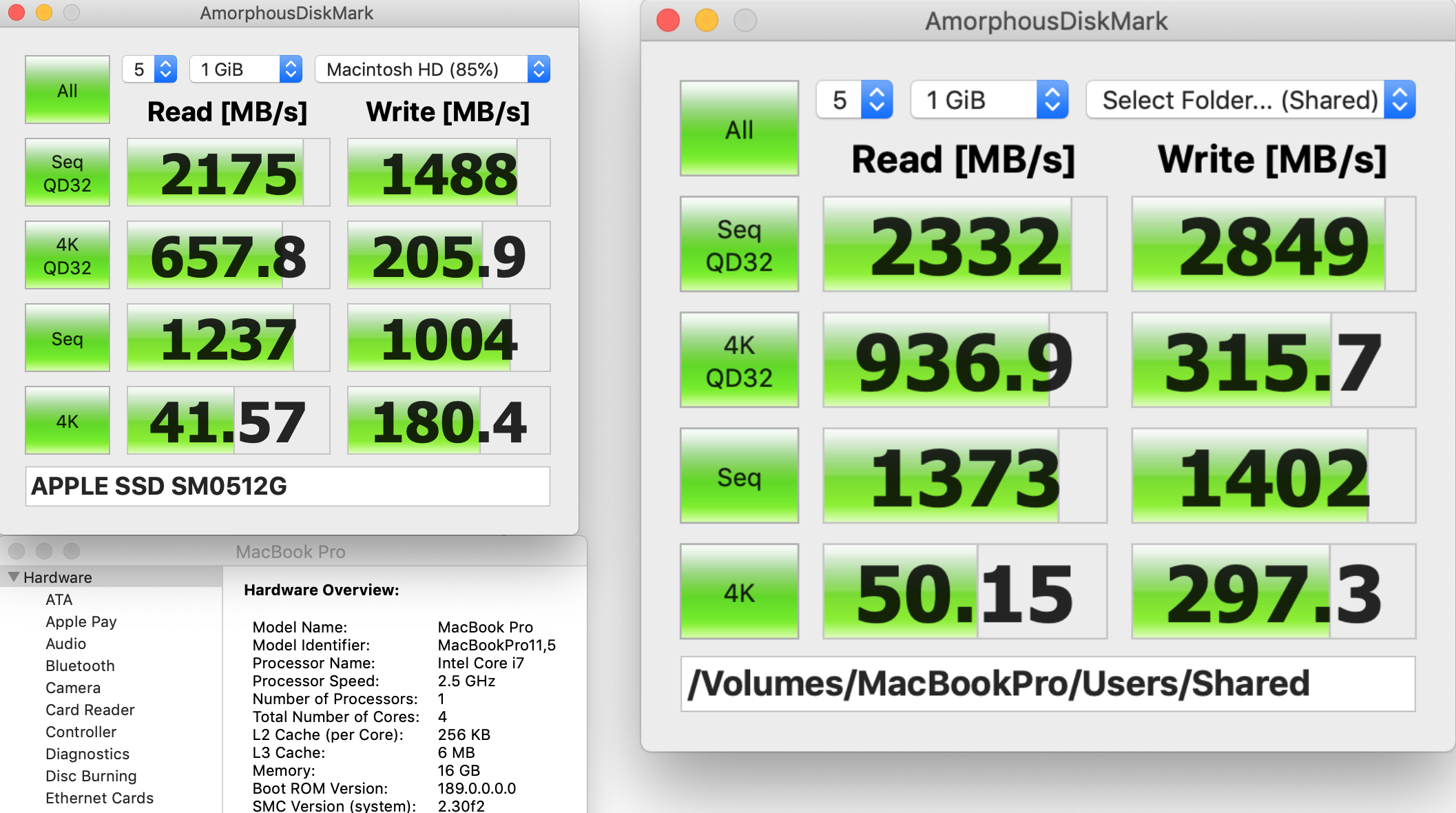

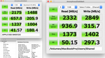

I benchmarked my 3 MBPs before I did the upgrade, just to have a comparison point (the HDDs/SSDs are different size and are also in different states of being filled):
All 3 MBPs are/were running Mojave 10.14.4

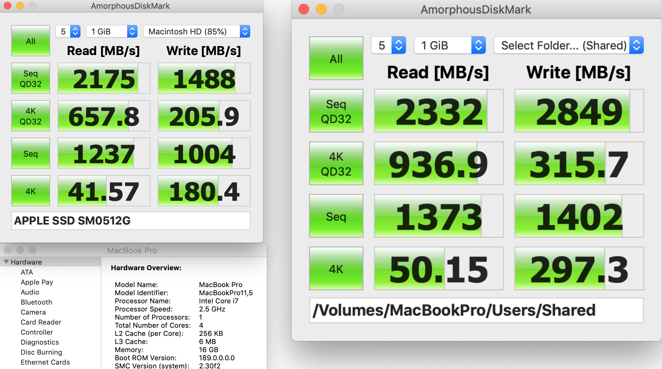

Early 2015 13 inch MBP (aka 12,1) has an original 1TB SSD, which I did nothing to (and probably won't touch)
Mid 2015 15 inch MBP (aka 11,5) with an original 512GB SSD, which I may upgrade in the future, if needed
Mid 2015 15 inch MBP (aka 11,4) with an original 256GB SSD, on which I did the upgrade.
Interestingly, the Sabrent appeared under x2 link width (and not x4) in the NVMExpress panel (see screenshots). The benchmarks themselves were "meh". Good sequental read and writes, random 4k read and write was basically no different than the stock Apple drive (remember sequental reads and writes are only good if you are transferring large files from one macbook to another - and even then you would need BOTH the machines/macs to have fast nvme SSDs for sequentials - otherwise, your speeds will only be as fast as the slowest link in the chain). If you have a 10gbE NAS link then YES, this makes a big(er) difference). I was more interested in increasing the random 4k reads AND writes.
I did NOT like the benches, so I decided to pull out the 2TB SSD, and install Mojave 10.14.4 as a clean install on the same rMBP mid 2015 (11,4) BUT I used a Samsung 960 PRO 2TB drive instead.
Did some benchmarking, and well..not that impressed (see screenshots).
The only thing different was that now I had a verified x4 link width under NVMExpress, which I did NOT with the previous install from a Time Machine backup.
Finally, I put the original 256GB SSD back in the mid 2015 rMBP for now, and left it there
I am planning on doing a clean install on a HP EX920 1TB SSD (which uses same Silicon Motion controller found in the Adata SX8200 SSD - not to be confused with the SX8200 PRO - that uses the newer controller).
Here are some screenshots ( I have used Earl Urley's post # 3861 as a reference in the screenshots)
Conclusions so far:
For me so far, the only real world benefit I see from an upgrade is SIZE of the SSD.
I would have loved to see a significant jump in the random 4k read and random write, which I did not
The Sabrent 2TB drive and the Inland professional 1TB which was referenced earlier use the same Phison controller, yet the benchies are significantly off.
Wonder what gives? I might just try to do a clean install of Mojave on the Sabrent 2TB and see if anything changes

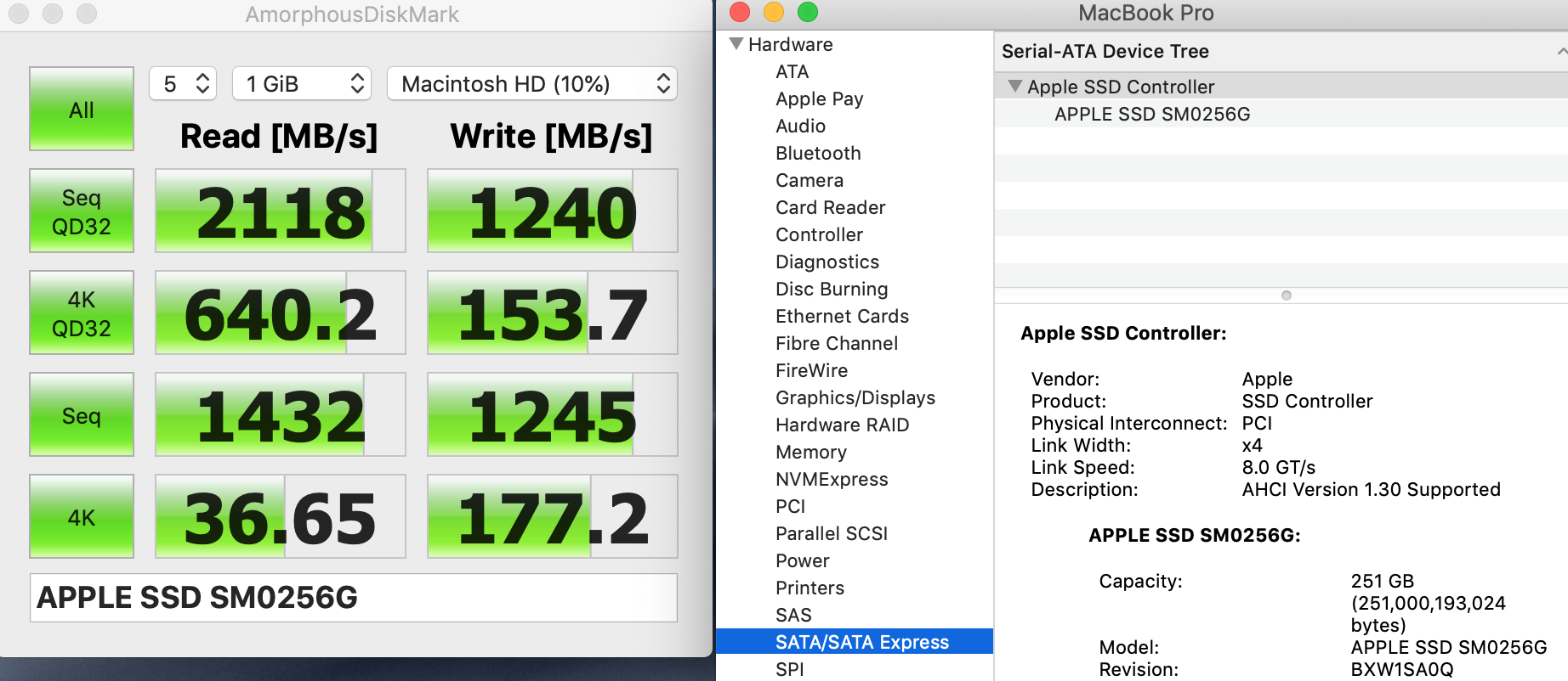

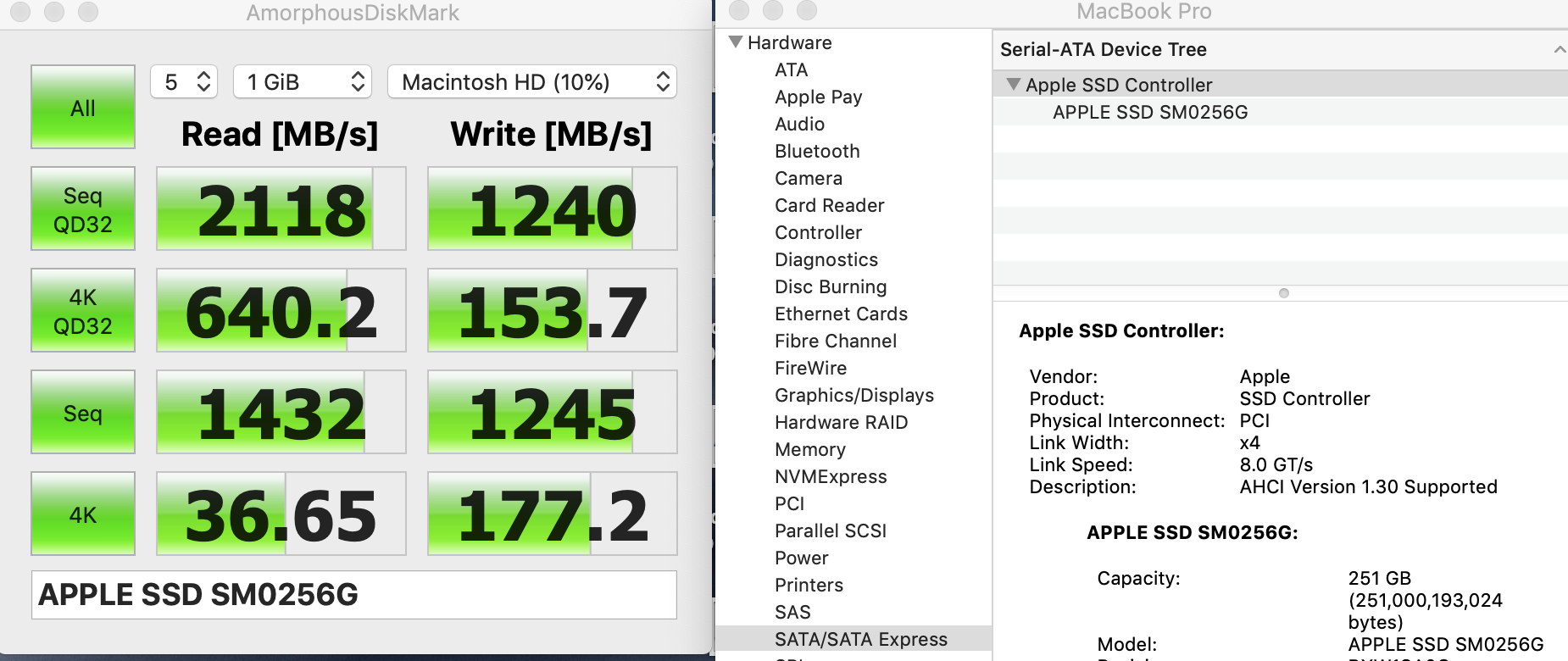

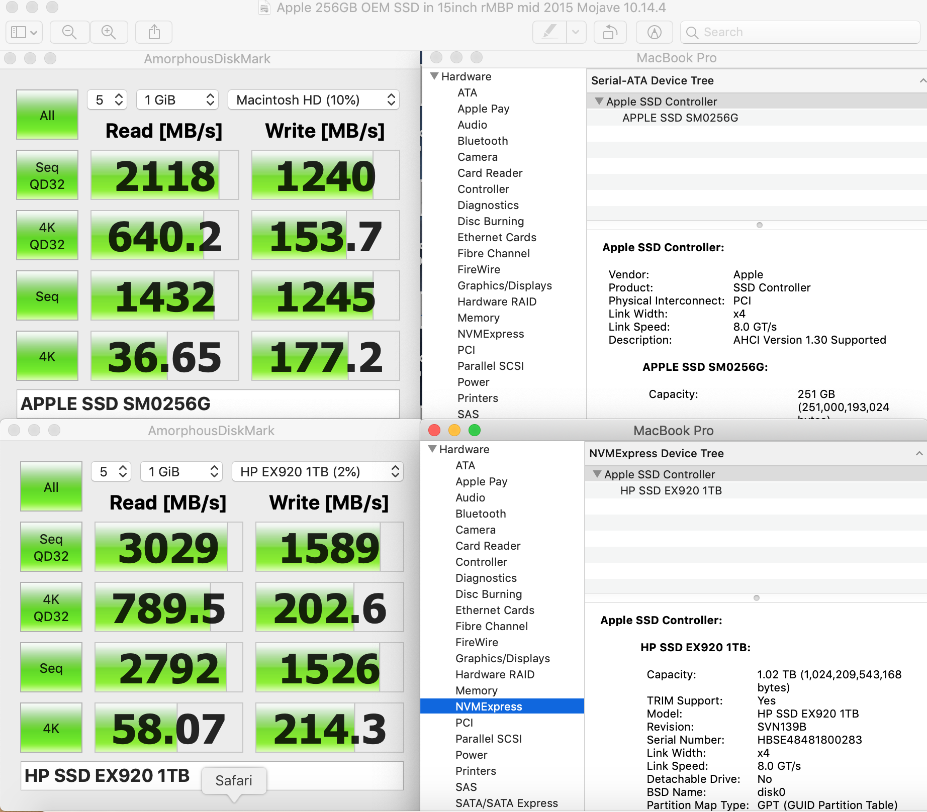

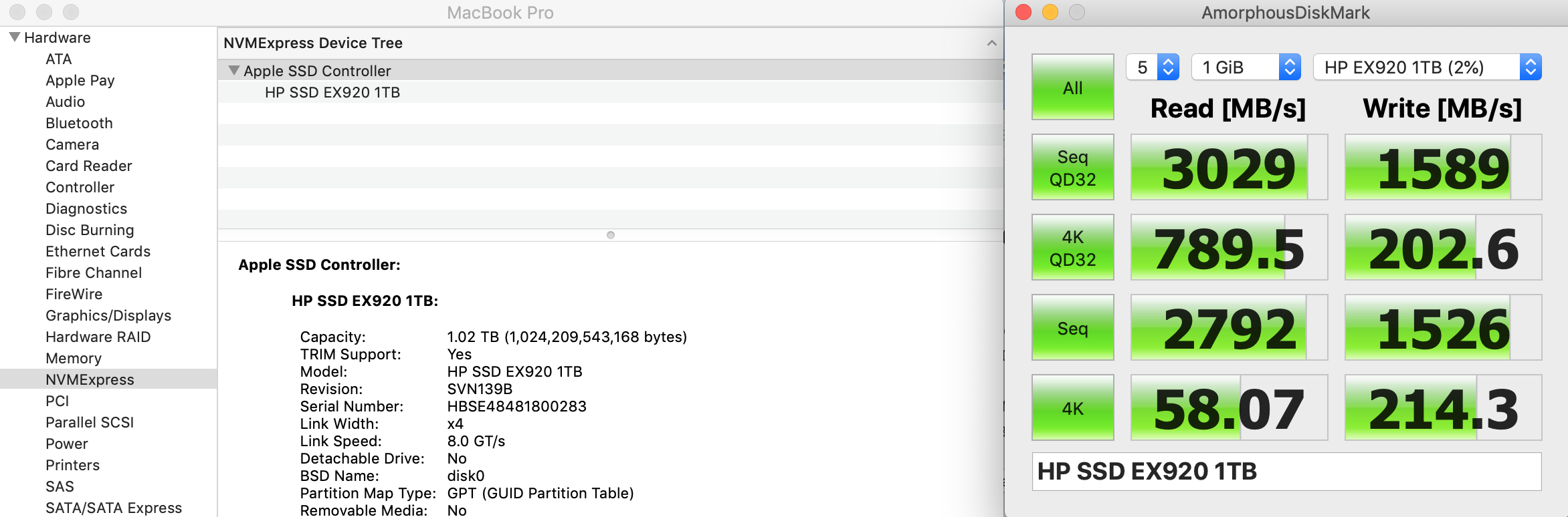

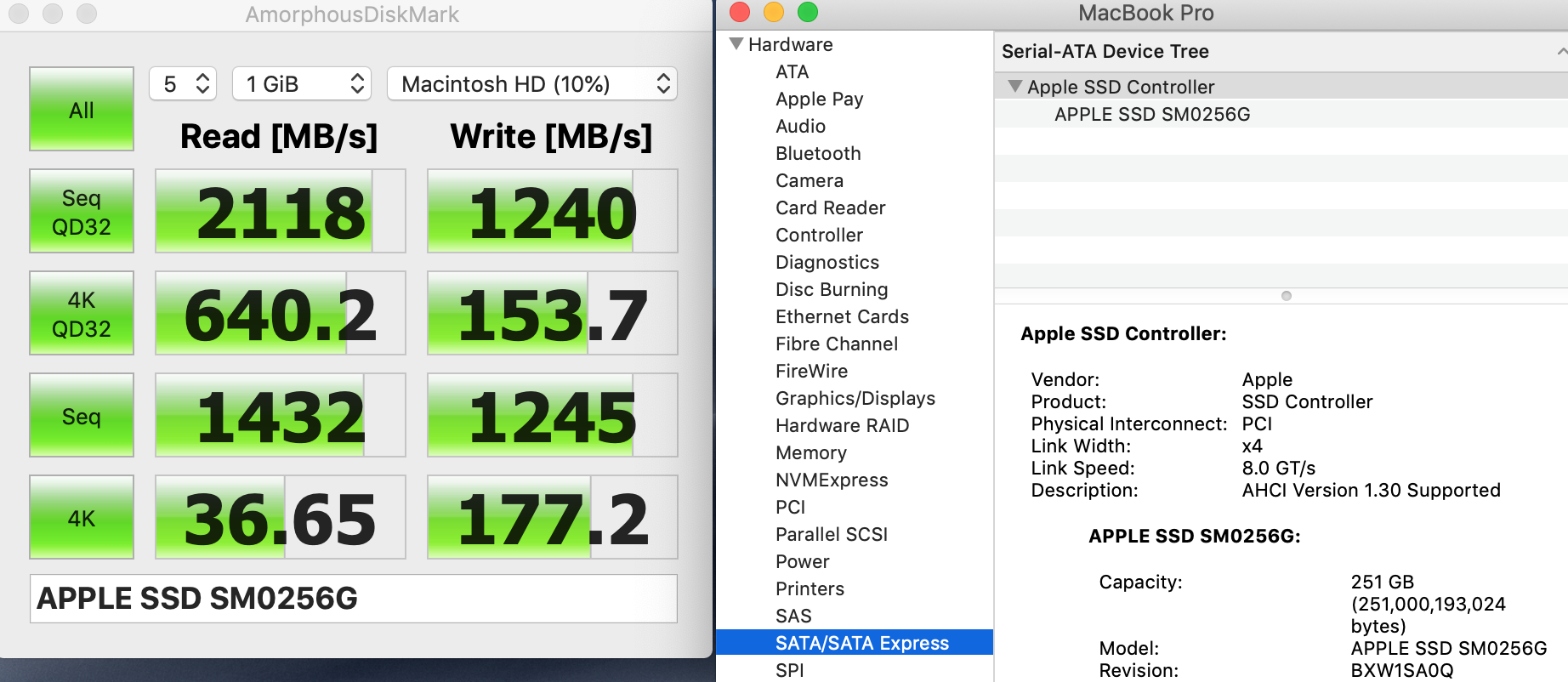

I did it!
I think I found a very good SSD - I have 2 x 1TB HP EX 920 (same controller as Intel 760p and Asdata 8200) on my PCs.
Figured I would try it on my rMBP mid 2015 15 inch with OEM Apple 256gb installed on it.
Getting very good 4k random reads and writes. And for the first time, broke the 3000MB/s sequential barrier (though only on QD32, which never happens in consumer circumstances).
The top result is the new drive; the other thumbnails are from my original post

@djangoreinhardt442
Nice!
That gives me hope that an EX 920 would also be good in the 13" 2015 MBP I have arriving tomorrow, despite only being at PCIe 2.0 in that machine of course
Yes, I think you should have hope.
Only thing you will be losing out on will be sequential reads and writes (will still probably get between 1200-1500MB/s on both)
Your 4K random reads and writes should be similar 🙂
The Silicon Motion controller in the EX920 is already over a year old.
The newer edition one (the one inside EX950 and the Adata 8200 pro) should give slightly better results (optimized controller but still same type of TLC NVRAM)

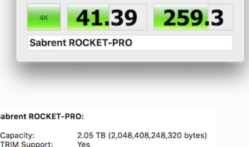

Hmmm...see now I think I must have done something wrong with the Rocket 2TB.
I think I am going to re-bench it via new install.
Btw, the benches above with Amorphous Disk Mark would show better number if you had ran the test 5x and with 1gb file instead !! I did about 20 benches last night and notice that if you only do 1x trial of the test, you write numbers are always lower.

What exactly do you write in Terminal to get the drive's power states? I tried the above smartctl, but it didn't work, is the syntax different?
Conclusions so far:
I did not do any power draw measures - the new SSDs were kept in the machine for Benchmarks only - so about 1-2 hours - and then replaced with the OEM Apple SSD
Can you explain or link to any info source what do those different measurements mean in reality (sequential, 4K, QD32 etc.). I tried to look at the software's website, but without success.
It made me think how relevant those benchmarked speeds actually are when instead of transferring a movie in 2-3GB/s (sequential I guess), when I transfer photos of size 5-10MB each, the speed drops drastically to like 30-50MB/s.

I've purchased a used 2013 Macbook Pro 15" Iris only and am expecting to receive a MyDigitialSSD BPX Pro and Sintech adapter in the mail today - not much discussion on this thread about that SSD, but it appears similar to the Sabrent Rocket.
Here is my mother of all benches.
I re-installed the Sabrent 2TB de novo: new OS on brand new drive - NO restore from backups.
Now I am getting correct link width x4, and not x2 as before.
So far, the trends that I am noticing are:
My Sabrent 2TB drive has very similar random 4k reads to Apple OEM SSD
It has better sequential writes and random 4k writes than the Apple OEM SSD
My Sabrent 2TB drive has higher sequential reads and writes than 1TB Sabrent drive in same computer (user Earl Urley's drive)
BUT
My Sabrent 2TB drive has lower 4k reads and writes than the 1TB Sabrent drive in same computer setup
Lastly, the 1TB HP EX 920 smokes them all, as far as I am concerned.
I wish I had a 2TB HP EX 950 to compare to.

Just for fun and to add more data, here are my scores on the same drive in my High Sierra Hackintosh
(8700/1080ti/Rocket 2TB NVMe)
