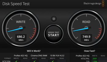

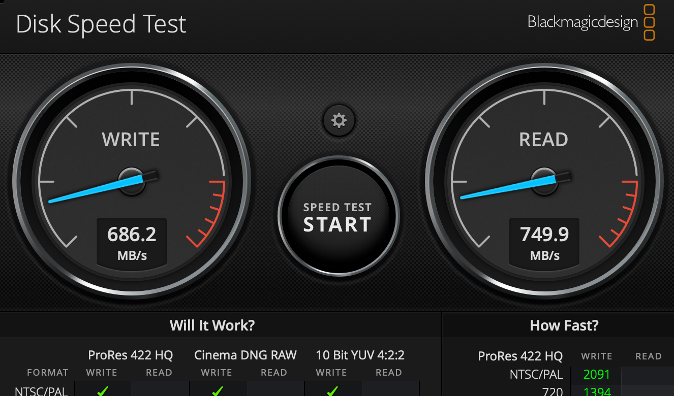

Early 2015 MBP Retina 13" owner here, Mojave 10.14.4
I am using a Patriot Scorch 512 GB (was about $80 at Fry's - price matched Newegg) with the short Sintech adapter
No crashes or instability so far
Performance is so-so... ~680 MB/sec write, ~750 MB/sec read (encrypted APFS file system)
Bootup times (after entering password) are a little longer than I'd like
Battery seems to drain fast when lid is closed...About 50% in 12 hours... I am researching the options available
Might go back to a traditional non-NVMe, SATA SSD, I would rather have the standby battery life than the performance trade-off. As it is this drive is just as slow as a SATA drive.
The 2013 to 2015 MacBooks don't use sata drives. They work with either PCIe ahci or nvme.
Have you tried using hibernate mode 25 to reduce battery drain with the lid closed? Tried adjusting sleep settings?
The slow read/write speeds may be caused by the use of encryption. I don't use encryption on my 2015 Air and this may be one reason the reads and writes are faster with my Intel 600p when compared to my air's stock 128 GB Apple SSD.

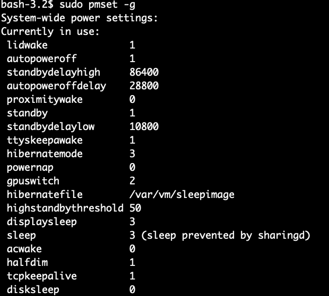

I've futzed with the hibernate and sleep settings to no avail, but I don't think I've tried hibernate mode 25. I think my hibernatemode is set to 3 right now. Here is my pmset -g output.
Here is what I saw when I put hibernatemode 25, is this going to be a problem??
Code:
bash-3.2$ sudo pmset -b hibernatemode 25
Password:
Warning: Idle sleep timings for "Battery Power" may not behave as expected.
- Disk sleep should be non-zero whenever system sleep is non-zero.
Warning: Idle sleep timings for "AC Power" may not behave as expected.

Ah, I was kind of fuzzy regarding the backwards compatibility of NVMe and SATA. Even though the SATA SSDs are keyed to fit in an NVME slot, they will not work. ):
These are the settings for my 2015 Air with an Intel 600p and I get no drain when I close the lid:
System-wide power settings:
Currently in use:
standbydelaylow 600
standby 1
halfdim 1
hibernatefile /var/vm/sleepimage
powernap 0
gpuswitch 2
disksleep 10
standbydelayhigh 600
sleep 1 (sleep prevented by installer, identityservicesd, identityservicesd, identityservicesd, identityservicesd, AddressBookSourceSync)
autopoweroffdelay 28800
hibernatemode 25
autopoweroff 1
ttyskeepawake 1
displaysleep 2
highstandbythreshold 50
acwake 0
lidwake 1
Code:
Password:
Go into settings and click on energy saver, click restore defaults. Then in terminal write "sudo pmset -a standby 0 hibernate mode 25" without quotations. What this does is it forces your mac into hibernate mode instead of going to sleep (Standby = 0) and this hibernate mode will write the contents of your session to the SSD and power off all components. Using mode 3 will keep the RAM powered on which will consume battery. Leaving standby = 1 tells the Mac that it should sleep for X minutes before going into hibernate, obviously with NVME being a higher powered drive the sleep state will consume more battery than when using the OEM SSD. The only downside of this is that it may take a couple of seconds longer to wake up from hibernate because you are using mode 25 but still a lot faster than a cold boot.

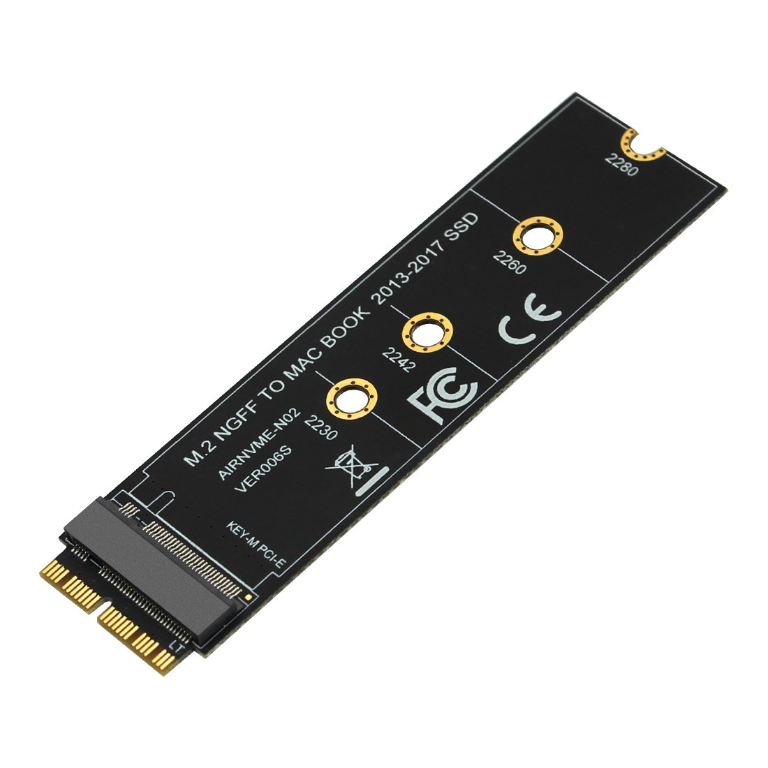

Guys, I could not find clear info on that, the wikipost is written when such model didn't exist I guess, so... Would be that adapter good? A1398 model
I suspect it could be a better solution as the structure is rigid and must not put any stress or displace the slot somehow. Who tried it, what are the results?
https://aliexpress.com/item/32996568898.html
I saw something similar to this on a YouTube tutorial video
Seems to work pretty well, if it is the same one
If you use a double-sided SSD, you may have to bend the the drive and/or adapter a bit to make the screw fit in as others have noted.
NVME drives are quite rigid and should be not a problem when using the short adapter.
