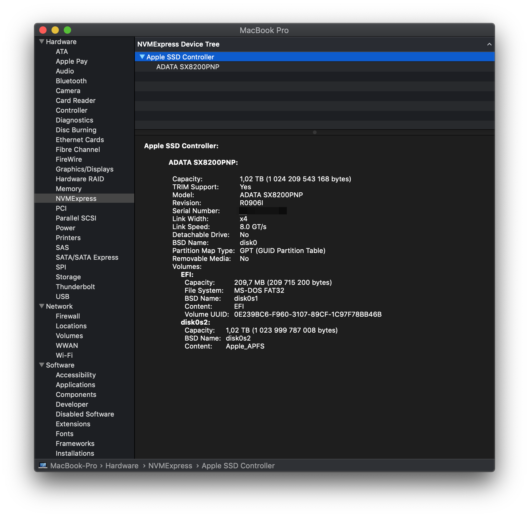

Hello guys,
I've just upgraded my MBP 15" mid-2015 (MacBookPro11,4) with SX8200Pro and I have couple of questions:
- I have long SinTech adapter, obtained via Amazon.de, and it comes with foam on which disk can lie + metal connectors are covered by some material that SinTech installed. My questions are how tight should be disk tighten? It bends a little and this scares me. Another thing is that SX8200Pro comes with small radiator so should I install it? Would be there any space for it? 😉
- Disk Utility claims my drive is not supporting SMART, while DriveDx (for which I have to pay for) is reading all attributes without any issues. Is this normal with PCI-E Drives?
- To upgrade FW in the future I should have bootcamped Windows, don't I? 🙂

Hello guys,
