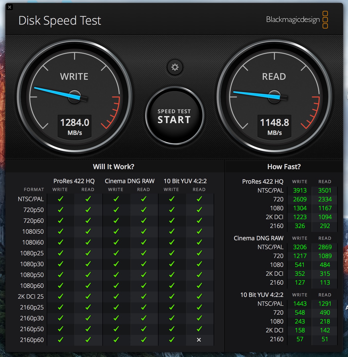

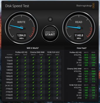

I've got a MacBook Pro 15" mid 2015 base model without GPU and I'd like to upgrade to a 1TB drive.
I'm trying to decide between:
  1. Sabrent Rocket
  2. Intel 760p
  3. Samsung 970 Evo (Pro)
  4. WD Black SN750
From the Sabrent I already saw that I performed very well, but I'd like to know how they compare in terms of heat, power and speeds. I especially like to hear about experiences with the Intel 760p. WD Black SN750 seems to have good speeds, but I'm worried it'll be too hot and draw too much power. If there's any better suggestions that'd be great!
Thanks in advance 🙂
My current speeds (on a pretty full disk)

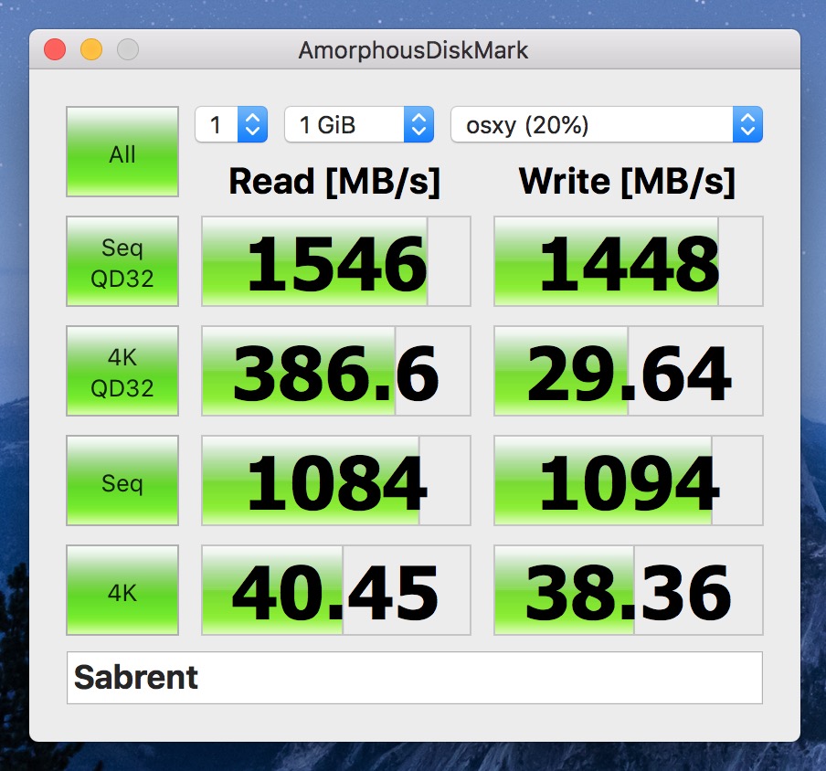

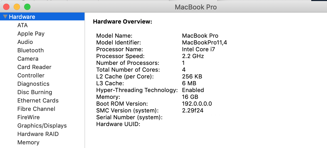

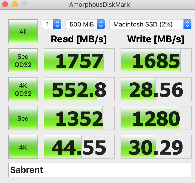

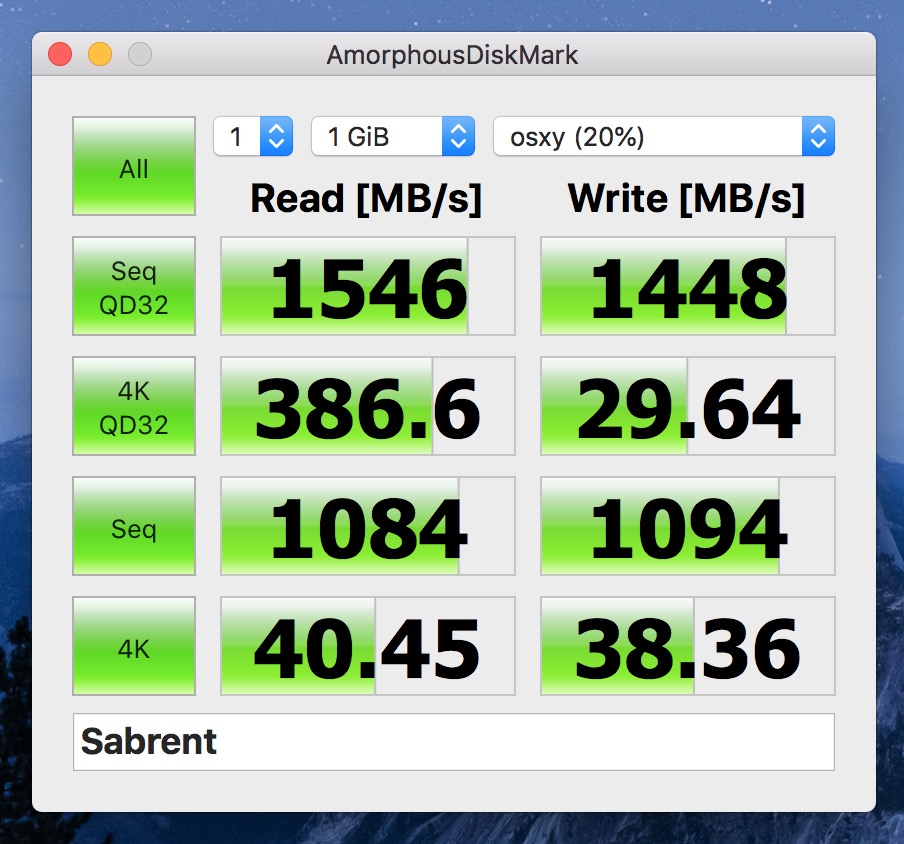

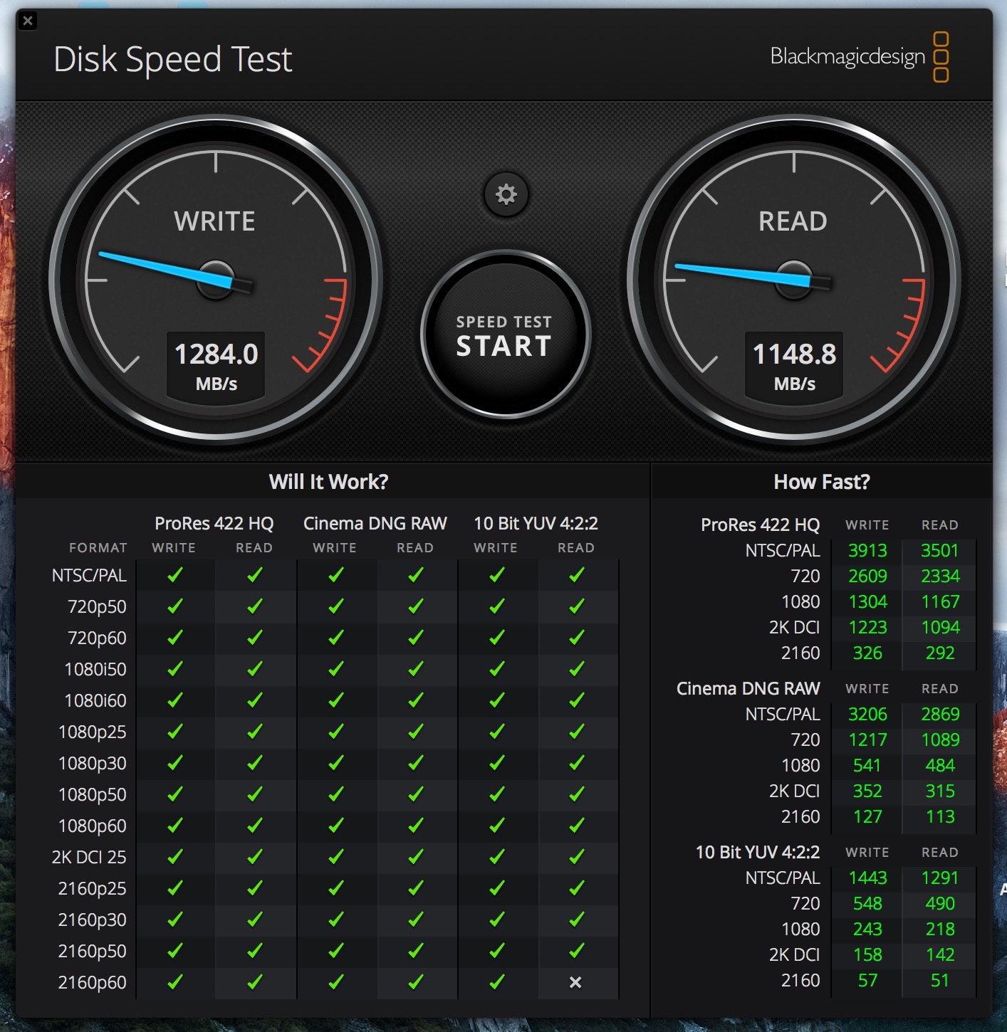

Hi all,
I have base MacBookPro11,4 2015 15" and recently installed Sabrent Rocket 1Tb drive. So far (a few days) got no issues with sleep, booting and even I used CCC and cloned macOS from old drive to one partition
I've run AmorphousDiskMark and here comes the question - is this random 4k QD32 speed ok for Sabrent? One more strange thing - the bigger size (100Mb->4Gb), the slower speed is, bench for 4Gb even stuck for 20 mins. Old drive (Apple, 512gb but from the MacBook13.3 2014) gives me 640read/710write but about 50Mb/s for 4k QD32 random write with 1Gb, the same speed with sabrent is 16-27Mb (27Mb/s on first run, 16Mb/s after a few benchmarks, may be due to the temperature?)
I've attached a few screenshots (they are for different volumes, because I wanted to eliminate file system factor - it looks like APFS is slower for random read/write). The ones with 4k qd32 > 20Mb/s are for 50/100/500Mb), for 1Gb it is 16-27Mb/s

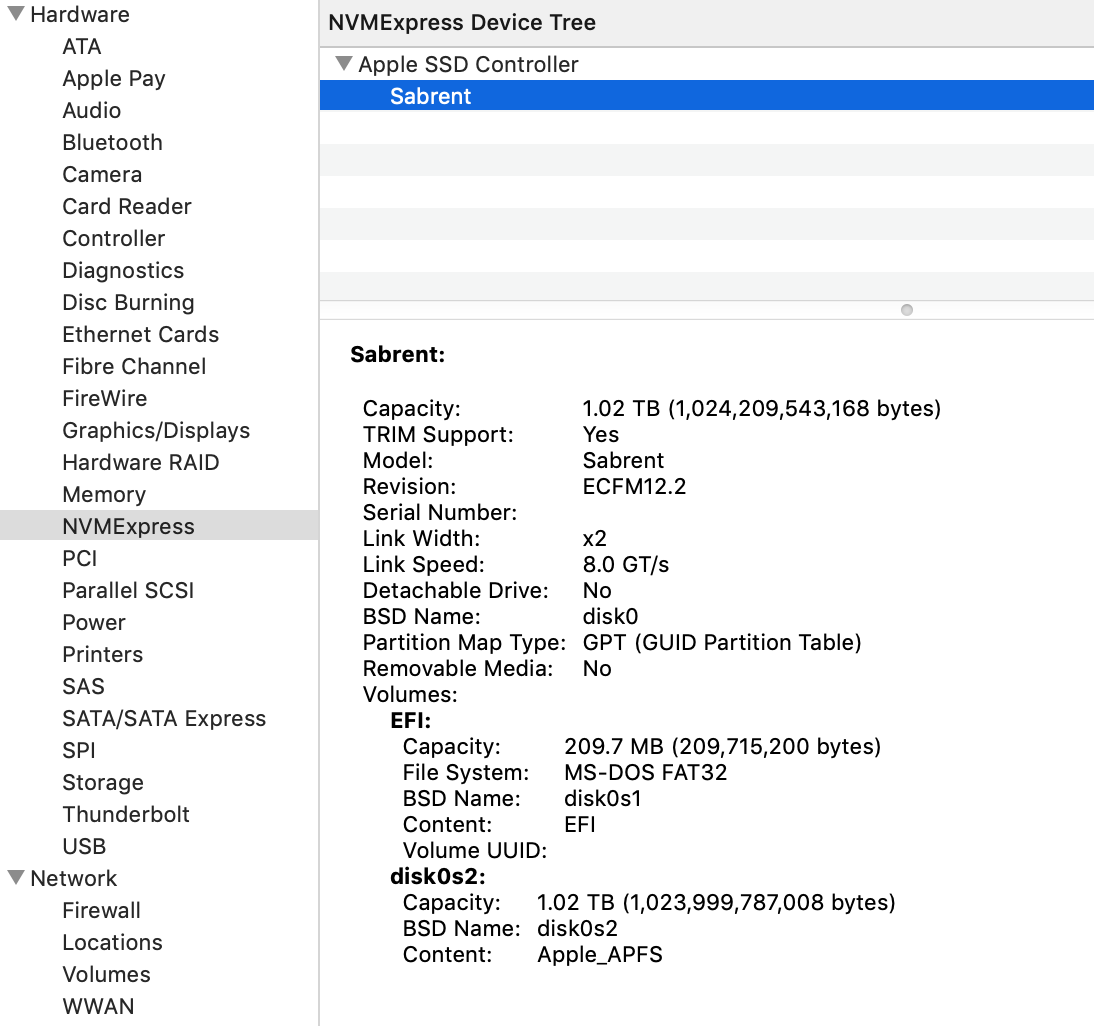

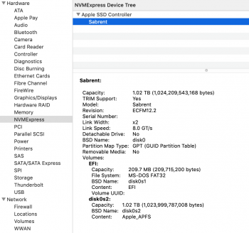

I am using the same SSD with the long Sintech adapter in my MacBookPro 11.5 2015 15". It is a i7 2.8ghz model. But I am only getting half of the performance. When I checked system information it shows I am only getting x2 link speed. Is there anything I am missing. Any help would be appreciated!

Sounds like a small cache, if you write bigger files the buffer can't keep up. What's the temperature that you're having?
In my experience so far, I guess that link x 2 has insufficient pin isolation on the adapter. In recent sintech adapters, an insulating tape is attached to the pin portion to prevent electrical interference with the connector cover on the logic board, but the insulation may still be insufficient. How about taking measures such as sticking Kapton tape?
Don't you get any error at Apple Diagnostics, especially PPN001?
Thank you! I reseated the adapter and it now shows link x4. The speed increased though still not as fast as I would like it to be. I am getting read 2000MB/write 2850MB — kind of odd that write is so much faster than read. Also the lanes don’t seem to be utilized any close to the maximum level.
Indeed there were some exposed parts of the pins possibly touching the metal part of the socket. I just ordered Kapton tape to further insulate them.
Thank you for your suggestion!
