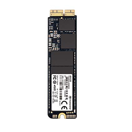

Hi all! Haven't posted here before but figured this would be the best place to start with my current SSD-related drama.
I was getting fed up of only having 128GB of space on my Early 2015 13-inch Macbook Pro, so after a bit of looking around I went for a 480GB Transcend JetDrive 825 - though having read this thread I see now that might not have been the best idea!
However after I performed a Time Machine backup, opened up the laptop to swap the SSDs and booted back up into recovery, I ran into a problem that I've not been able to fix. I can't see the drive listed anywhere, either in Disk Utility or by running "diskutil list". I double checked the drive by taking it out and putting it into the provided Thunderbolt enclosure and macOS could see it with no problem, but after putting it back into the M.2 slot again Disk Utility couldn't see it.
Some other things I've tried:
  • Cloning the existing SSD using Carbon Copy Cloner - the drive still isn't seen by the Macbook, so I get a folder with a question mark
  • Formatting the drive as both APFS and HFS+ - neither of these seem to work
  • Installing an older version of macOS onto the Jetdrive - tried this with both Yosemite and High Sierra, both could not be seen
  • Installing macOS on an external drive, booting to the external drive and cloning onto the JetDrive in the M.2 slot - suggested by Transcend's support, OS booted fine on the external drive but still couldn't see the JetDrive in disk utility
  • I also used a bootable Linux USB to see if the drive could be seen, but again it doesn't show up at all
My suspicions are that there's something missing in the way of firmware that's stopping the drive from being seen in the M.2 slot, but doesn't affect it in the Thunderbolt enclosure. However macOS was fully up to date already, and there was no newer firmware available for the JetDrive.
Sorry for the long post, I'm reaching the edges of my ability/temper with this and now I don't really have a usable Macbook, so I would be very grateful if anyone had any other insight ideas! Thanks in advance!

You confirmed that the MacBook is running the latest bootrom?
Have you tried booting into internet recovery to see if disk utility detects the drive?
Thanks for the reply! I've checked my BootROM version and it's 184.0.0.0.0, and my SMC version is 2.28f7, both of which seem to be correct for my Macbook.
I've tried both standard and Internet recovery and I can't see the drive in either, sorry I probably should've mentioned this in my first post!
You are welcome.
The disk utility version is the version included with the latest version of Mojave?
Have you tried installing from a 10.14.5 usb installer? I doubt it will make any difference.
Are you able to install the os to the drive while it is installed in an enclosure?
Are you able to try the drive in another MacBook?

Sorry for the delay, managed to leave my charger at work so had to go and grab it!
I created a new 10.14.5 USB installer and still can't see the drive in Disk Utility, I would assume that creating a new USB means I'm using the latest version.
I am able to see the JetDrive in the enclosure, and I managed to install both High Sierra and Mojave onto it like this, but as soon as I put it into the m.2 slot in the MacBook it doesn't show up at all. This is why I'm wondering if there's something missing from either the drive or the MacBook that means it can't be detected in the m.2 slot, but unfortunately I don't know anyone with a Macbook that'll take the SSD so I'm not really sure what else to try. 🙁

The JetDrives don't come with adapters, they're designed to fit the proprietary slot type for the Apple SSDs, unless you think it might be an issue with the slot itself?
I'm currently waiting for Transcend to get back to me and see if they have any ideas, but failing that I'll probably return it if possible as RedTomato suggested, and try a different SSD mentioned at the top of this thread.
Thanks again for helping me out, let me know if you have any more ideas 🙂
My apologies. I incorrectly assumed the drive had a standard nvme connector.
Is it possible that the drive needs a firmware update?
Reactions: BanjoBoy
No worries! And that was one of my first thoughts, but I installed the manufacturer's software and it said the firmware for the JetDrive is the latest version.
I'm kind of thinking something's missing on the MacBook itself that's stopping it from seeing the drive, but I suspect Apple will be reluctant to help me given what I'm doing...!
