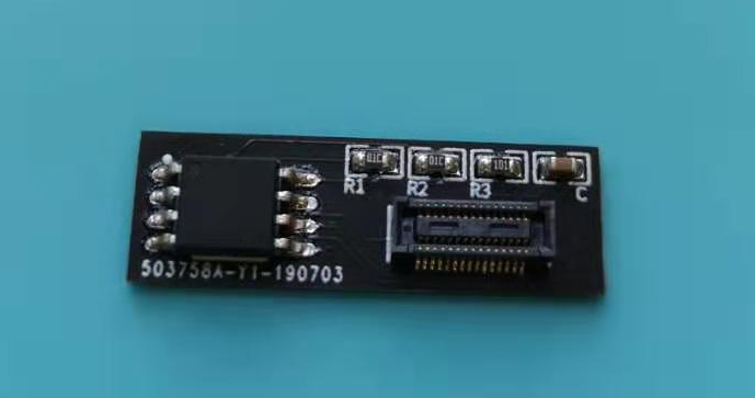

I'm in China, I designed a matt card myself, solved the hibernation bug and it cost about $30.

I was looking at the mattcard as an option. It wasn't clear to me though if the mattcard is pre-loaded with a rom or if I can load my modified rom? I wouldn't want to get the mattcard and only have it "unlock" my mac, since I don't need that.

Mattcard is a slave bootrom, you can write a modified bootrom, I'm not a salesman and I don't want to sell it. This is just my research work.
Sad to hear you're not intending to distribute these... Would love to get my hands on one, you won't hear from me again asking for support or whatever...
If you really need it, maybe I can make a few cards and try to sell them. The cost about $20~25/pcs plus shipping $14.
Note that only MBA6,2 MBP11,1 MBP11,2 MBP11,3 are currently available.
