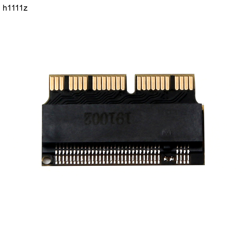

Hi,
i have buy SSD M.2 NVME CRUCIAL P1 1 TO, for my macbook air 2014. my boot rom is 117.0.0.0.0 it's good ?
i have MacOS Mojave installed.
this adapter it's good for my SSD ?:
how can i resolv hibernation problem ?
sorry for my english it so bad.
The adapter looks okay.
You may need to add kapton tape to prevent the logic board's metal shield from touching the adapter's contacts.
Yes, the bootrom is fine but I recommend updating to the latest version of Catalina before installing the SSD. By installing the latest Catalina, it will update the MacBook's bootrom to the latest version.
You can only resolve the sleep problem by installing a modified bootrom.
Your English is fine, no need to apologize.
