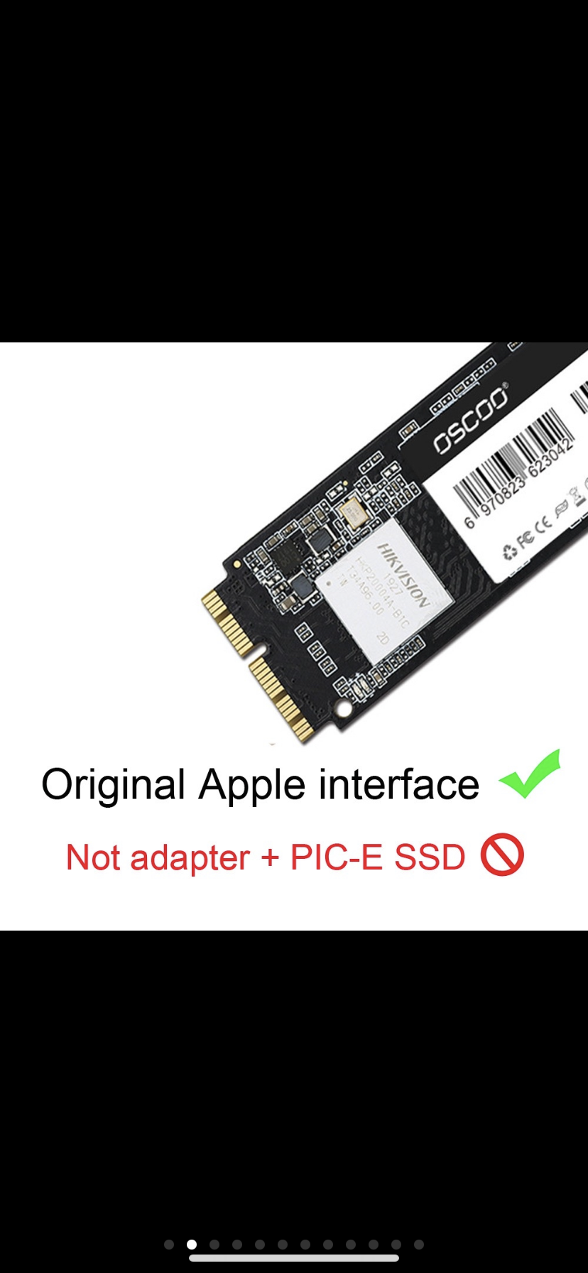

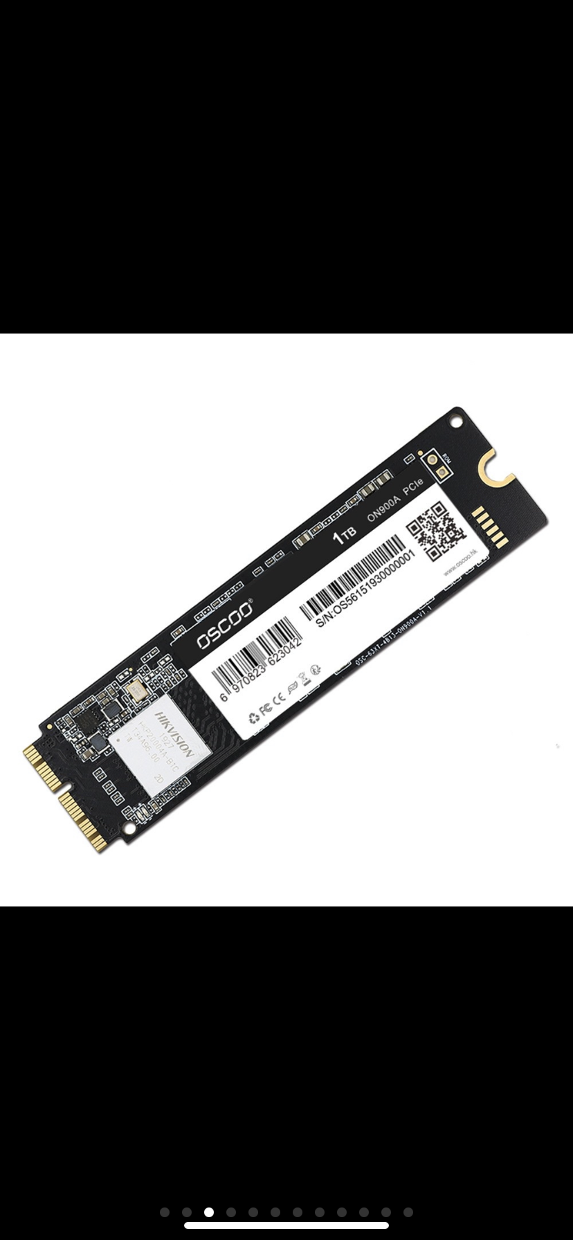

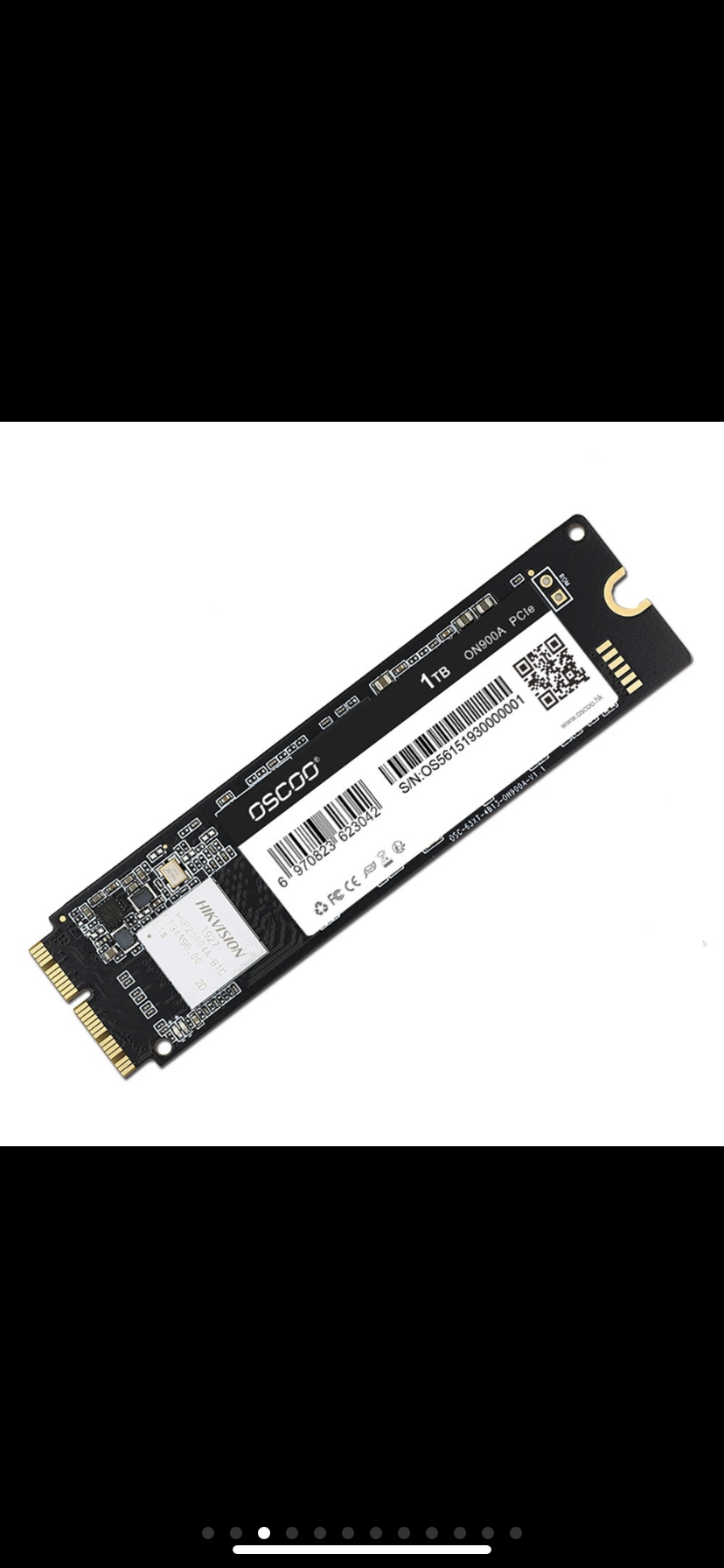

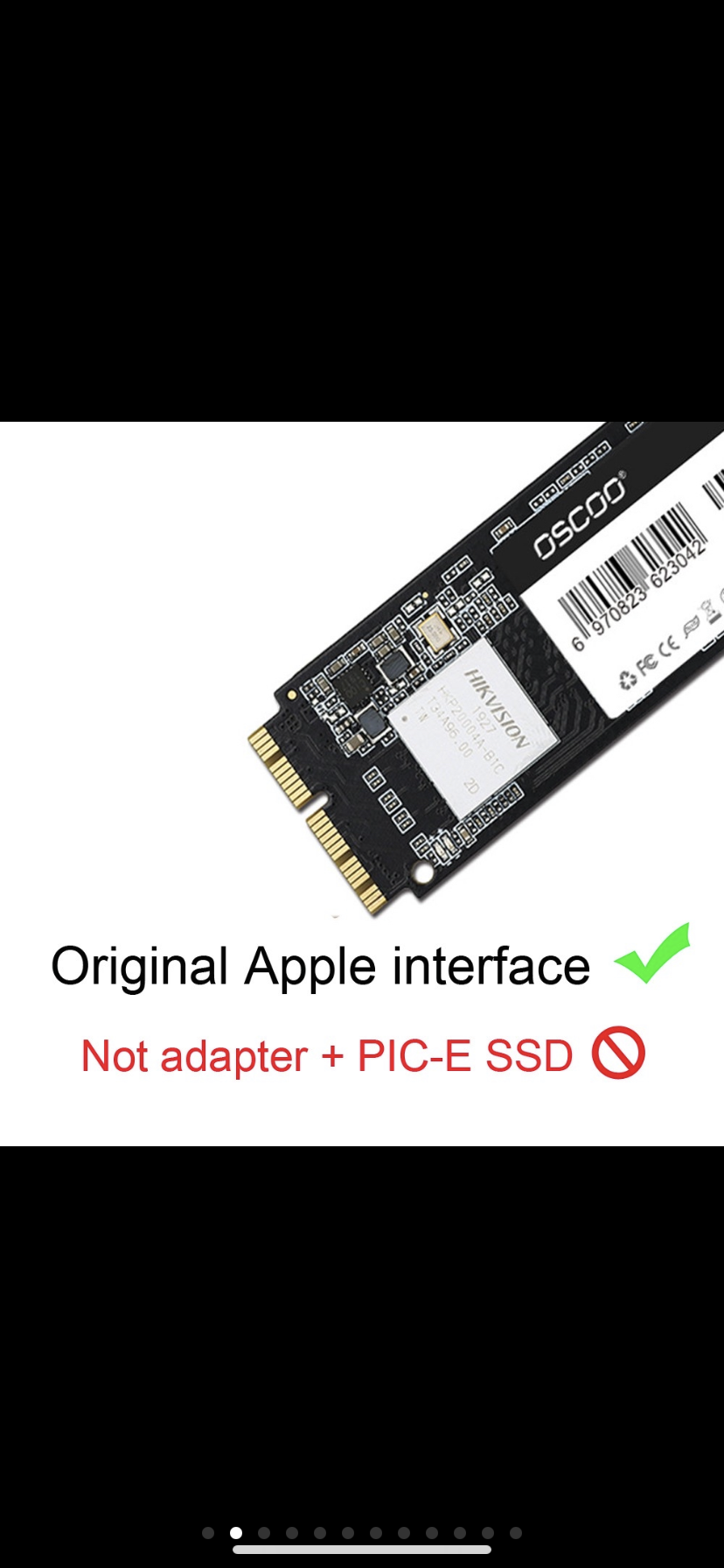

What do you guys thinks of this one?
R-2000mb/s
W-1600mb/s
