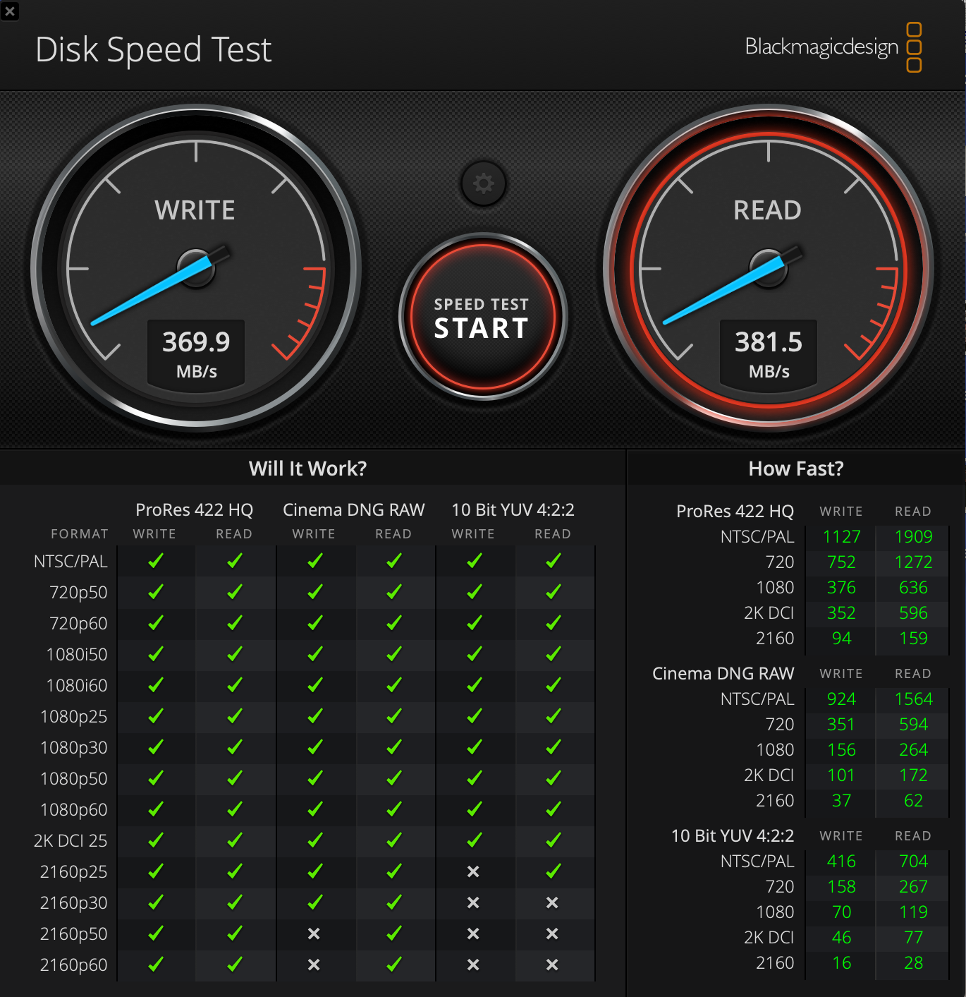

I have an early 2015 MacBook Pro 13' with 8gb ram with i5 2,7ghz processor and swapped the 128 gb apple ssd with the crucial p2 500gb using Sintech long adapter. Before that I updated the Apple SSD to Big Sur and bootrom is 425.0.0.0.0
What I ve done is formatting the p2 apfs and installing Mojave using a bootable usb.
My problem is slow write and read speed. In Blackmagic test write and read speeds are slower than Apple SSD and drops within seconds dramatically. Are these speeds normal or am I doing something wrong?
first
after 20 seconds

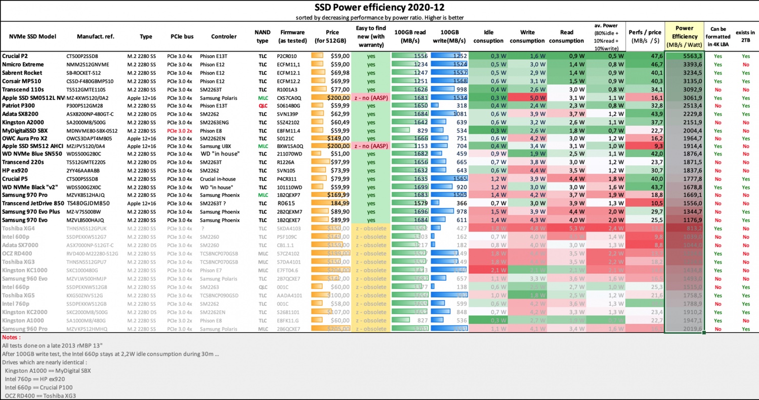

alright guys, help me out.
the 1tb ssd's that are available in the market for me are.
1. WD SN550 1tb
2. Crucial P1/P5 (P2 is available in 500 gb only : /)
3. Kingston A2000 1TB
4. Seagate Barracuda maybe ?
5. Samsung evos (i dont they are good here)
6. silicon power stuff maybe?
7. Intel 660p (not so keen since they are QLC)
What would you guys choose, knowing what you know now ?
