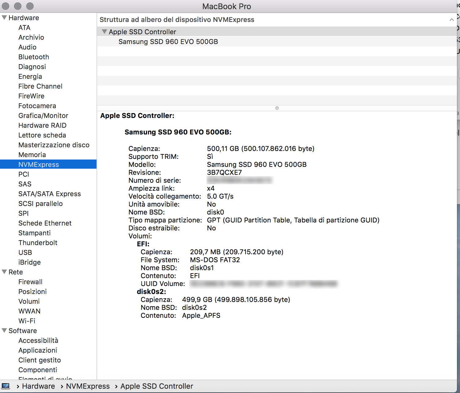

Ho guys, i've a problem.If i run in recovery mode i cannot see the 960evo...
I have created a partition for the 960evo like suggested in this video
using a live USB Ubuntu.
Please help
Update:
I've re-cloned my Mac with Carbon Copy Cloner (Just to bè sure) and reboot the Mac with the external hdd connected.
At the boot sound ivei pressed CMD+R ...but instead of release instantly i've continue to Press a few seconds. Now, instead of the world spinning recocery icon , that allows to download the recovery partition from wifi, starts the recovery from the usb cloned drive!Now i can see the SSD installed but cannot restore the cloned drive, wasn't selectable. I solved re-initializing again the SSD, setting ad Mac OS journaled and now i can select the clone from external drive a restore the system!
This video was useful !
I'm still waiting for the ending restore process
Thanks for your answer!Strange, but im sure that i press only CMD+R...however i've just online with my new EVO after 1h.45min of restoring! 😀
There are some command to prompt to prevent some issues?
Thanks ^_^
UPDATE: Already had 4 crashes...is possible to solve?! :°(

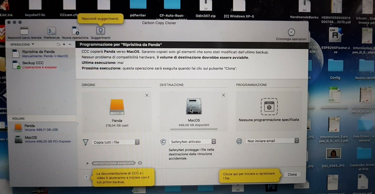

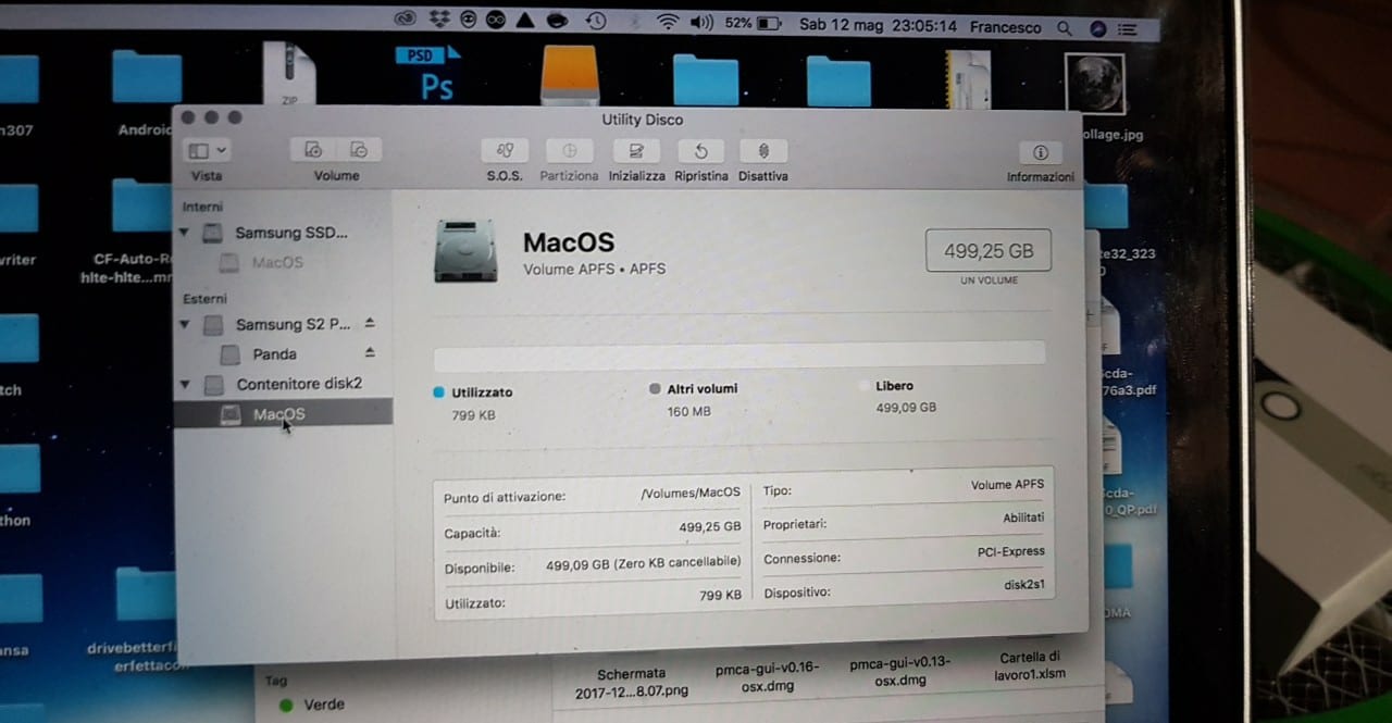

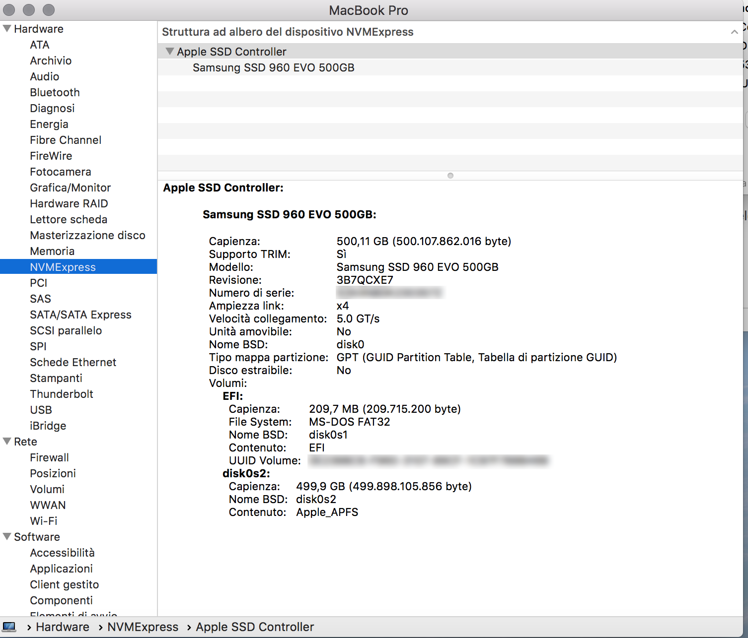

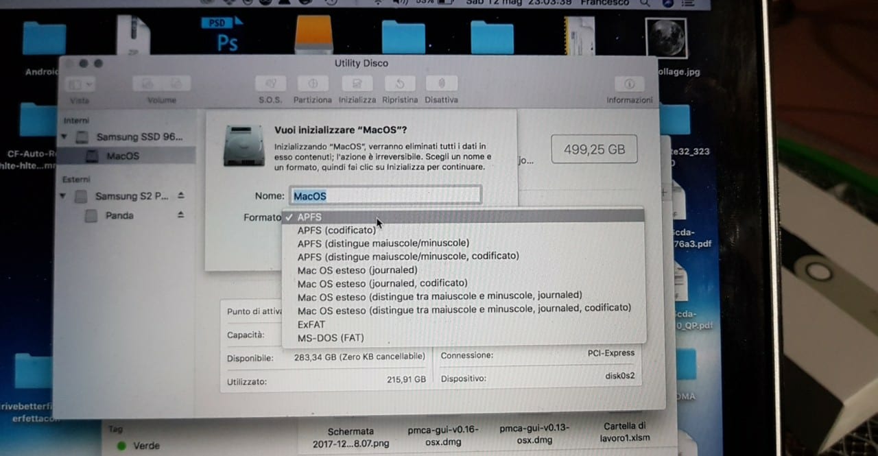

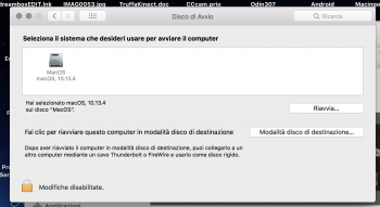

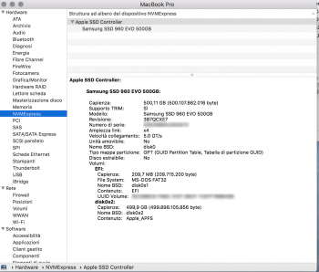

I've to thanks the amazing help of @gilles_polysoft 😛 for the step-by-step help he give me last night!

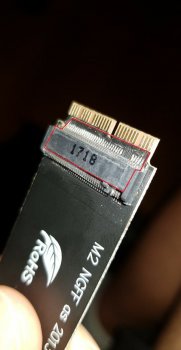

These is what i've done for my MCP 13" late 2013 and 960evo

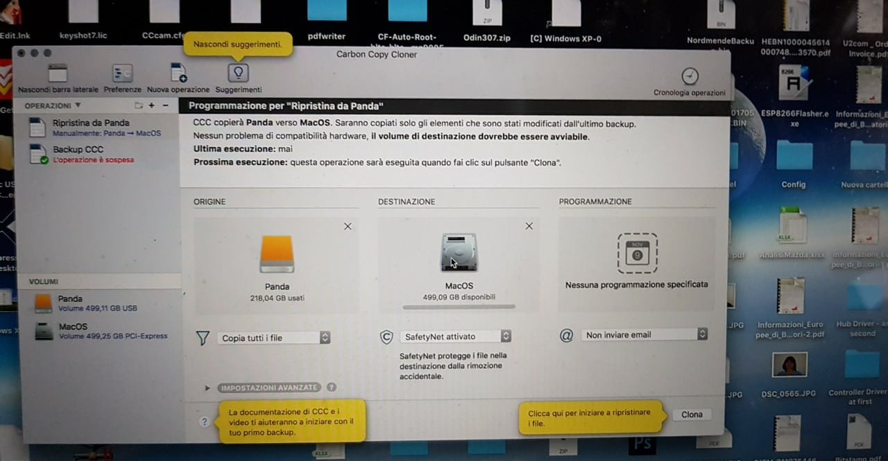

  • Prepare a clone of MacOS with Carbon Copy Cloner on a free hdd. In my case i've used a 500gb standard hd.

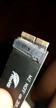

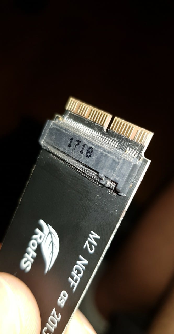

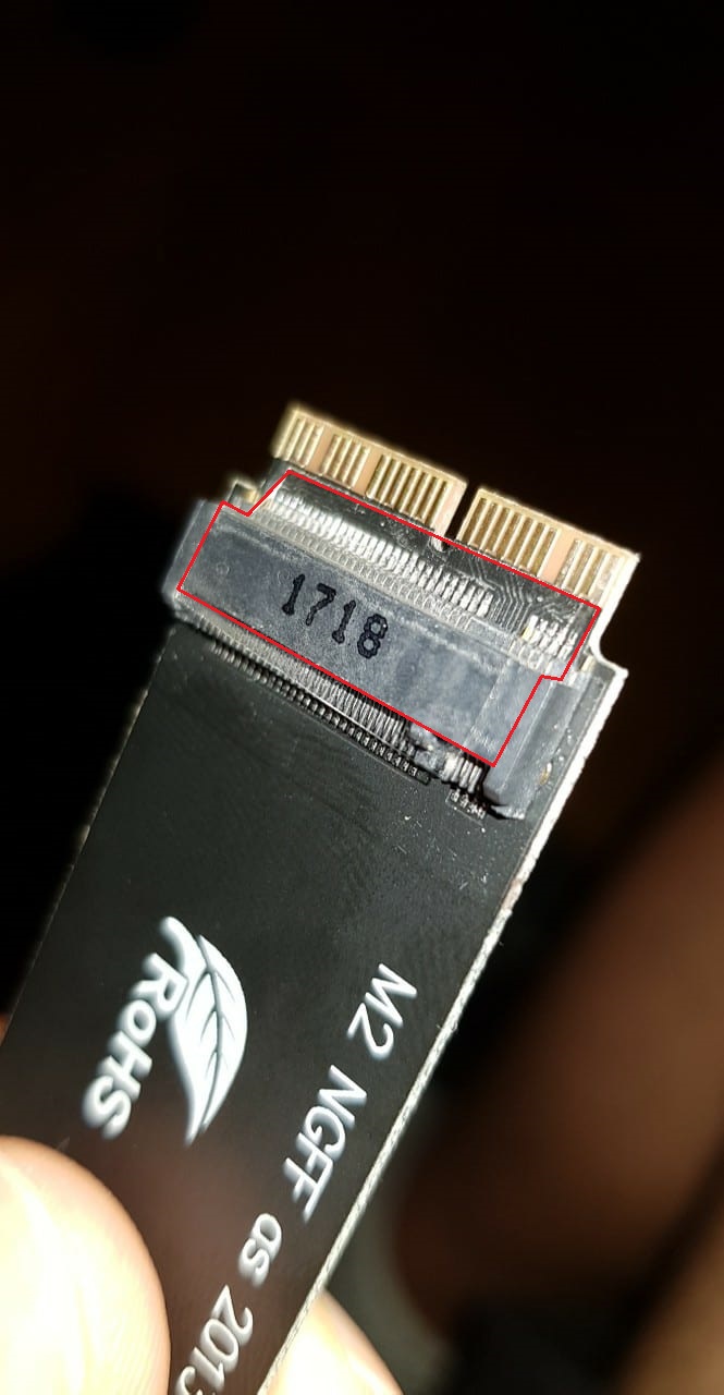

  • Put a piece of tape on the connector like in the image tapeAdapter.jpg . The tape shall be placed from the top end of the contact that shall be placed in the connector inside the mac to prevent these can be in touch with the metal connector of the macbook itself.In my case i've used a Sintech adapter (black long edition)
  • Dismantle the MacBook and place the adapter with the 960evo and link the external drive with clone MacOS.
  • Run the MacBook using the ALT command and select the clone external drive, in my case was the first yellow hard drive icon to the left.

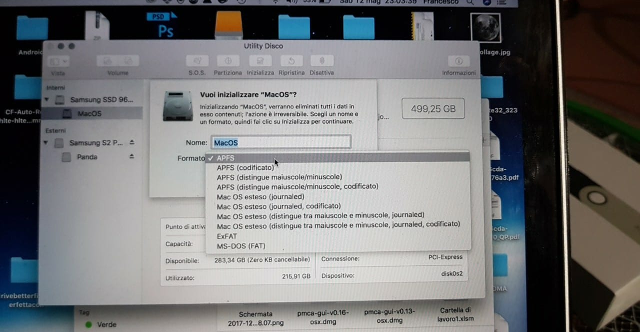

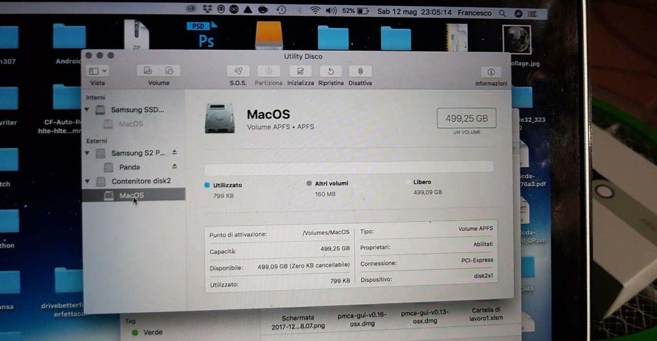

  • Once booted, it can took a while depends of the speed of the drive itself, go to DiscUtility and format the SSD like in the following image formatSSD.jpg . So select the volume, not the entire SSD, and select:
    • Format : APFS
    • Schema : Guid partition table
and click initialize. After the finish you should have something similar to the finishedFormatSSD.jpg​
  • Now we have just to restore the cloned drive with Carbon Copy Cloner itself ,select the external hd as source and the SSD as destination, like in the image restoreCloned.jpg and wait. SafetyNet won't do anything because the new hard drive (MacOS) is empty. In my case it tooks about 3 hours to restore all the things.

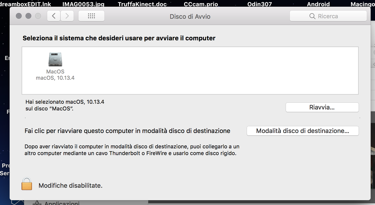

  • Shut down the macbook and remove the external hdd, now the Mac shall boot from the internal SSD. Once is booted select in System Preferences - Boot Disk the ssd as boot device.
  • Type in console the command "sudo pmset stanby 0" to prevent the full hybernation and it shall be all ok. In the image theFinalSituation.jpg there is visible how now is the SSD after all the things done.
Again an HUGE THANKS to @gilles_polysoft for helping me. Now i've to test my MacBook if all is ok.
If @gilles_polysoft had not helped me, I would have started the practice to return the 960evo to Amazon on monday.
Hope this helps, waiting for @gilles_polysoft 🙄 corrections to my process if there are.

Hello Francesco,
thanks a lot for your update, hope everything is ok now...
The main problems you had were due to wrong advices in the following video :
unfortunately, there is some errors in this video :
- the author doesn't speak of kapton tape insulation (we all know here this is a pre-requirement for stable use)
- he advices a M.2 adapter which is known to cause reboot issues on Samsung drives
- he advice to format to HFS+ which is unfortunately an error with Samsung drives... it gives kernel panics.
Samsung drives only run well on APFS as of today.
I wanted to ask, do we need to do this with the Longer black adaptor, if yes, what needs to be done?
Thanks!
