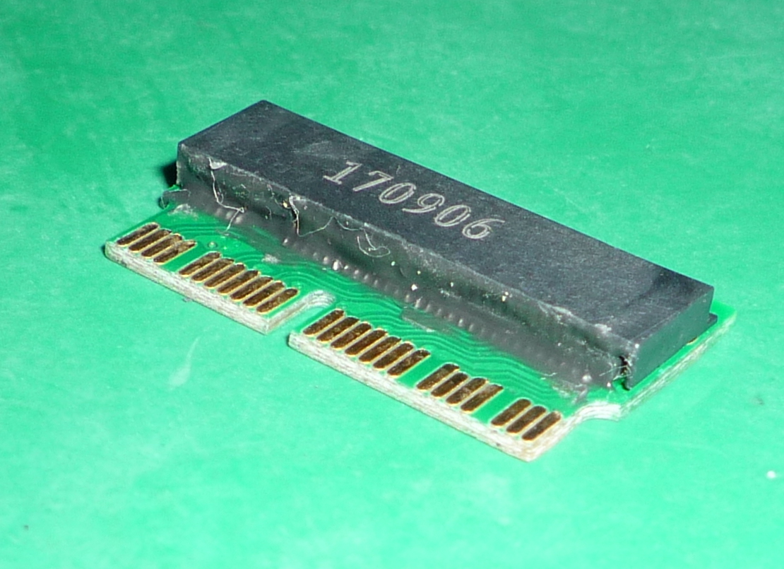

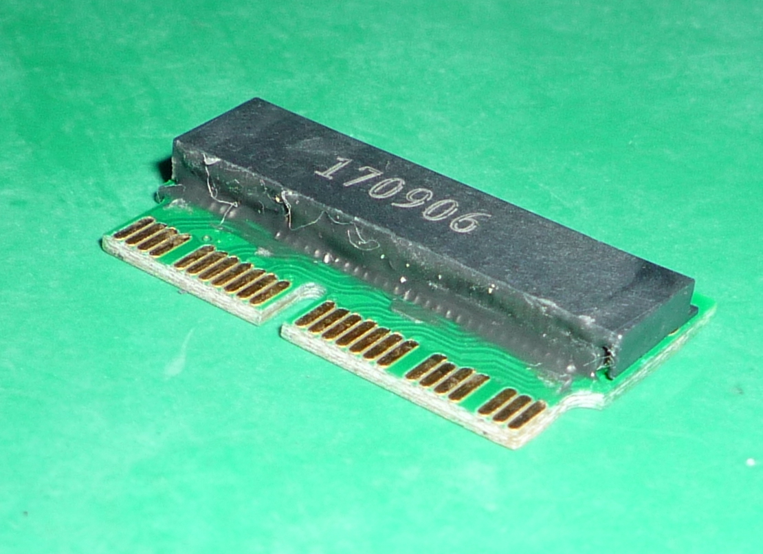

My adapter is protected by silicate resin over the pins near Mac's motherboard connector. No kernel panic is found.
My case:
MacBook Air 13 Mid2013 960 Evo 256GB re-boot NG sleep OK
MacBook Pro retina 13 Early2015 960 Evo 256GB re-boot OK sleep OK

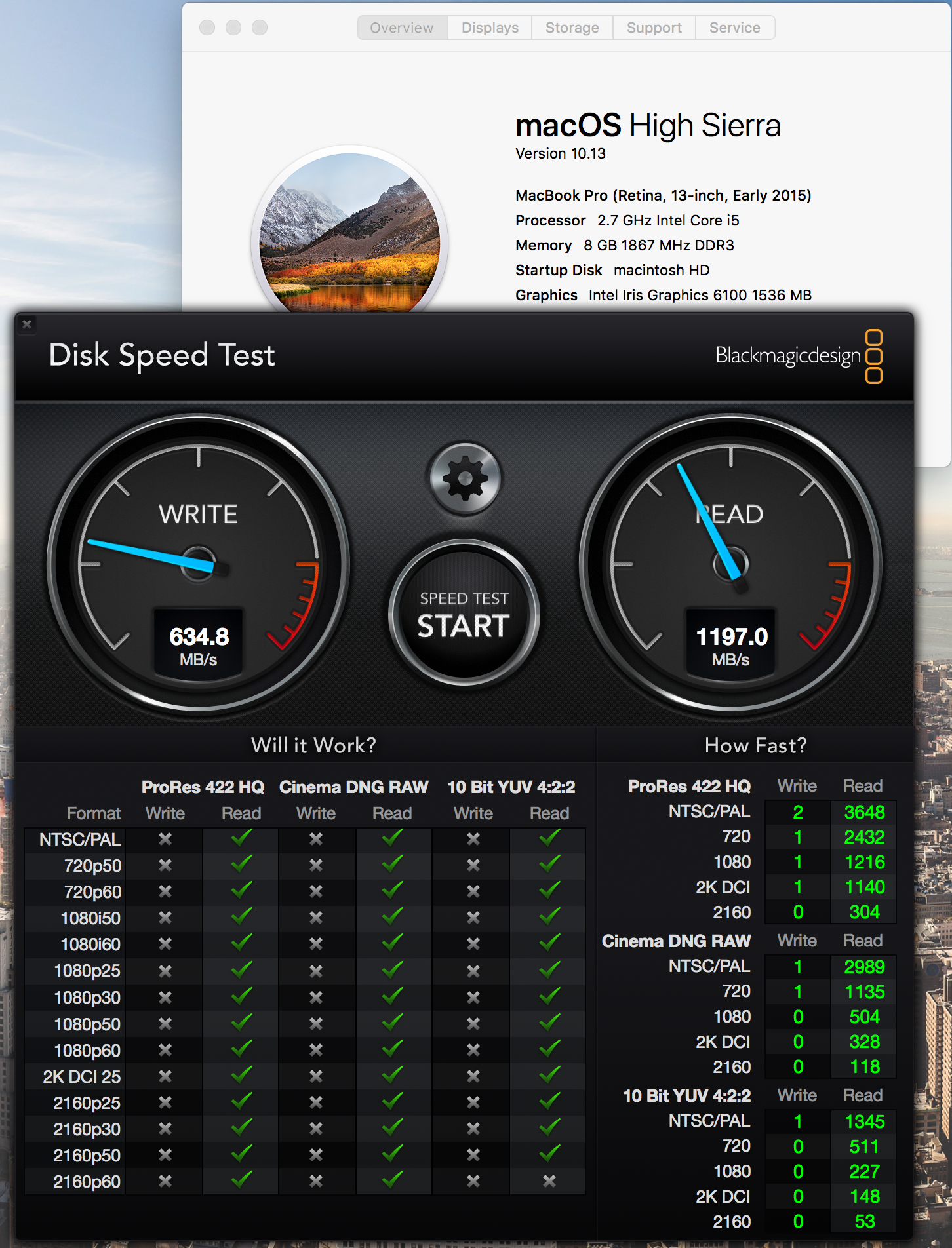

The write speed is better on small files, but on 5 GB test size it gives 2600MB/s read 750 MB/s write
well, thanks for your answer.. at least it's better than the original ssd from my mbpr 13" 2015.
and the important thing is i'm not stuck with this 128gb ssd 🙂.
here's my disk speed test from my original ssd from my mbpr 13" 2015 in high sierra (it's just for the comparison).
soon i'll post when my adapter is arrive with my new ssd 😀.

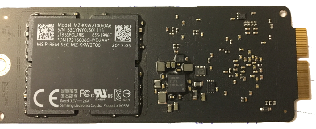

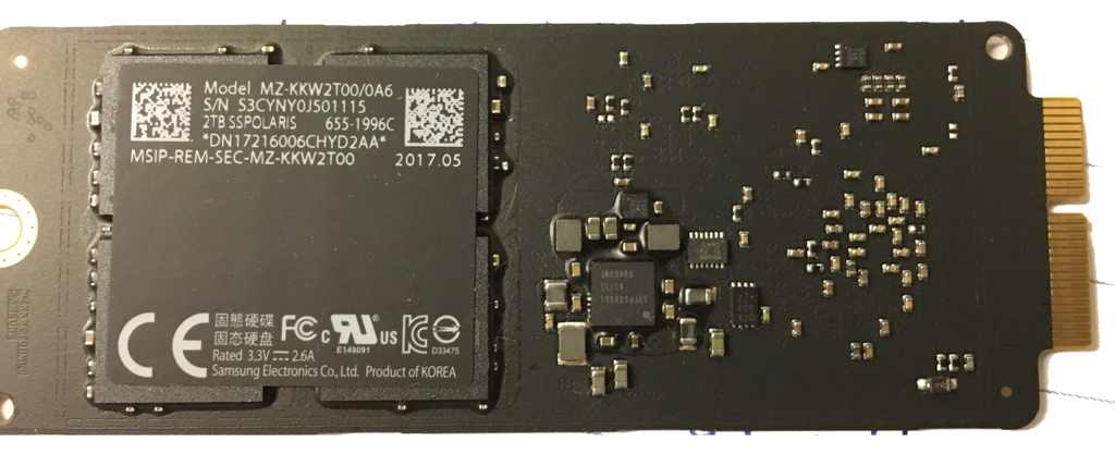

So I tried to put a genuine Apple NVMe SSD (SM2048L) in my 13", late 2013 rMBP, under El Capitan (10.11.6).
After this night sleeping on battery, it had exactly the same behaviour on wake up : it did not properly wake up from sleep. Display stayed black, and after a while (3s) the mac did chimie and made a cold start.
Sip was disabled yesterday evening before sleep, this setting has been lost at restart this morning.
The SSD being a genuine Apple SSD from a 2017 iMac, the issue here is definitely not with tiers SSD nor with the sintech adapter. It is with NVMe SSD (being it Apple or other brand), and maybe the SMC is involved...
Also, I did checked the console log and saw en error code which is quite common with 2013 MacBook air-MacBook Pro :
10/10/2017 07:55:07,000 kernel[0]: Sleep failure code 0x00000000 0x1f006c00

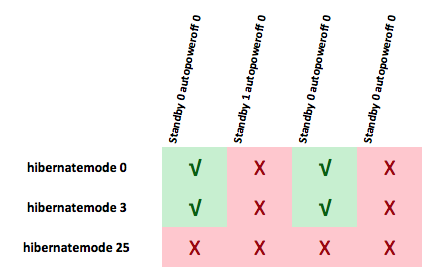

So I tried to test all combinations with smalls standby and autopoweroff delays.
Here are the results :
It seems clear that, in fact, true hibernation doesn't work on NVMe SSD (this is, again, with a genuine Apple SM2048L NVMe SSD).
So, unless other findings, solution would be to stay away from hibernatemode 25, and set "standby" to 0 with the command "sudo pmset -a standby 0"
