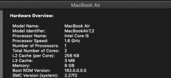

My late 2013 13", after updating to the 10.14.1 with the original Apple SSD, has a bootrom of 149.0.0.0.0.
Updated my early 2015 Air to 10.14.1 with the original Apple SSD and the bootrom was updated to 182.0.0.0.0.

I just upgraded from 10.14 to 10.14.1, early 2015 13" Air, Sintech green adapter, Intel 600p SSD, and the bottom was also updated to 182.0.0.0.0! This is the first time my Air did a bootrom update with a non-Apple oem SSD. I'm happy because it looks like I no longer need to install the original SSD to safely update the bootrom.

Macbook air early 2015 mojave 10.14.1 update installed with bootrom automatically updated to 182.00—- without the need of original apple ssd. I am using samsung 970evo 500gb ssd with latest, late october ordered, sintech adapter small one ( pins shielded originally from manufacturer)
