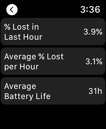

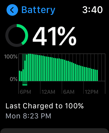

Best day for me since doing a fresh re-pair on 7.0.1.
7.5 hours of standby. 80% battery left. 2.7%/hr.
No 3rd party apps installed. All features enabled except sleep. Display brightness at lowest setting.
Battery Grapher shows accuracy as good. Everything still enabled with WaterMinder sending reminders and Watch Feeds sending me notifications when MR post a new article.
