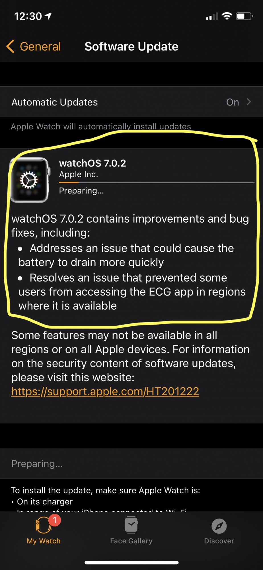

Hope this will resolve the battery drain issue.
Thanks for posting that - hadn't gone to look for it and you've saved me the time.
