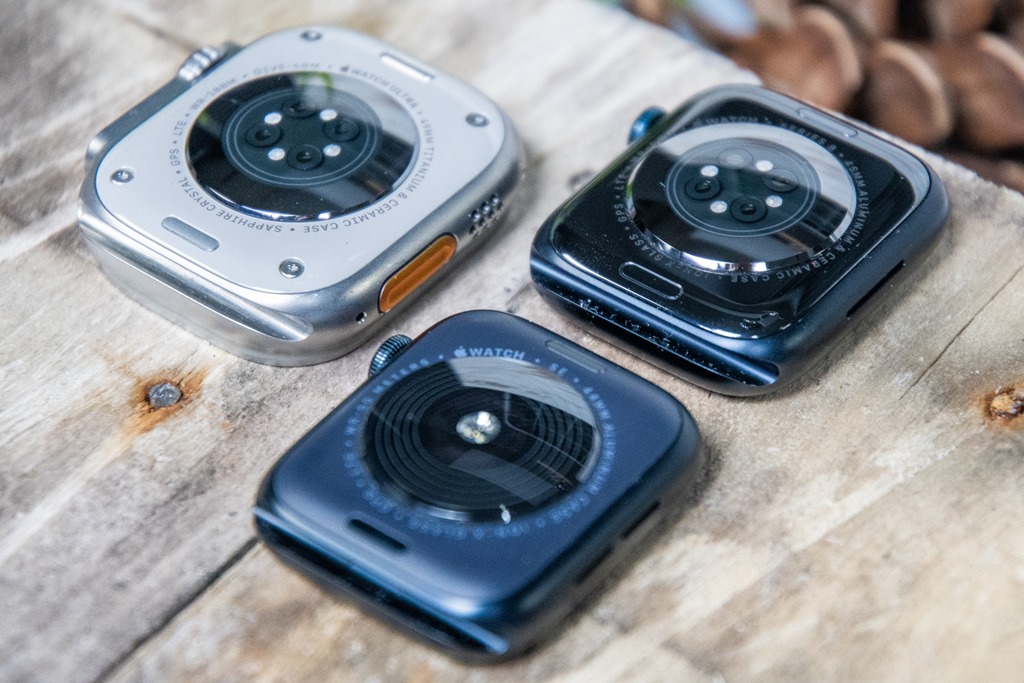

I think the guide indicates that if you bring your phone along with you for the run, it'll use that for GPS instead of the Watch. I think that's accurate for all Apple Watches except the Ultra, isn't it?
accurate for all 2022 Apple Watches: Ultra, S8, SE2
Really? At some point during the recent Apple Keynote address, I think it was indicated that the Ultra always uses its GPS for fitness tracking even if your phone is around. Presumably this is because the Ultra has dual-band GPS and therefore greater accuracy than any current iPhones?
Update: This isn't official documentation, but the OP of this thread also indicates that the Ultra always uses its GPS even if the iPhone is around: https://forums.macrumors.com/thread...n-if-you-bring-your-connected-iphone.2358832/
@NME42, I think we are both saying that the Apple Watch Ultra relies on its internal GPS even when the iPhone is around. Maybe there was some misunderstanding somewhere.
DC Rainmaker indicates this is true for the other 2022 models:
For all the new 2022 year watches, including the Apple Watch Ultra, Apple Watch Series 8, and Apple Watch SE 2nd Gen, Apple has changed how it does GPS lock. Specifically, it no longer depends on the phone like it used to (if the phone was within range). Now, it’s entirely self-standing in all scenarios.
Source: https://www.dcrainmaker.com/2022/09/apple-watch-ultra-in-depth-review-its-a-start.html
@msackey : seems Apple has read this thread and posted a clarification. DC Rainmaker wrote an article about the GPS iPhone topic:
