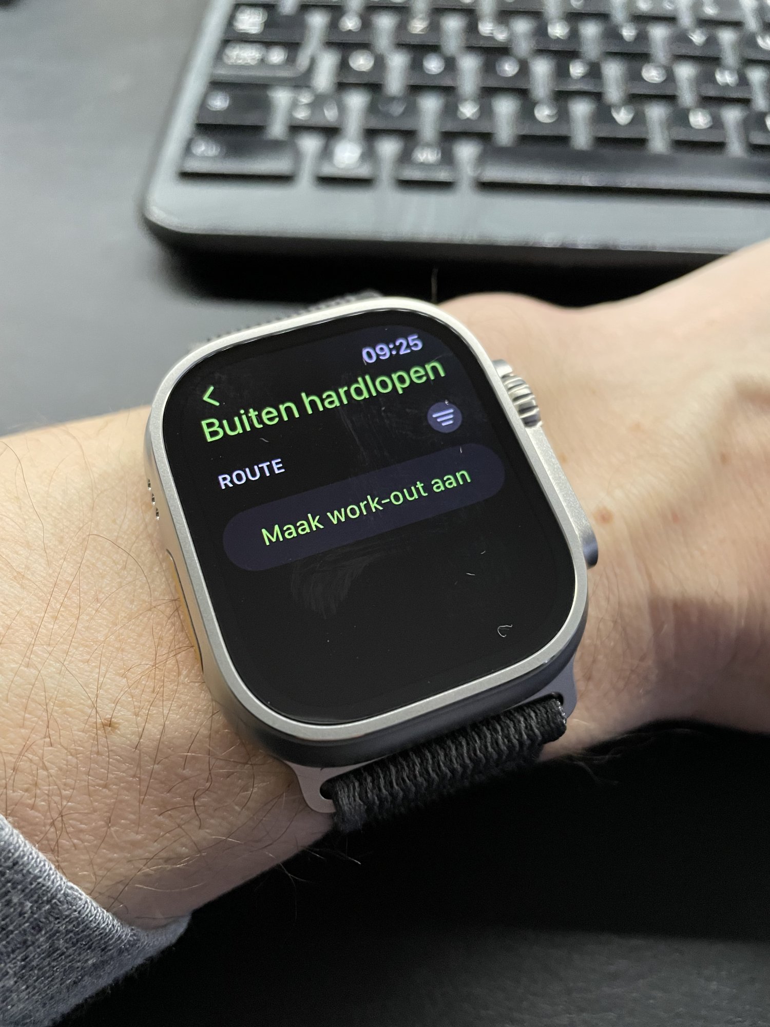

Re. the ‘race route’ feature. I live in Belgium and I suppose that it should work for me (unlike the track feature this is not limited to US, am I right?)
Now I have been trying since the moment I upgraded to WatchOS 9.2 (a good two weeks ago) and now have at least two 10k routes that should in principle appear in the race route list, because I did the exact same route at least twice, using whe native app (I also use WorkOutdoors every now and then but to be sure I wasn’t doing anything wrong, I made sure to only consider the runs done with the native app).
The issue is, my race route list remains empty and I have NO clue as to what I could be doing wrong. Anyone experiencing the same issue? I read on other forums that the detection of routes is buggy and unpredictable. Any thoughts on what to try next?

yes, the route starts at home... If you mean by filter setting, the "three horizontal lines" next to "suggested" followed by "route" to view the list of routes available, then yes, that list is empty.
yes, the route starts at home... Not sure what you mean by filter setting?
When opening „Outdoor Running“ with … you see a filter icon in the upper right corner. There you can select race routes. As in the standard view there are max two routes. But guess it will show nothing for you either. But try.

thanks - I just edited the orig post and the filtered list is indeed empty (see also picture I added).
