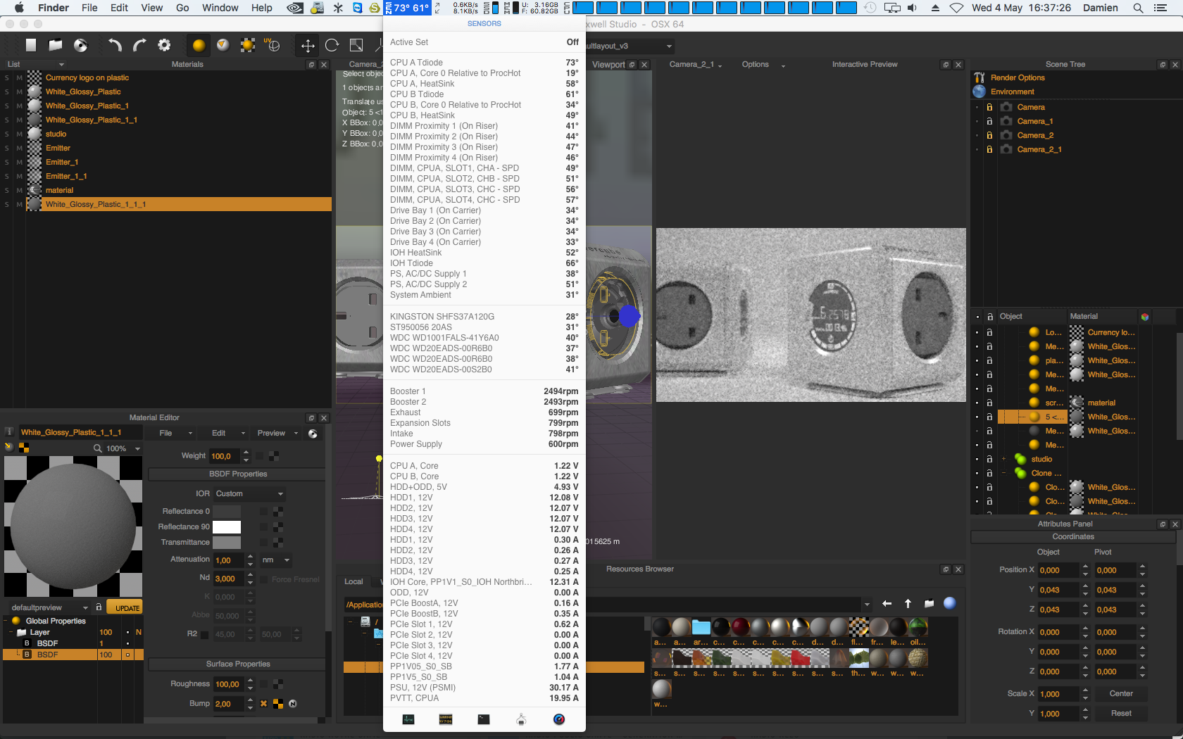

Well I got news for you!
This is the view you read about,...however...I recently discovered a bigger problem with many Northbridge modules.
A 'newly' made 12 core 3.46 kept crashing after ±10minutes of rendering.
After trying several options I wanted to tackle the NB, despite that the temperature of the NB never got over 70C...and what do you think? Right, no more crashes!
The thermal paste was baked liked cement and didn't have any function, the rivets where OK (I changed them anyway).
The second 12core I made for the same guy, crashed exactly like the first one!
Applied the fix there and voila no more crashes.
Also this heatsink was loose on top of the NB.

I know this is new to most.
What MVC says doesn't mean anything,...as I stated with these 12-cores I found out for the first time the NB made all the difference. Its just that most will never push the MP to its limits, I know I never did!
I know for 100% the thermal paste was what made the difference!
If the NB heatsink is loose, and the thermal paste is totally dried. I don't think the temperature can maintain below 70C.
Well, think again, I know I found something new. Here's the iStatMenus, just before the crash(es).
BTW, Cinema 4D was used, rendering 100% on the CPU's.

The screenshot was taken ±2 minutes before the crash,...all is the same...but the CPU A can reach 76c now, without the Mac crashing.

Anyway, it's not about how many systems you've upgraded. But how much you study and know about the system / terms, etc. I only own one Mac Pro and only upgrade my own Mac Pro, but I know the X5690 won't shutdown when T-diode reach 78C, and can easily run stably at 80C (proved by the above post).
P.S. I am not trying to argue with you, or I want to win. But I want to find out / let the others know the truth via debate.
When discussing temps of these Mac Pros, it's important to include ambient temp because it makes a huge difference.
